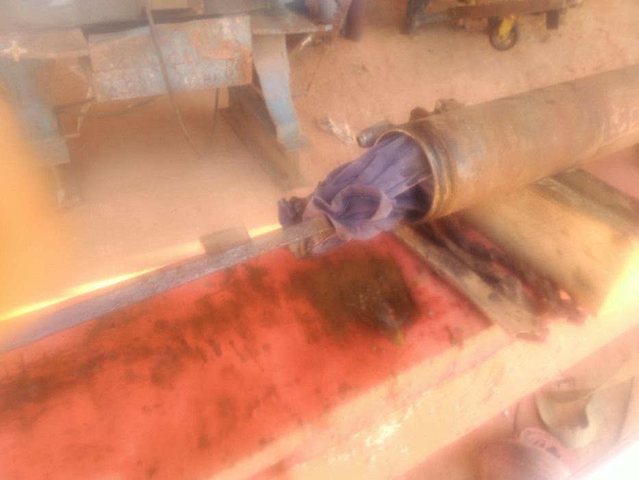

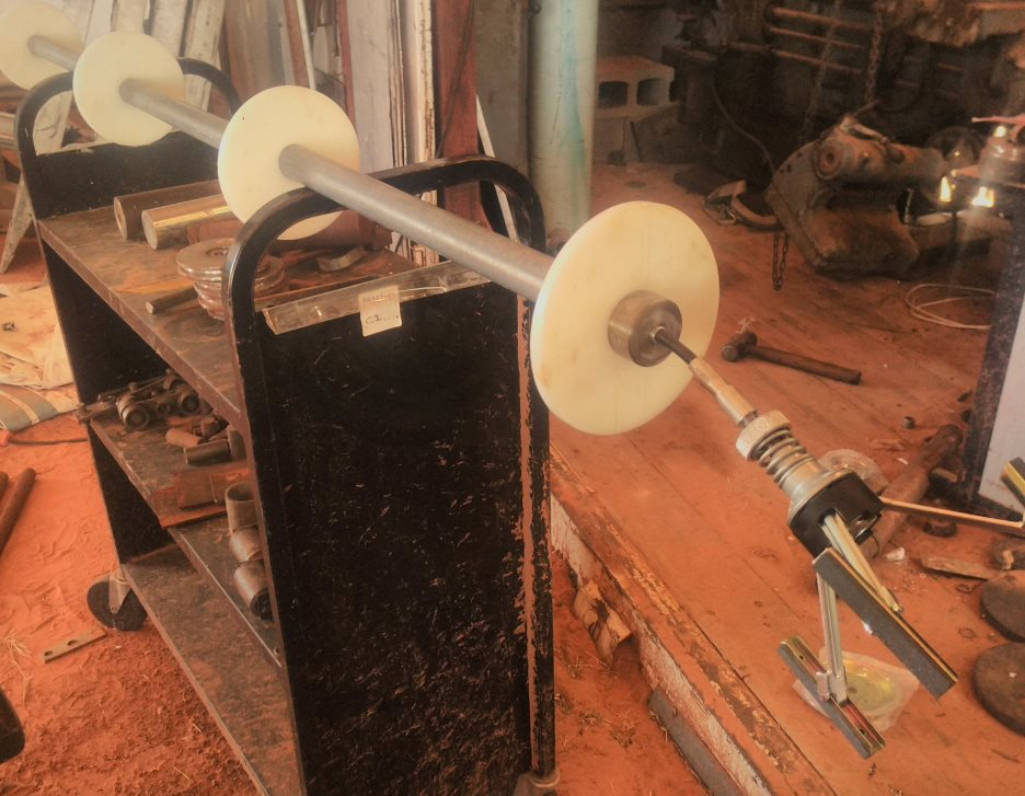

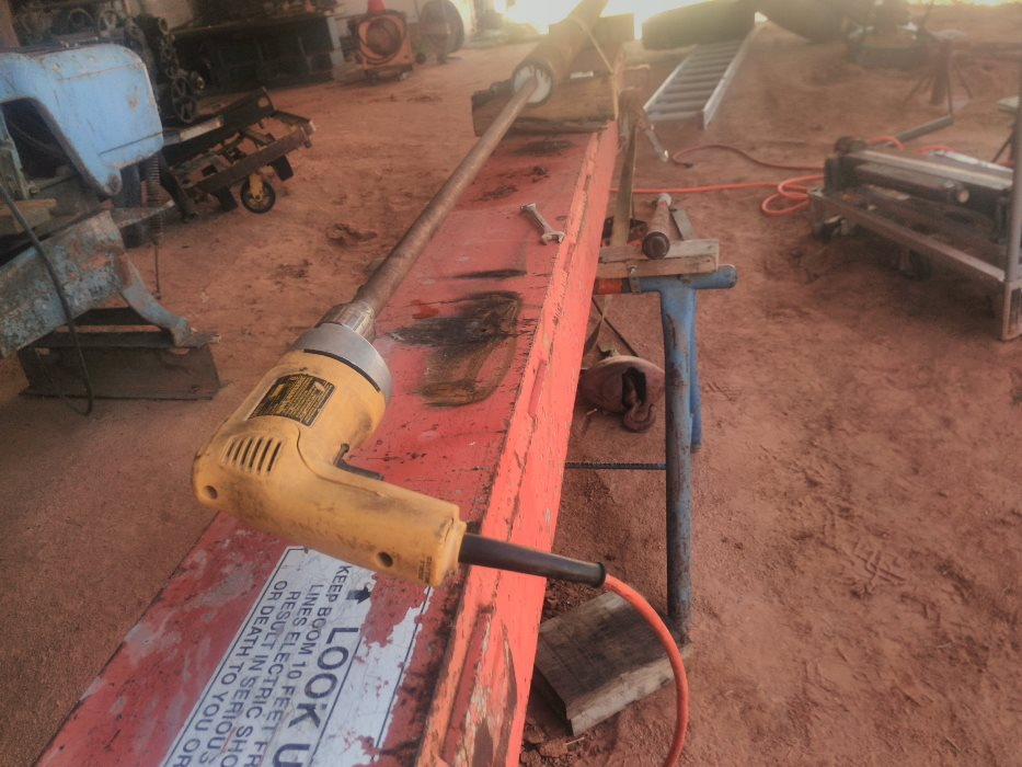

Starting out I needed to clean out the bores of the cylinders and make sure there was no surface rust so I made a 10ft long extension for a 3 stone hone I would have preferred a beaded hone for this but couldn't justify buying 2 different sizes for the job one of which would have cost $50.00 Since I already owned a Lysle 2 to 7" 3 stone with new stones it was a no brainer. To stabilize and center the long shaft in the bore I made several disk out of 1/2" thick nylon Then swabbed the cylinders several times to get all of the honing oil and any debris out of them

Nice job with the hone -- I think? I'm not familiar with what you're doing. I'm sure your resourcefullness will be successful.
