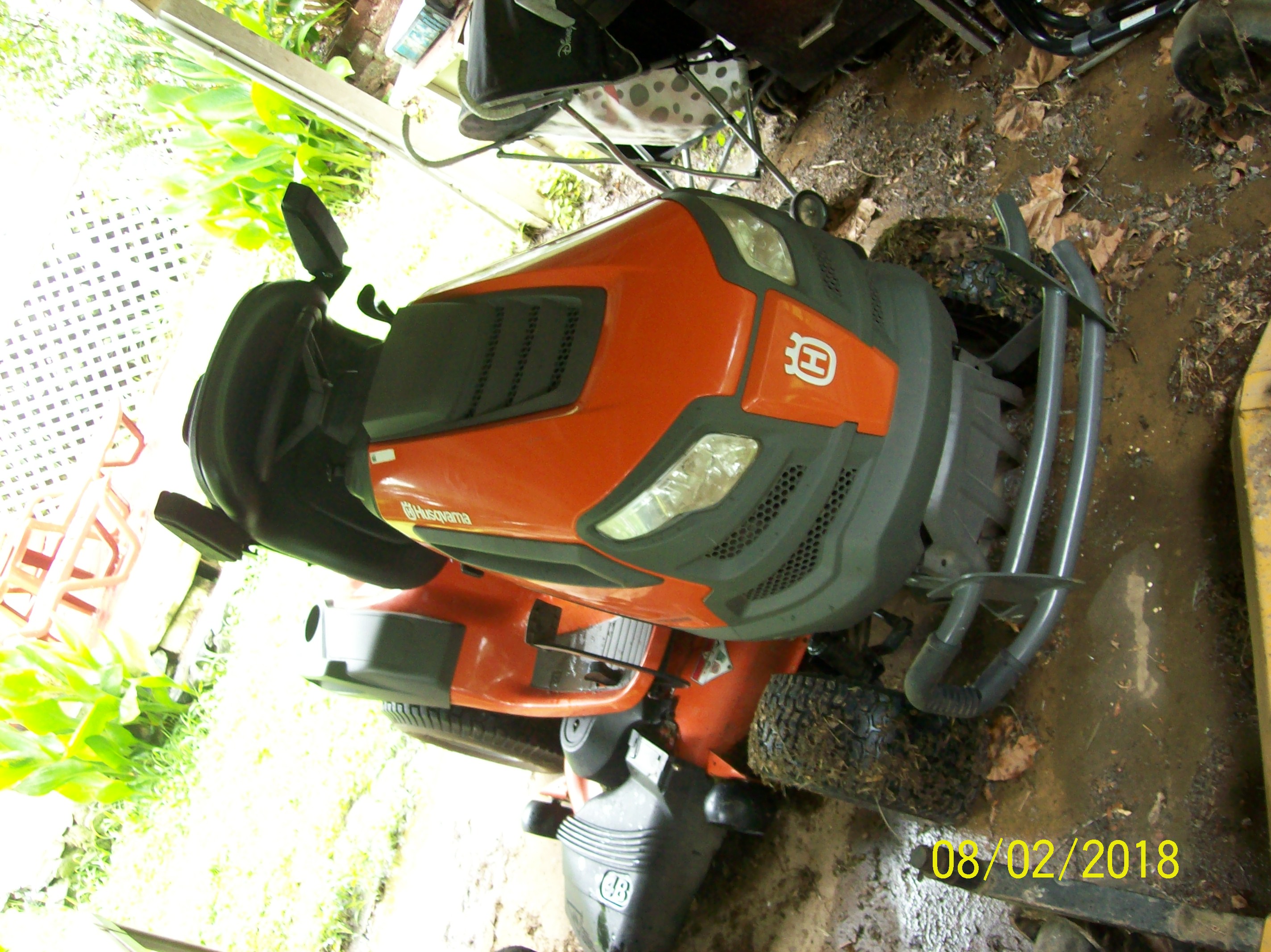

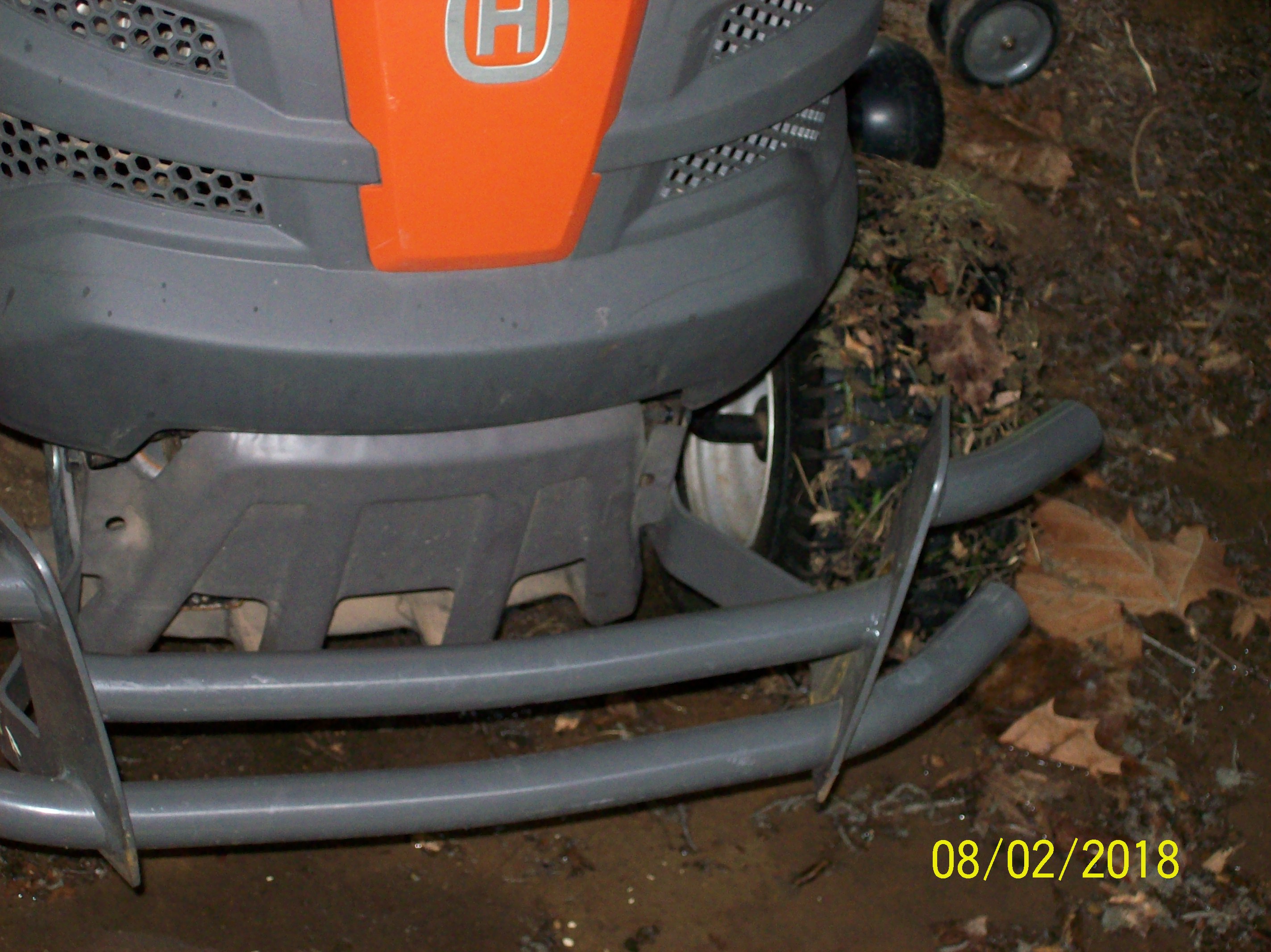

Just to show what I'm talking about. The front on the mower with the missing cap when it was returned after repairs. Such a minor item, but I bought the bumper extra for the mower, as it did not come on the mower when we bought it. The cap should not be very expensive for them to replace, or so difficult for the repair shop to step up and admit they somehow lost it.
