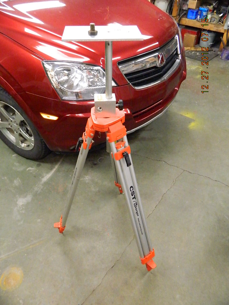

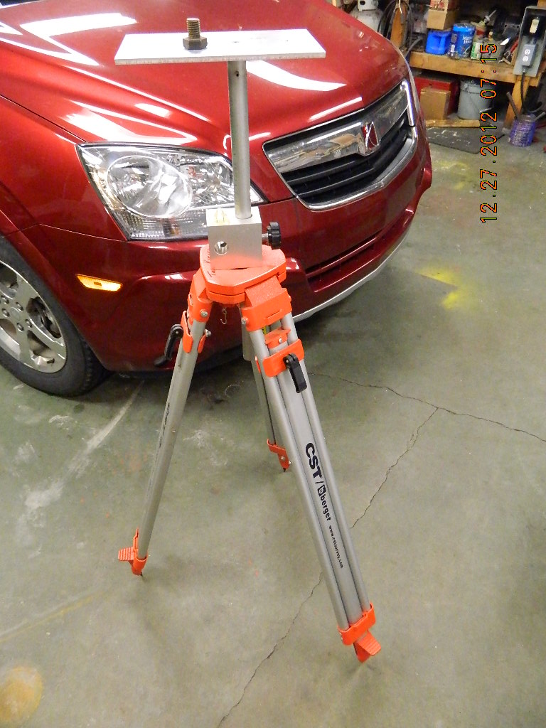

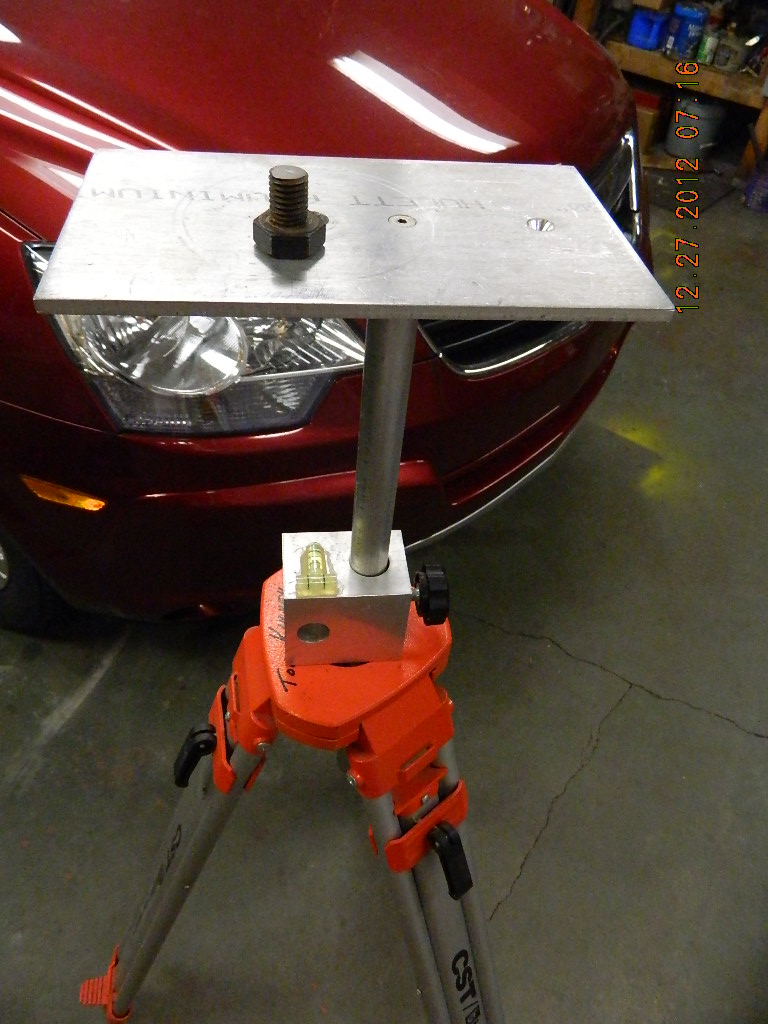

I made a quick adjustment elevation adapter for my tri-pod.
It is nice for trim work and cabinets when you don't want to use a story pole and just the detector for layout.
bolts on to the tri-pod and bolt laser to the top aluminum plate.

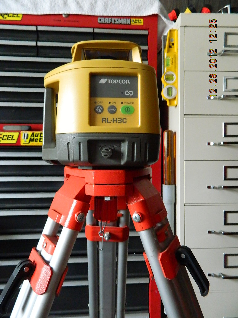

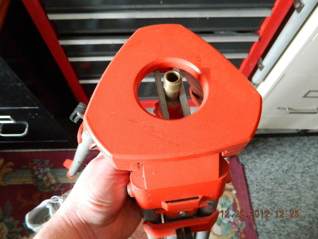

Big Dooley, thanks for info. I see that your tripod is CST but I can't see clear the plate head where the laser is attaching and I'm looking to buy one the same plus also a RL-H4C model. Can you confirm that your RL-H3C model can be mounted directly on the tripod without any adapter or I need one? The picture and description on amazon doesn't say anything.
Thx.

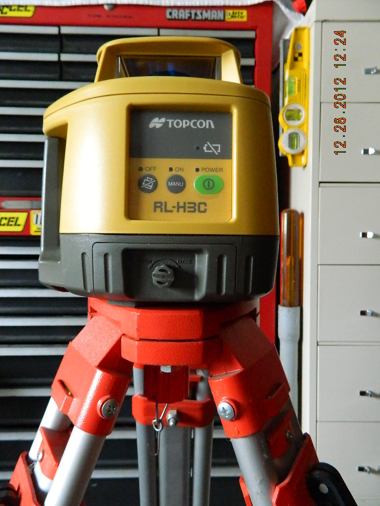

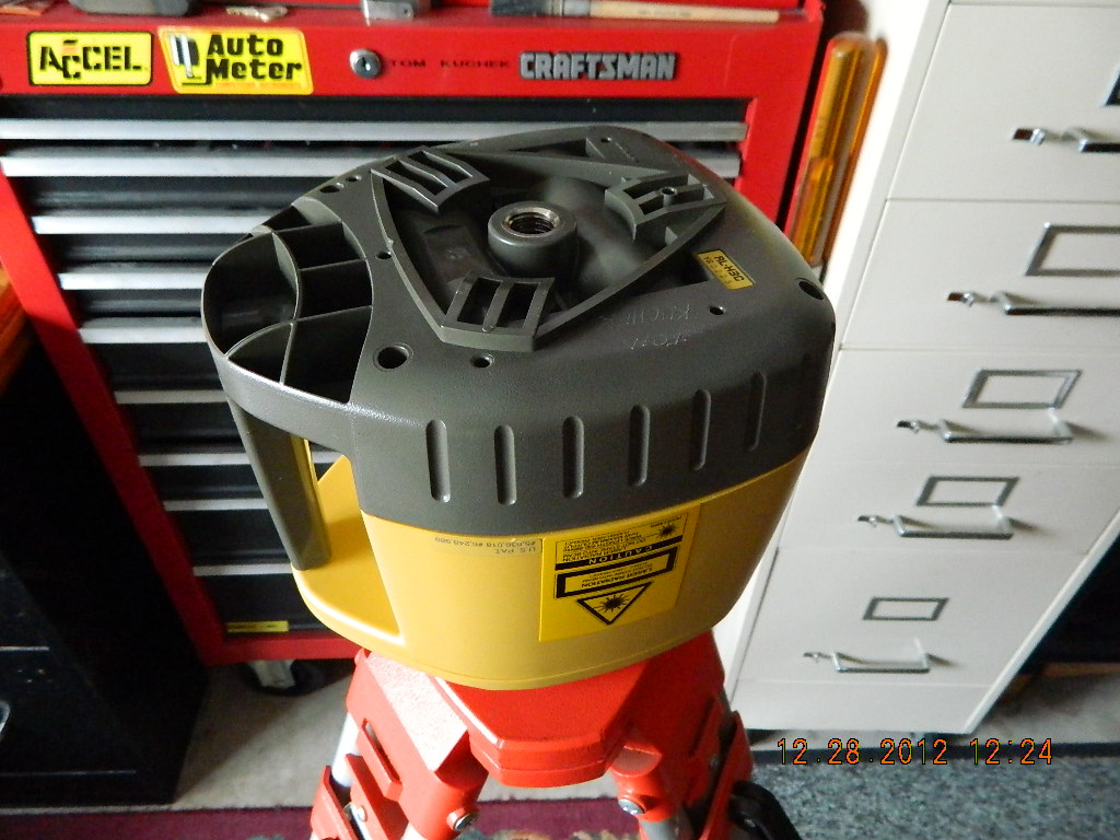

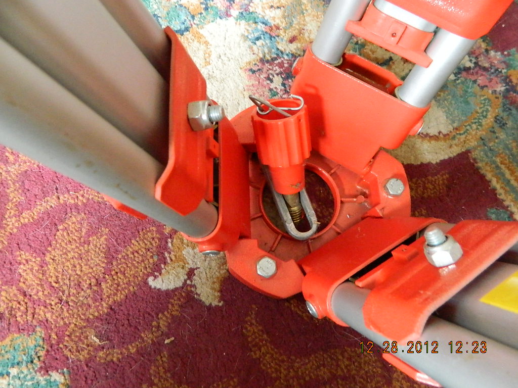

My RL-H3C requires no adapter to the CST stand.
I believe the tripod thread is 5/8-11.
Here are some pics.
Just looked up the RL-H4C.
They have made some nice improvements over the years.
You should be very happy with that choice.
