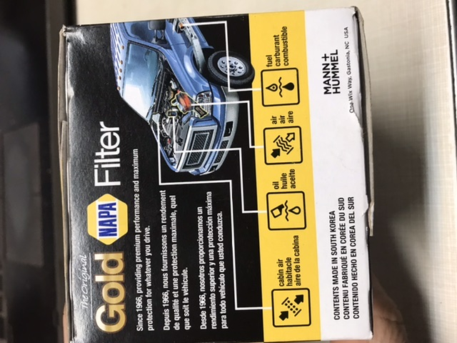

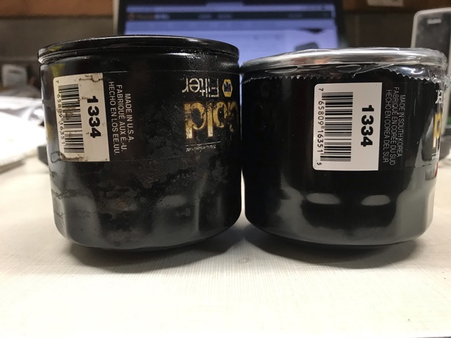

Anyone notice that Napa Gold oil filter 1334 oil filter has changed recently? Maybe a new supplier? I have not cut open a new style filter yet. For starters the box is sealed different. The box states "contents made in South Korea." The "old style" Napa gold states "Made in USA". The new filter sealing gasket is different and has 6 holes on top while the USA made old style has 8 holes on top. The new filter has a sealed plastic top while the old style did not come with that. The old-style filter is slightly longer as well.

Iirc, a 1064 had less holes and was taller compared to a 1334 just like your pic shows.
Maybe wix 'consolidating' filters??
Both work on the 790 and the Hyundai Santa fe we use to own...
   / Napa Gold 1334 oil filters have changed.... #3
A parts store rep told me Wix has been purchased by Mann filters.
Mann stuff always looked top-notch.
   / Napa Gold 1334 oil filters have changed.... #4
If I recall Correctly, Mann is just a "Lable", They don't make all that they sell.
I was sad when finding out that the NAPA Gold were no longer WIX.
