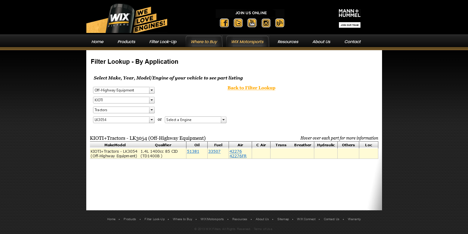

Lman, You missed “OEM hydraulic filter” …
   / Napa Gold 1334 oil filters have changed.... #33
Exactly how folks get in trouble with aftermarket filters. Are you attempting to show Oaktree where he can get a Wix hydraulic filter for his Kioti? Or are you showing that Wix has no hydraulic filter to fit it?
Wow. Nice catch. I've noticed that lately a lot of hydraulic and engine filters are in similar canisters and use the same mounting system. That makes it even easier to make that mistake.
