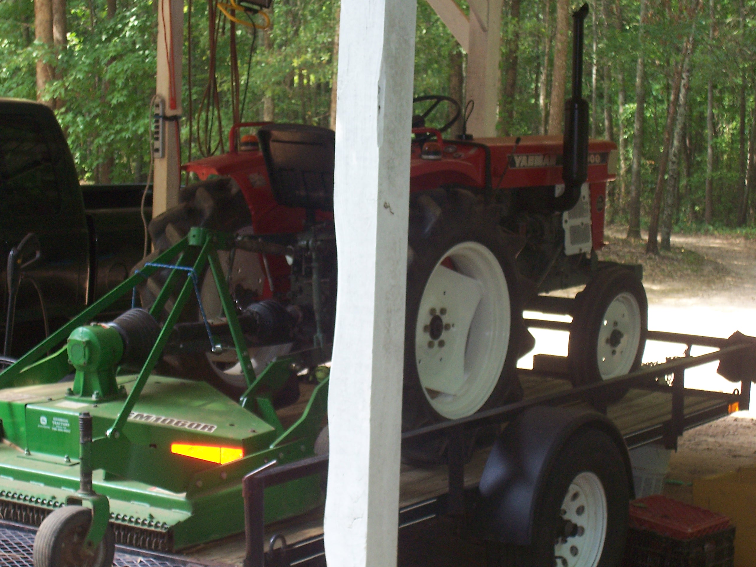

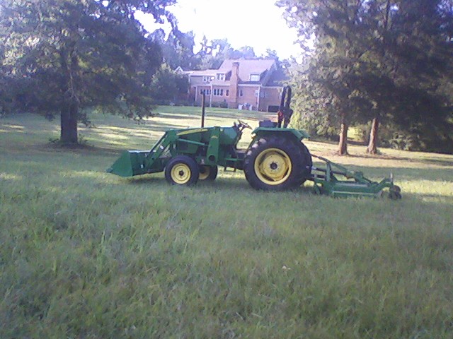

I'll be getting the JD. out this weekend. Grading and BB. a Gravel Dr. It's 55hp. with a FEL. I've used it for over 8yrs. 0n 35 acres and with that being said I know how well a FEL. works on it. And still to the day I won't even consider a FEL. on my Ym2000. It's basically the same as the 2210 just 2 eng. hp. Less. That's probably not even noticeable unless your working it to it's Max. Capability's. And Still Doubtful esp. if it has the P.shift Trans. It's not designed for a FEL. 4wd. or 2wd. IMO. It's comical to see the way there built. Just in the Front End. And a lot of reasons that people prefer the 4wd on the Yanmar's isn't just for Traction it's how the Front End is built. Your see! The JD. is only 2wd. also In Ga. I've never needed 4wd. or even gotten it stuck for that matter. I'm Orig from WV. lived in OH. and MD. In VA. and the Winter snow the 4Wd. is a big plus and almost a necessity. But the Ym2000 really shines with the 5.FM, 4.BH. and a Tiller that I really enjoy using it. P steering on the JD a must. I lost over 40 per. of my R arm. so a lot of movement is difficult. so again if your using Fel. P. steerings a big plus. :2cents:
