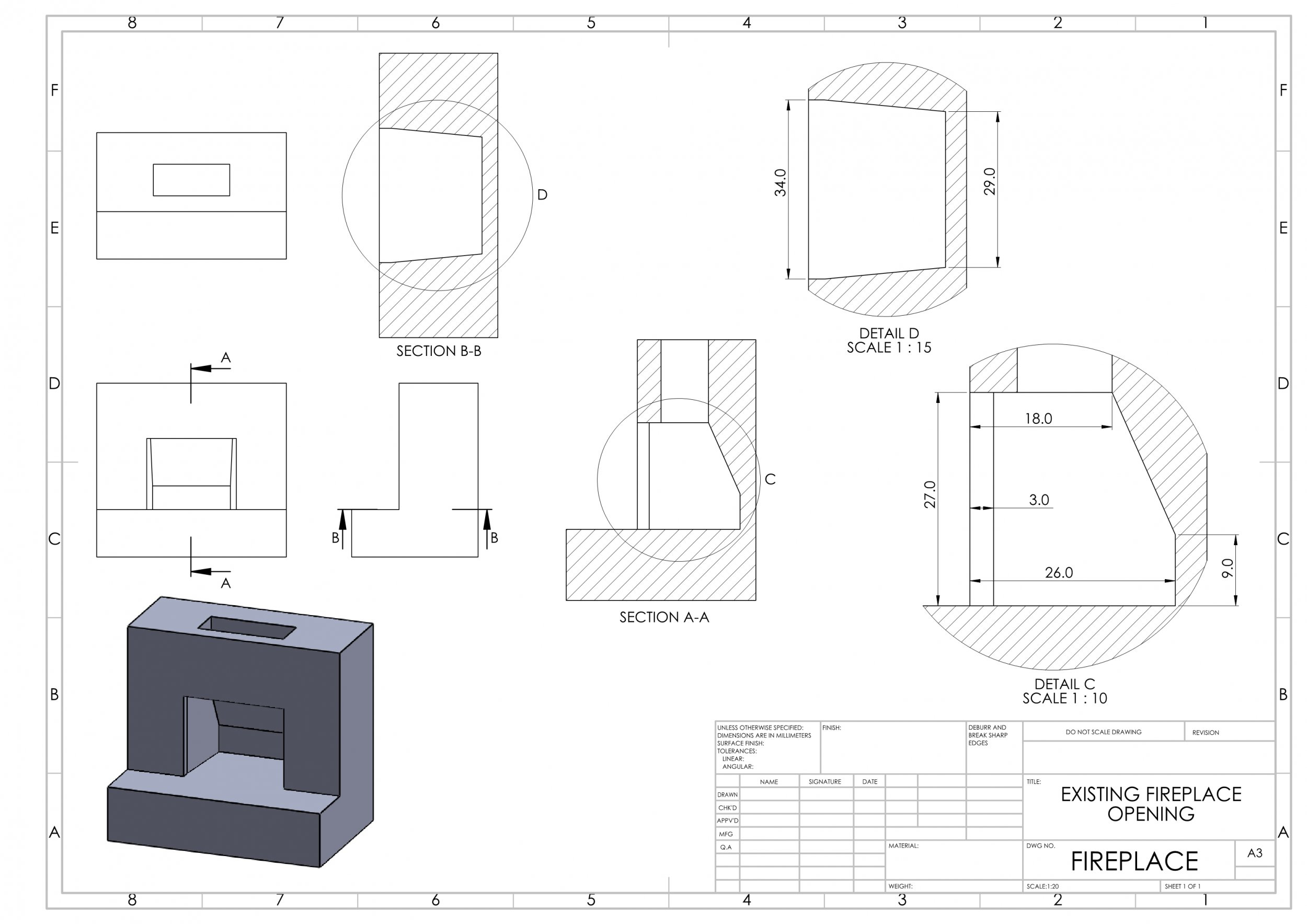

A year later and I am looking at this again. I took some good measurements and created a sketch of the opening which I have attached. To summarize, I have an existing open natural gas burning fireplace and am looking at options for installing a direct vent insert with a fan.
I visited one local company that has a showroom and installs all different kinds of inserts. They did not offer/carry anything small enough to fit in my opening and were not interested in helping me find one.
Some online research leads me to believe that the following should fit:
  • Kingsman IDV33
  • Superior DRI3030TEN
  • Regency E33, HRI3E, and LRI3E
I am sure there are many others as these were just the first ones I found.
Does anyone have any feedback about the three brands listed above? Experience with those specific models would be even better. I am also open to other brands or models if they will fit in my opening which is apparently smaller than normal?

In 1999 we built a new home with two gas fire places. One was vented, one was unvented.
The vented gas fire place gave off very little heat.
In 2001-2, we heated the entire house with the unvented gas fireplace. It cut our heating bill 80% from the previous year.
YMMV
Ken
