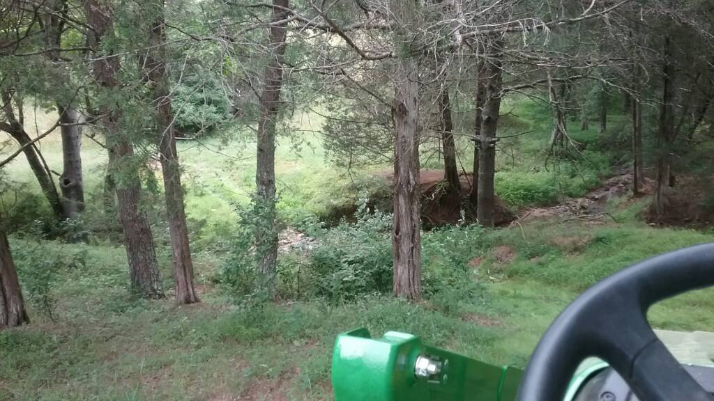

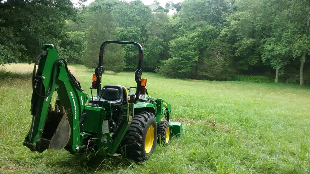

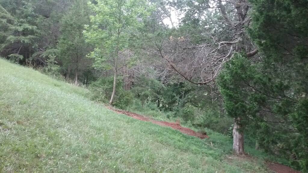

I just dug up two stumps, cleared some and this nearly tipped post is what I was thinking about. The JD I bought new last Fall with lots of attachments, I'm 100% happy with it (117 hours now), but even the dealer mentioned "feel", regarding tipping. We don't drink...but just like Einthewoods said I keep a whiskey bottle (no...not under the seat )but in garage for those "times". It can happen so fast, and sometimes it's just a really creepy feeling.
My $64 question is how do you really know? Few pictures show where I cross a creek, where I dug up one stump, where I'm starting a woods road. I just beat the storm...it's raining buckets.
Thanks for any "tips!"
   / Nearly tipped today #29
Sorry...forgot pictures... 20180622_142256.jpeg20180622_143226.jpeg20180622_143239.jpeg

I hear people talk about "feel" and "pucker factor" a lot when it comes to slopes.
I think it's bunk.
While some people may be good at it, it's very subjective.
If you're on top of a treeless hill that's 400 feet above it's surroundings, it "feels" a lot "tippy-er" than a identical slope when in a narrow ditch with an opposite bank that you can almost reach out and touch.
Or if the surrounding trees slant in a way that exaggerates, or subtracts from, the "feeling".
Or if the tractor has a high seat but low fenders it "feels" tippy-er than if you're snug down in a low seat with high fenders.
There have been times when I've gotten on a new side hill and chickened out because of my "feelings". Get off the tractor, step back, convince myself that the tractor is capable of handling it way more than I am, then chicken out again. The next time I mowed it, it "felt" marginal, but okay, the third time it seems routine, no worries. Like working at heights, acclimatization (getting use to it) plays a huge part in "feelings". But play NO part in the actual physics.
It's physics!!
Feelings are for girls! :D :stirthepot:
