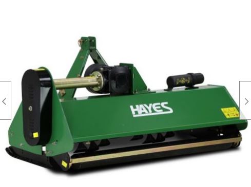

IF you do decide on a Flail, check out the Hayes line. I have been very happy with mine. Hayes are down in Vic. Mine was about $1800 at the time.

Have a few Hayes implements, they are good but pity about the colour:D
Nifty! Is yours with knives or hammers?
