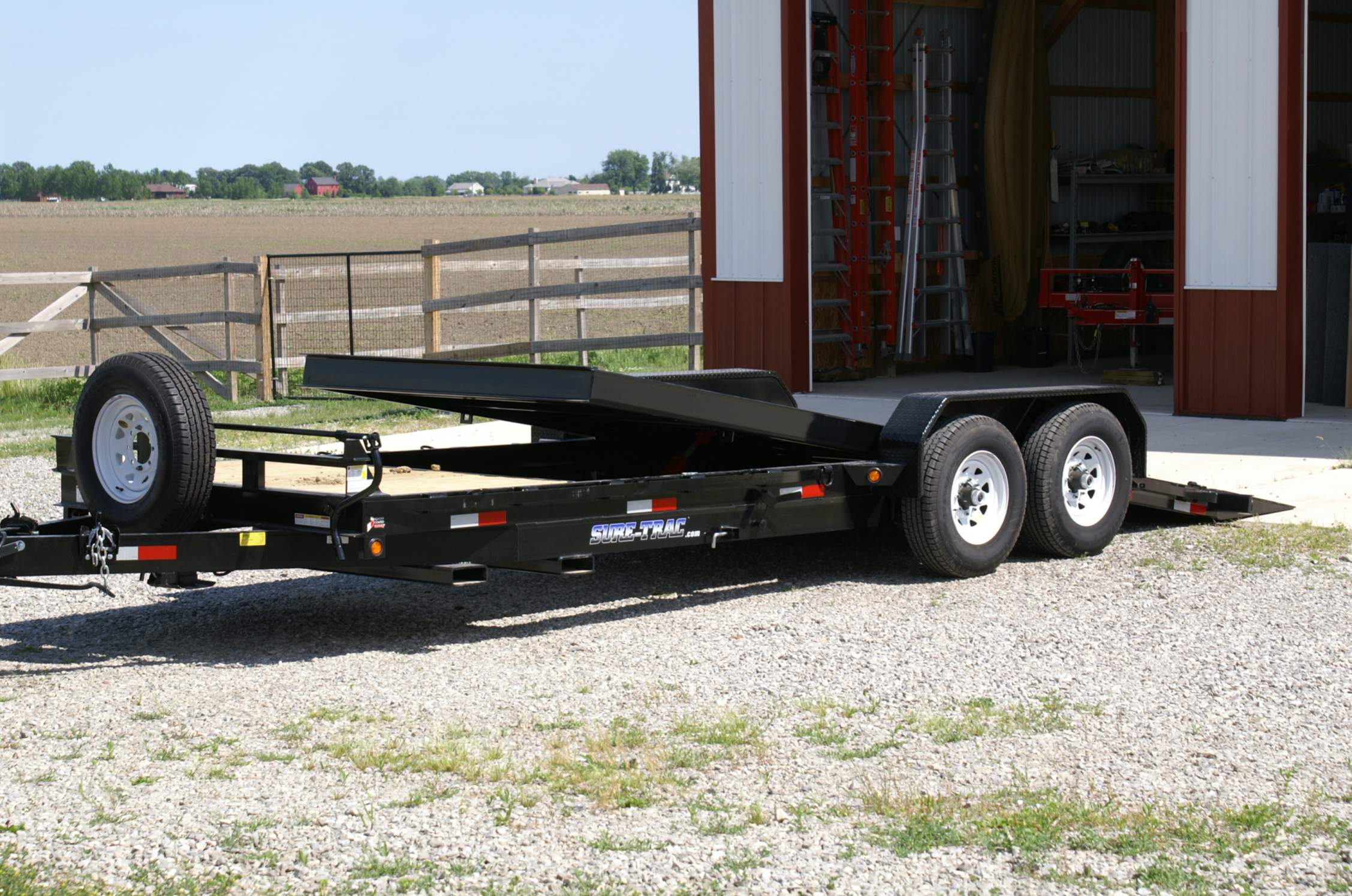

I love my tilt deck, but it is heavy. It's a 22' 14K (18' tilt 4' fixed) Sure-Trac and weighs in at 3700 lbs. It is built like a tank and pulls great, plus with my bad back I don't miss the ramps.
Sure Trac Home
