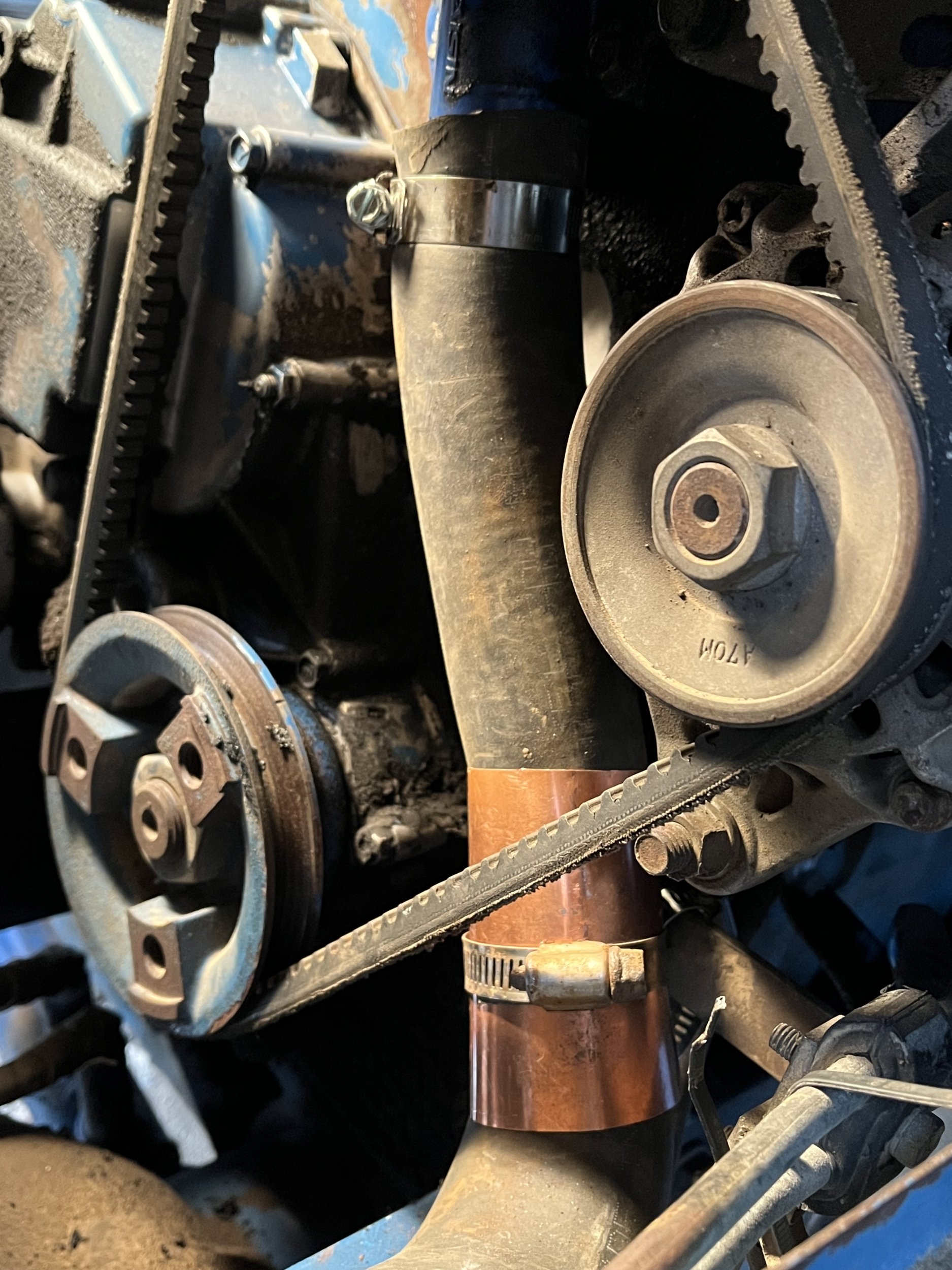

I got some similar hoses but not exactly matching, at the local auto parts store. The only issue was that the lower hose interfered with the fan belt so I made an arrangement with band clamps to hold it back and a small sheet of copper to protect it should the hold back fail or loosen.
/ Need 2120 radiator hoses, are 1920 hoses compatible ? #7
That looks good and workable. Certainly it is not a beauty contest. From this angle I can't tell but if the hose slightly rub against the pulley then you can make some sort of sling (same as copper band you used) and pull the sling slightly away with a tie wrap attached to something permanent. Good and acceptable workaround.
