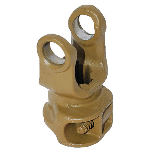

In addition to the obivious......cleaning/lubricating the metal pto shaft (tractor to implement) and pto spline at the tractor, here is what I did that make a world of difference in ease of hookup:
1. Replaced the twist turn or pull to release yoke to that of the older push pin style.....cost very reasonable pto yoke.jpg
2. With a black paint pen.....marked the location of each spline on the outside of the new yoke, to help with the alignment to the pto spline
3. Cut the excess overlap of the plastic shield, as I was encountering a lot of friction there, even after cleaning everything
These changes removed 80% of the effort in hooking up my brushhog.......hope it helps you as well.

It looks too simple for me. I don't see any provision for shaft overrun. It looks like a hands-free disconnect under field conditions.
My thoughts exactly. Seems like it would come apart too easily, and probably when you dont want it to.

I guess i'm leaning towards replacing the PTO connector with the reliable old school pin release. Always worked as it should.
For now I will continue slapping it in place with a prybar.
