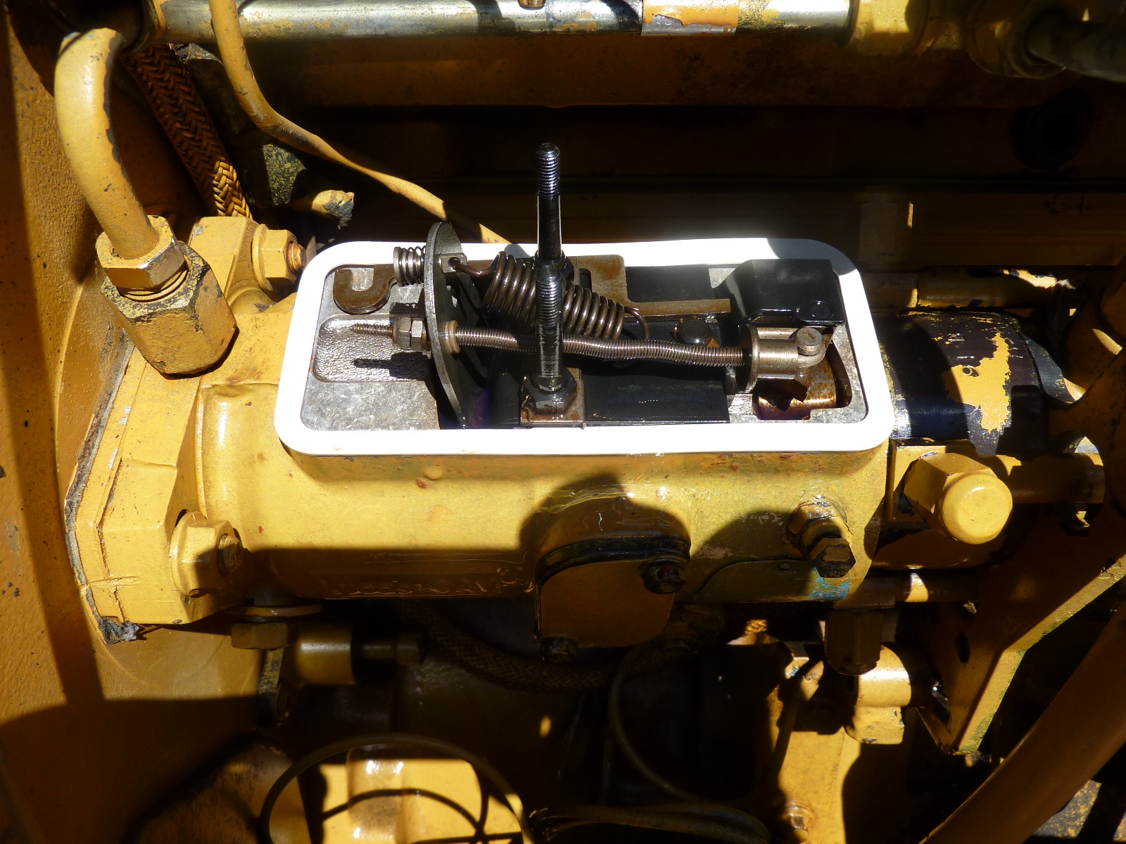

Need to rebuild a leaking throttle and cut-off. Suggestions where to look for CVA fuel pump rebuild kits. Thanks in advance.
That would be a CAV pump.
All you need is a cover gasket and 4 of a single part number of o-ring. As a New Holland dealership parts manager, I stock those two part numbers, and IIRC what you need would sell at or near $10, maybe less.

Messicks prices are as follows:
Gasket PN is 381771R1 $9.93
o-ring PN 49886 @ $.63 ea.
Before you remove cover completely take note where spring is attached on both ends. I think I've read that there are u-tube video's on the internet on replacing the o-rings

I did that same job in my dozer - not bad at all. Look at these
https://www.youtube.com/watch?v=AYz0dCQNiVc
http://www.tractorbynet.com/forums/massey-ferguson-classic-vintage/258591-mf-165-knocking-9.html
This is my dozer
The hardest part for me was getting the cutoff lined up with that shepherds hook you can see on the back left. Took me 3 tries. Just don't tighten the nuts to much until you know it is in.

Thank you very much. Great pictures showing procedure! Very much appreciated!
