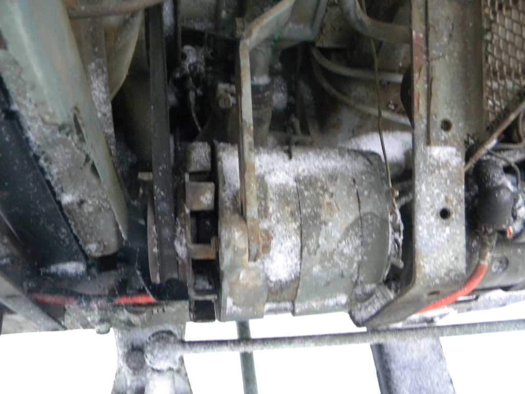

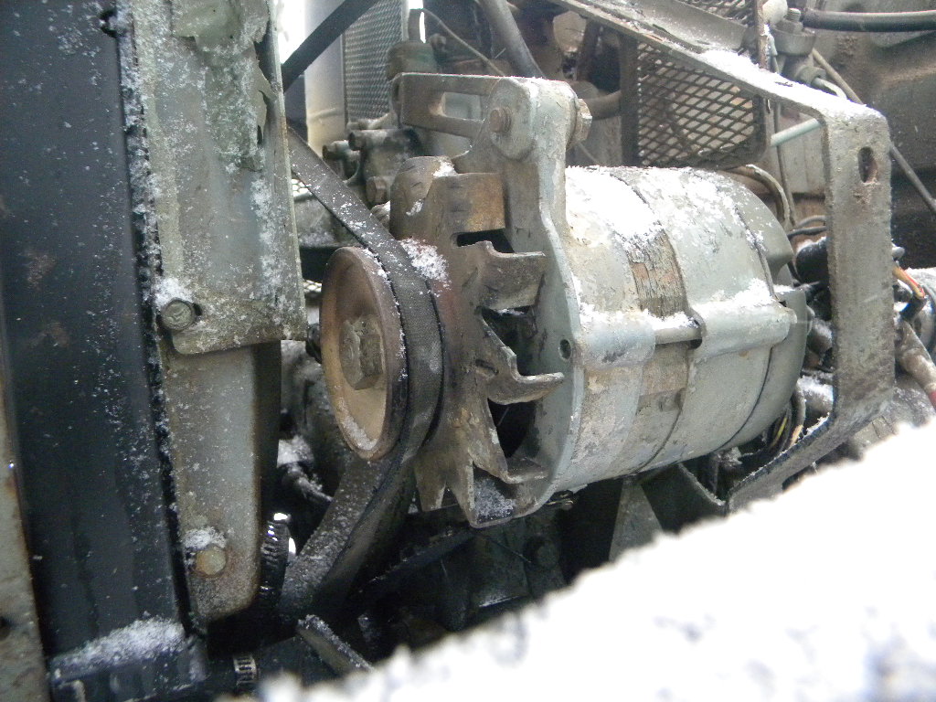

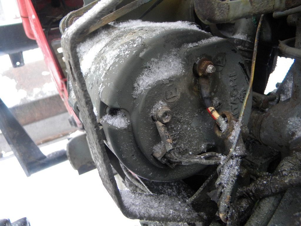

Fwiw this is The best I can do on a pic. of my Ym2000 Alt.
Carey
Thanks for taking the photo. I see yours also has 4 wires but with 2 of them in a plug. I must have a really old style as it doesn't have the plug I've heard others talk about. Maybe the Datsun alternator has two spade connectors in the back and I just didn't see it in the web photo. Your color code seems to be the same as mine.

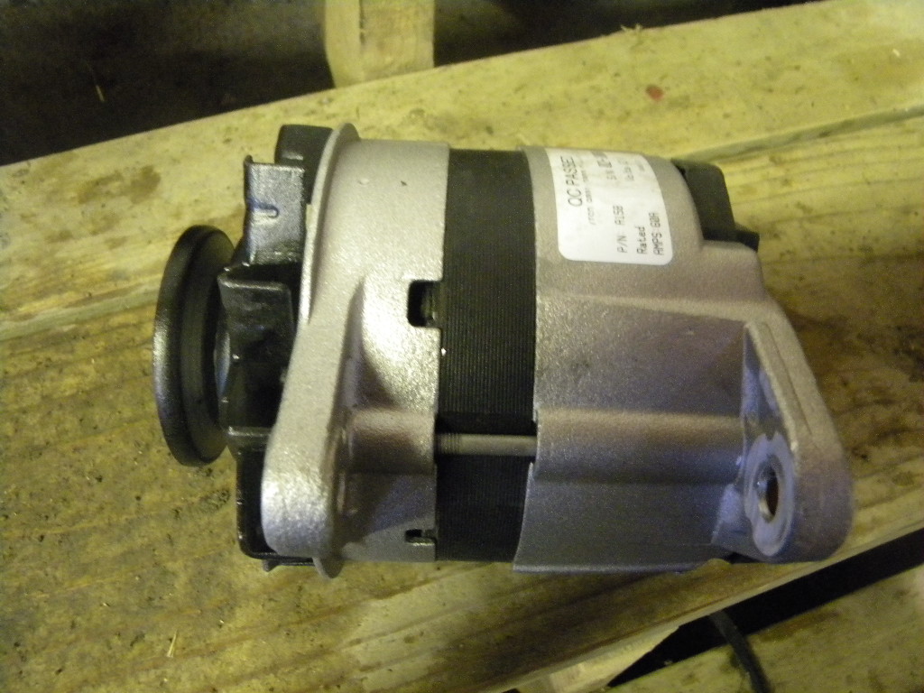

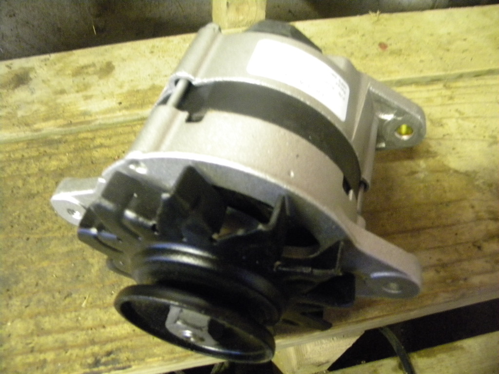

Fwiw, I did order an alternator for a 1972 Nissan 510. It came in yesterday, but did not match the connections on the back of the tractor alternator. This was from a national chain auto parts store. The manufacturer of the alternator was Mitsubishi and the tractor alternator is made by Hitachi. I did not try to make it work.
A local mom & pop auto parts store is ordering one for me and it is made by Mitsubishi. It comes in tomorrow. If it does not match I will buy the single wire generic alternator as discussed here:

Just as an update:
These pictures show my old alternator. I originally ordered an alternator for a 1972 Nissan 510, but when it came in, the wire connections did not match.

I tried another autoparts store and this one looked correct. It was $50 and matches up perfectly and made by Hitachi (as the original was). It's been on the tractor for several days now and is working as expected. I also used a 39 - 1/2 inch belt. A 40 inch would've been fine also.

I haven't had a chance to take mine off and take to a parts store yet. Been using the tractor since I got it back together. What is the model and year that alternator is from? I may just go ahead and get one and hope I can find the plug for the back of it. My alternator doesn't have the plug, just the 4 wires.
