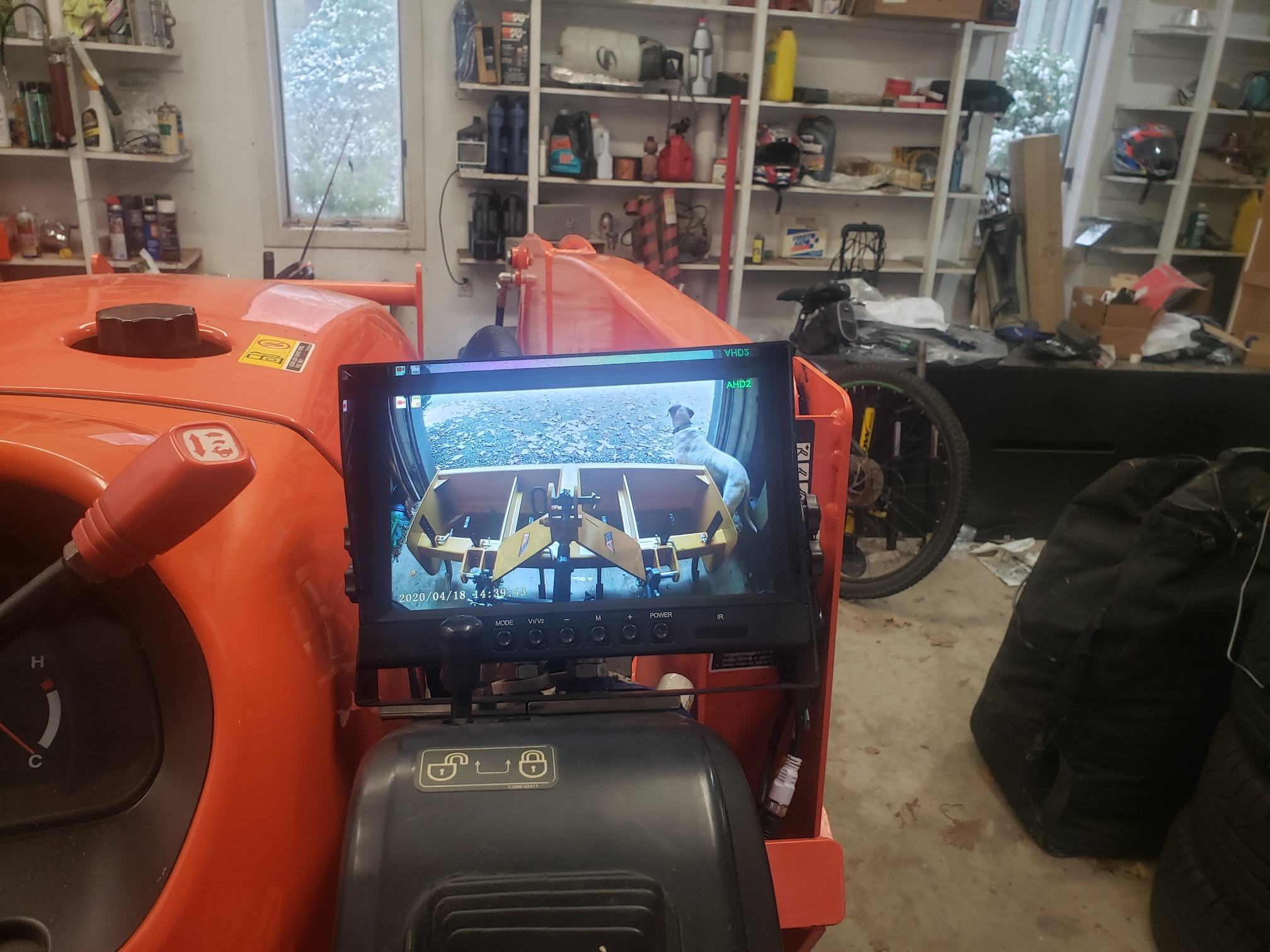

I picked this up on Amazon. Comes with 2 cameras, both on rear - this is the 'low' view one

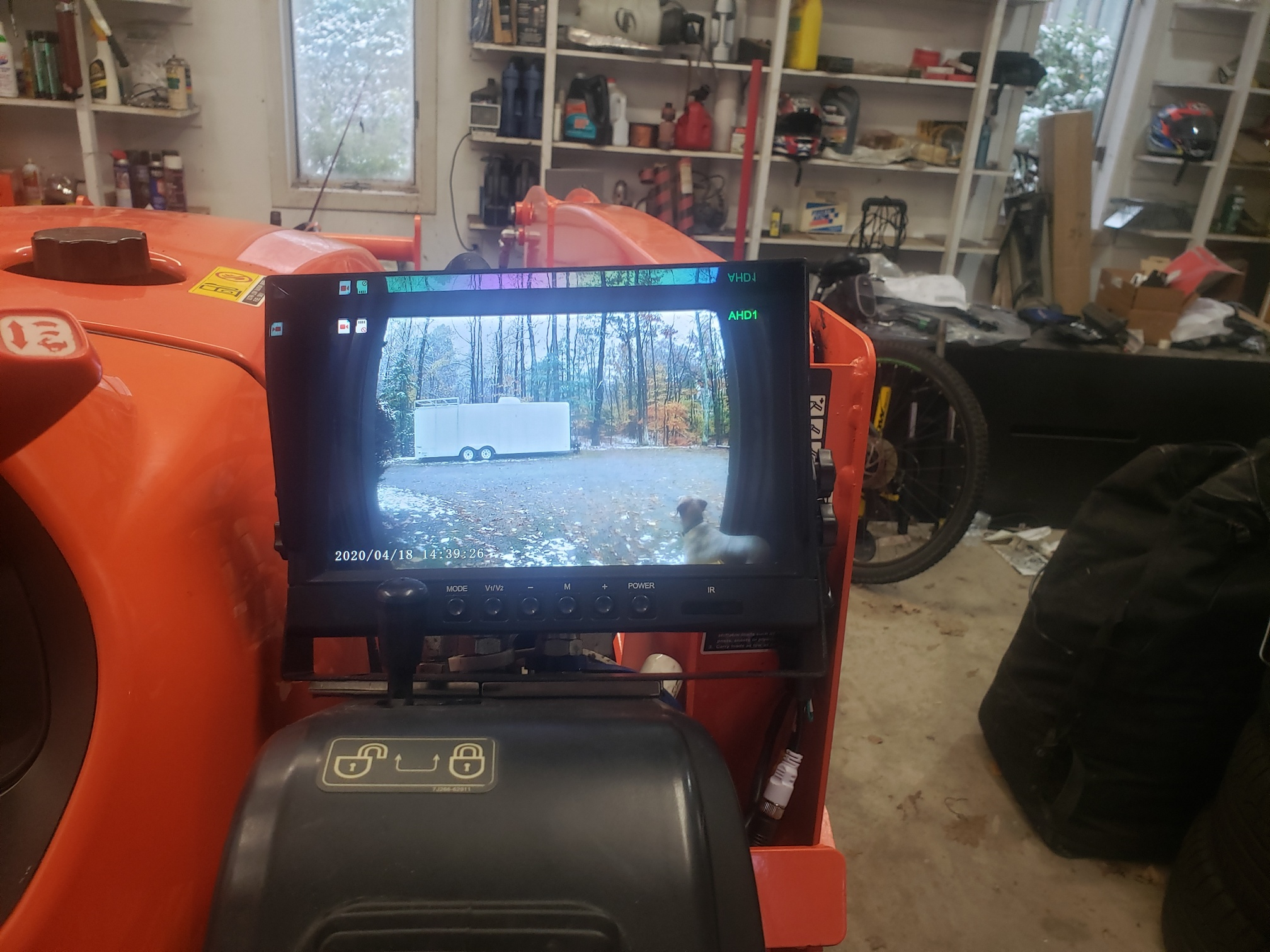

and the 'high' view one,
It has a slot for a memory card to record (I don't use). It also has provision to keep track of time and time stamp your videos (requires a wire be kept hot all the time). I don't use that either. About $100

Hello Joe
Here is the link: 9" monitor with 2 cameras
As you can see I put both cameras on the rear. There are a lot of features I don't use besides the ones I mentioned above. One which may interest you is the ability to view both cameras split screen.
After just having my 2nd cervical fusion I was more interested in just the rear views :) It comes with one 5m and one 15m cable - waaay to long. I ended up ordering 2 of these 3m cable which could still be shorter. I just looped the excess & zip tied it to the tractor.
So far no problems with the unit. If the sun is directly behind me, illuminating the monitor, it is hard to see. I haven't found that to be a deal breaker.
What may be for you, wasn't for me, is the monitor is NOT weatherproof. That said I plowed with my back blade is some pretty cold temps and the monitor was fine. It also got soaked once in a rain when I forgot to take it in :( I garage my tractor and do not operate it in the rain. As hard as I've tried it still chugging along.
