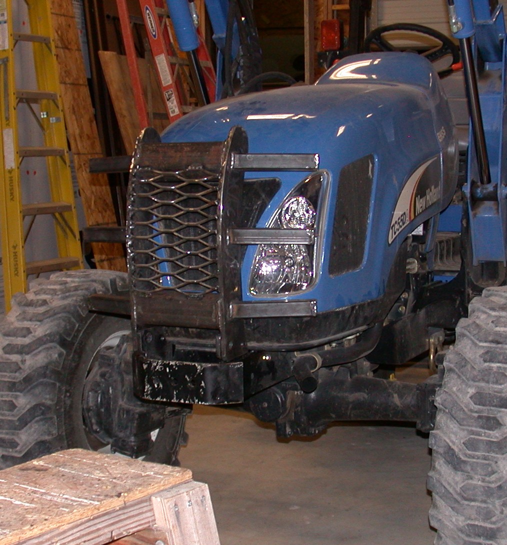

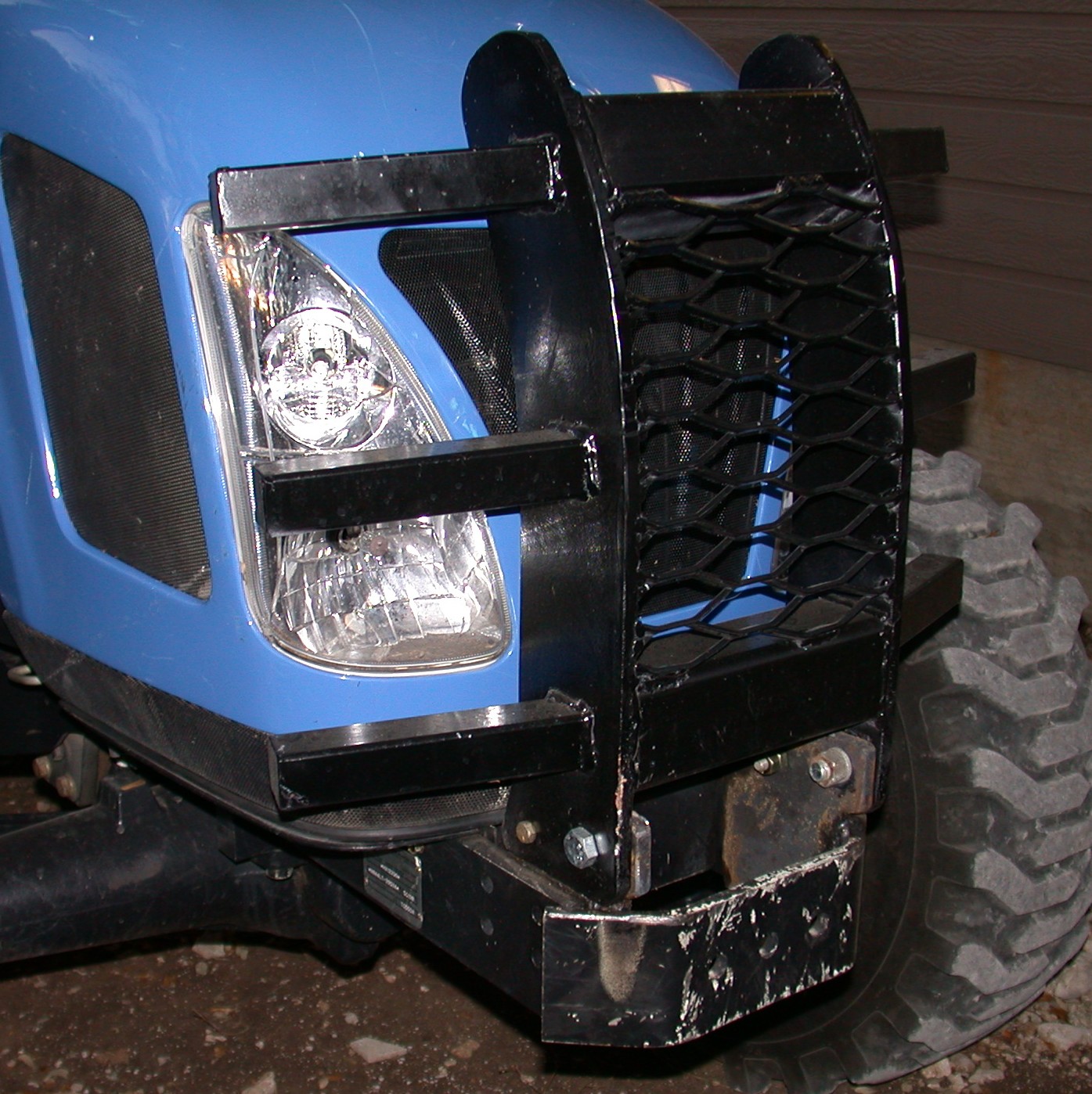

I looked at the New Holland Grille Guard and I figured all I would end up doing was to bend it into my grille with the 55DA. It just didn't look sturdy enough so I built my own. It does take some time, but the cost is minimal. Attached are pics of the one I built before and after paint.

   / need a grill guard #7
Osconda that's a nicely built grill guard. Looks like it hinges forward to lift the hood, how does it lock in the up position?
   / need a grill guard #8
Pineridge,
In the picture shown with the guard painted you can see two bolts closest to the grille. I have since replaced these with hitch pins. I pull the pins and hinge it forward to open the hood. When I raise it back up I reinstall the 1/2" pins.
I laid out the guard so it would more or less follow the sweep of the front end. I used some foam board (left over wall insulation) to make the pattern for the uprights (1/2" plate). I figured out how tall I wanted the guard to be then started trimming the foam to follow the sweep of the hood. I tried using cardboard but it was too hard to work with.
It would have been nice to have a plasma cutter to cut out the uprights from the plate steel but I resorted to the grinder to clean up the cuts instead.
The brackets the guard is attached are welded directly to the tractor. I was going to drill holes through the brackets to bolt it on instead but drilling the four holes in 1/2" plate meant I was going to have to buy a big drill bit and I was going the cheap route.
