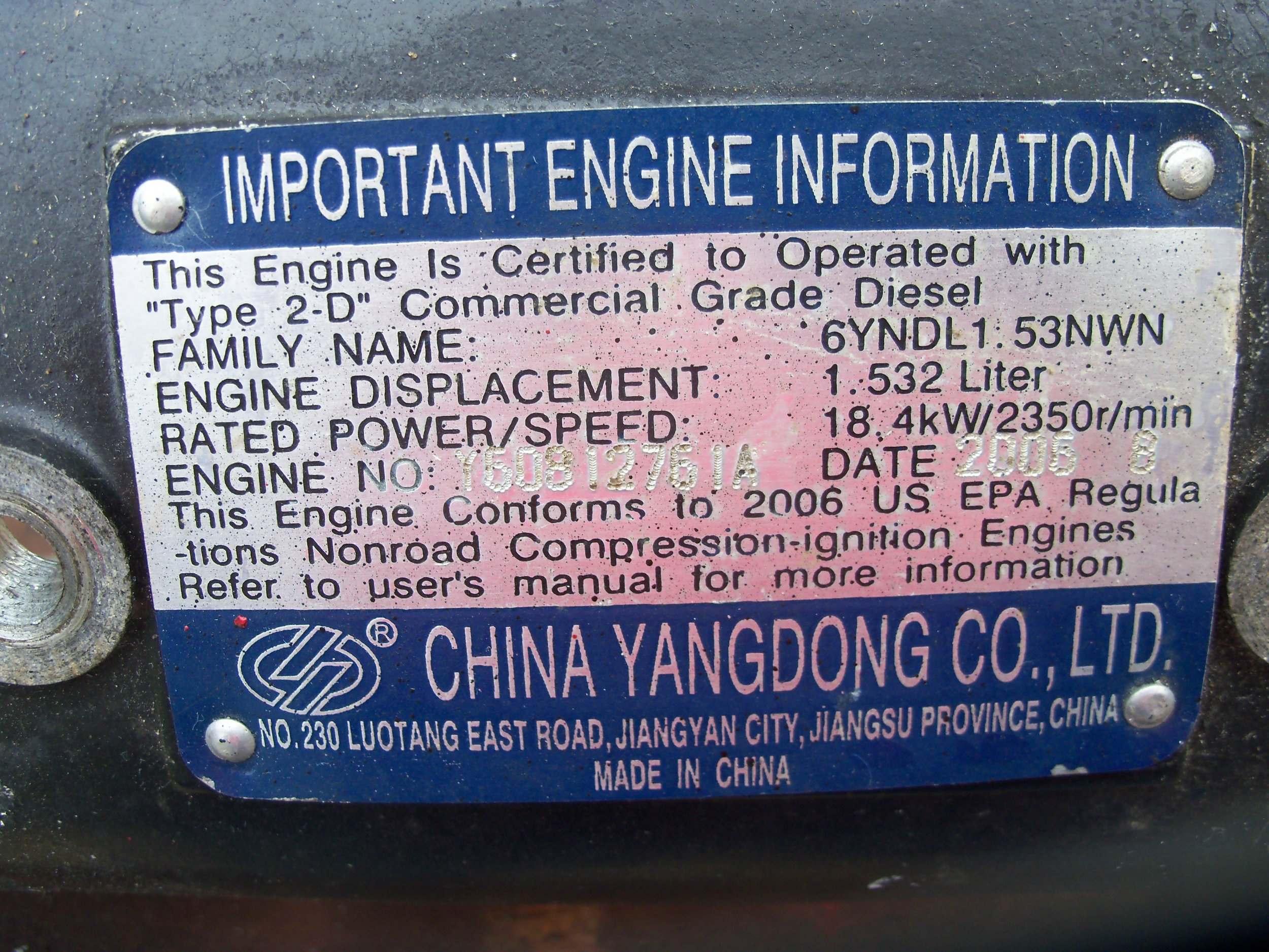

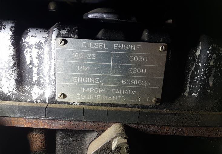

Here is the plate on the engine. I haven't found anything with the informations on it so I forgot about showing it here.

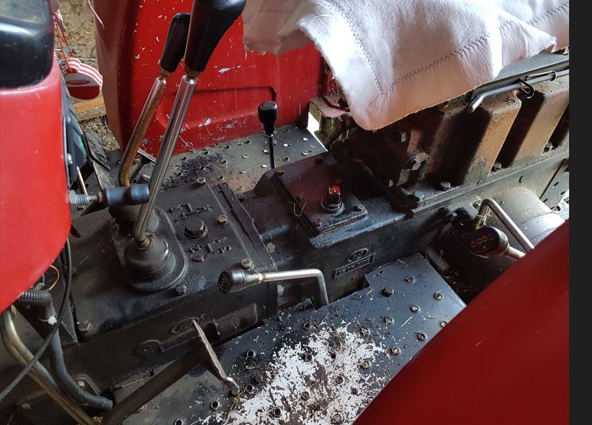

I could show you a picture where we can see the decal on the hood but KJT 6030 is the only thing written there. As for other tags, plate or anything helpful on the tractor, believe me I searched all around and found nothing except that date on the tranny you already saw (no tags on fenders, frame, engine block or anywhere else):

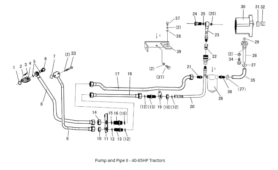

I was there when we took the hydraulic pumps off and there was nothing written on it too (I can trust my eyes on this) but what I saw on CircleGtractorparts.com let me think the pump we need is the E314 in this link:
CBN-E314 Hydraulic Pump (old style) For TY395 Engines
They even sell that cross connector that got lost with the pump:
And one of these diagrams to show where this pump is used REALLY looks like the hydraulics on my friend's KJT:
So pretty sure we're on our way to something. Thank you! I'll get back to you once I get something useful to write.
Unfortunately that's not the engine builders nameplate. The importer replaced it with their own nameplate, or placed their own over it. Doesn't seem legal to me though because it doesn't state engine specifics for environmental purposes, for one thing.

Yeah, good idea. Maybe they put this plate over the engine nameplate so I'll take this plate off to see if there's something behind it next time I'm going there.
Maybe they tried to hide the fact that this tractor is only 30 or 40HP and they where just telling BS or letting people think it has more HP because it is quite big.

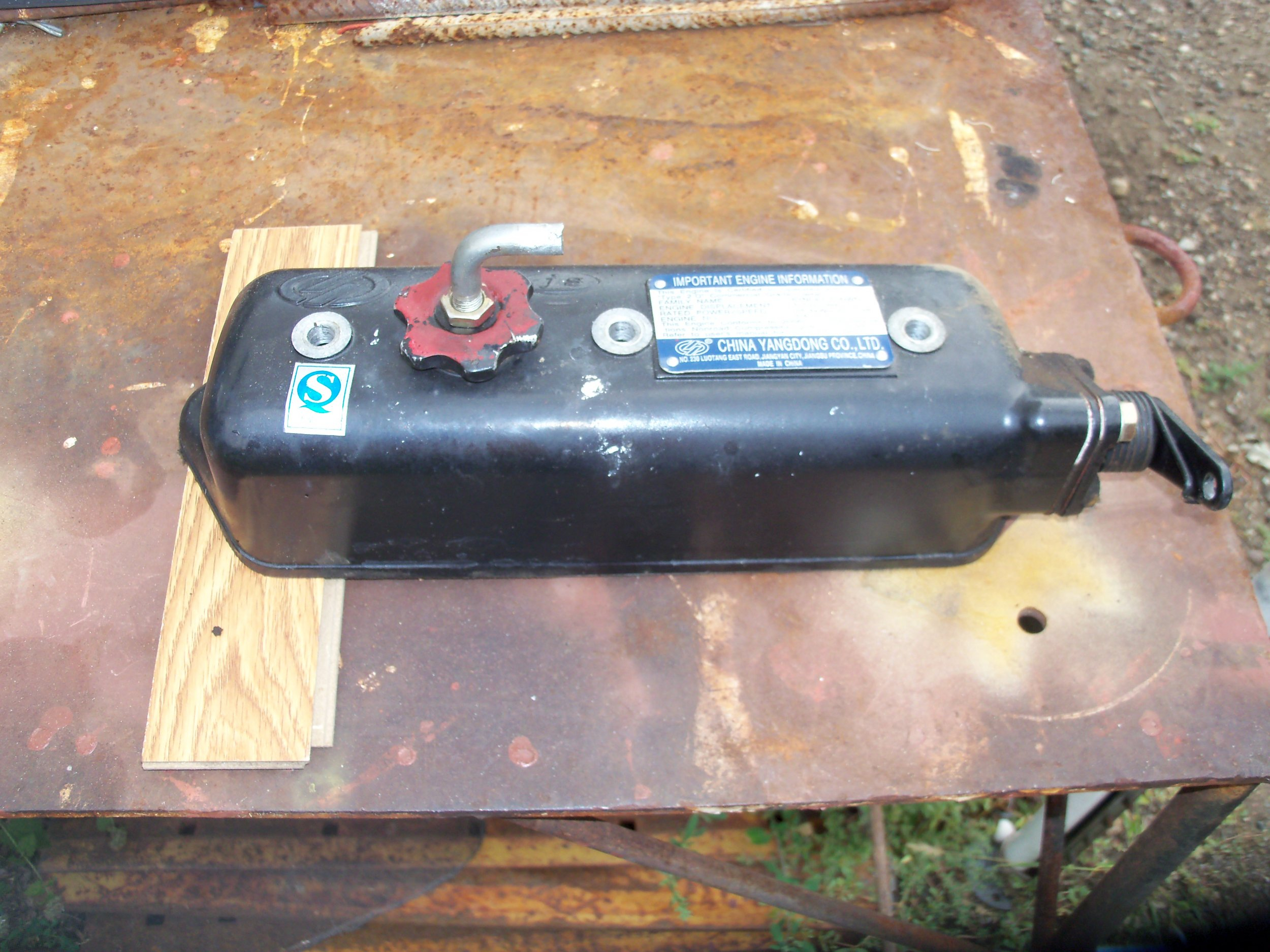

A typical Chinese engine nameplate will look similar to this:
In this instance, 65 kW = 88.3 HP.

Here is my engine data plate. Not much use except for comparison. Bob is right, at least here in the US I think removing a plate with EPA info is a no-no. At any rate they are supposed to be riveted or welded on, not held on with screws. My guess is the importer did this and the original is long gone. And anyone who does this is not going to freely share the info they removed.

And the only big difference I can see is the transmission shift pattern.
All the 354 I see are like this:
While the KJT 6030 has Lo Hi and reverse on the same stick:
But we're definitely close to solve that mystery!
