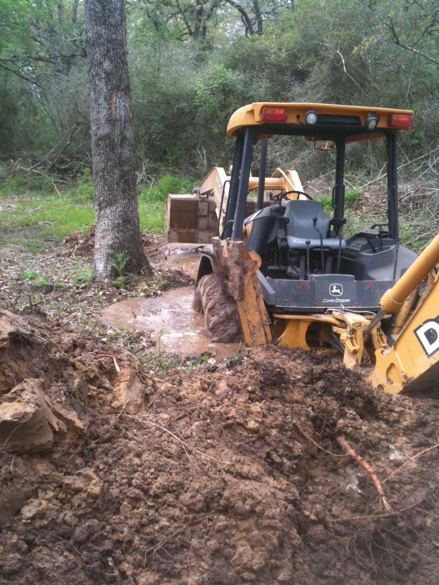

thanks fellas! i hooked to the front weight bracket with my tow strap and it pulled out nicely. my buddy pulled up in his brothers chevy dually diesel 4x4 and with me having it in low 3rd gear with the posi ingaged running approx. 2 grand on the tach it was no problem. once he nudged me a little it climbed out.

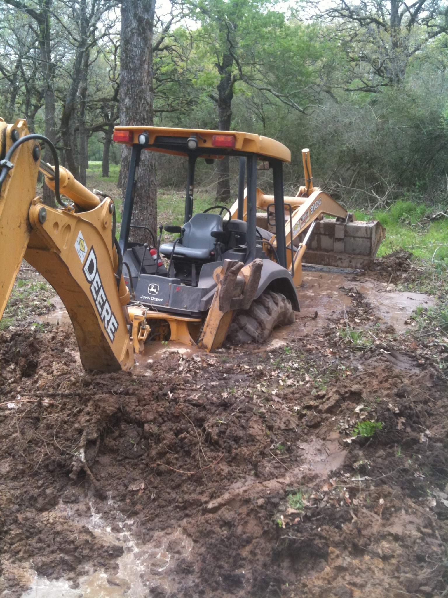

MAN!! I am afraid to ask how THAT even happened??:)
I was going to retrieve a 2400# ballast weight I had to leave behind when I got my Deere stuck a few weeks before. I felt the rear sit down and stopped to back out of it using the front bucket to push back. When that didn't work I turned around in the seat and tried to pull with the rear at the same time and that didn't work. Then I started to dig the muck out behind the hoe to find hard ground to pull against. After digging for a few moments I heard the fan hitting something and turned around to find the front had settled to where you see it here. It took a Deere 700 lgp dozer to pull it out and the suction pulled both front tires off the rims.
