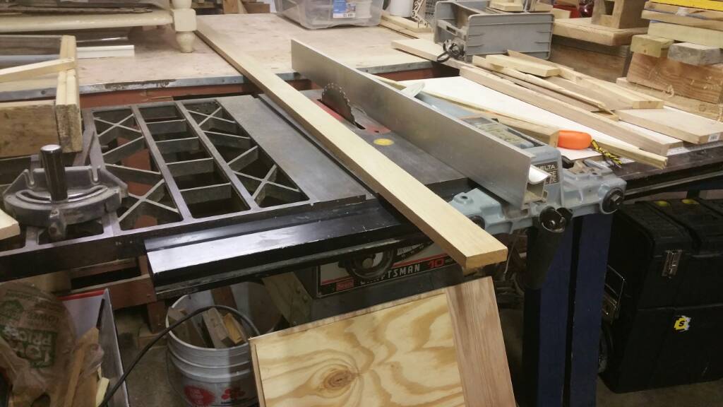

Joe, it looks like you are going to be in good shape with the new motor. Is it a sealed type or open like the original motor? The location on the contractor saw put the motor in a pretty dusty location, I used to blow a lot of dust a debris out of my Sears saw. The delta has a sealed motor which is really nice.
/ Need a new table saw
#30
The Grizzly is sealed with bearings. The original was open with sleeves type shim that requires oiling.

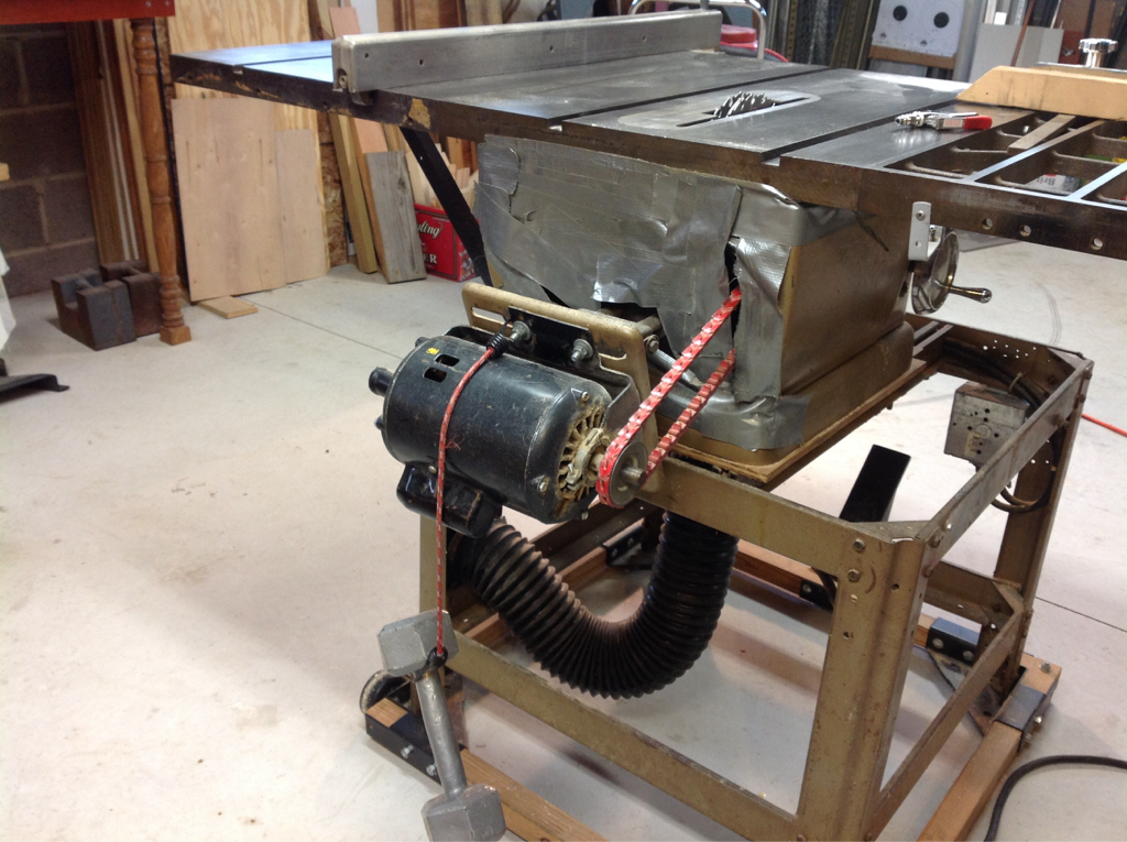

Make sure the belt is not slipping. If you look at my picture, I had to add some weight to the motor to keep the belt tight so it would not slip.
