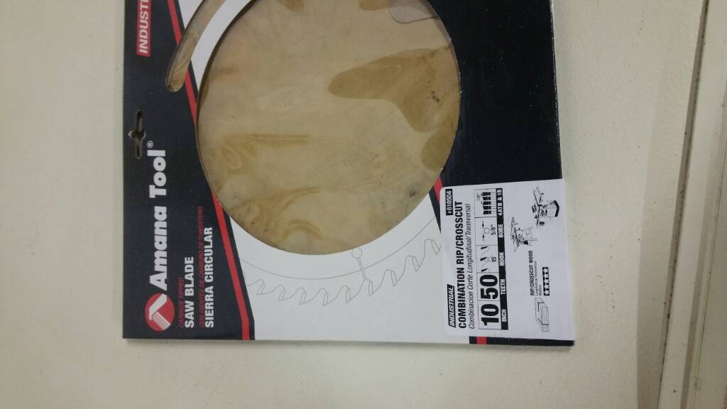

What a difference a new blade makes!
I got one of these :
And it slides through 8/4 mahogany like butter! Wow.
Craftsman 1" table saw on Vimeo
Amana Tool combination
50 tooth 4&1
