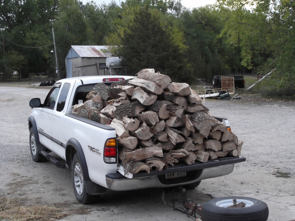

I set the loader valve relief to about the same as the splitter Friday afternoon and we went and cut and split about 3 big loads (cords) yesterday and I did 2 small loads at the house Saturday and it works ok! :thumbsup:
I still like it a little quicker on retract but I believe I will use it as is. It surprised me that the tractor hydraulics actually worked as good as they do it saved me some time getting it ready to work thanks everybody for suggesting that I use them! :thumbsup:
I think it is time for a bigger truck now:D
   / Need a pto log splitter guru for advice J_J?
#76
Yeah I did over do it a bit! :laughing:
Actually I have Air Lifts on it is the only reason its not azz dragging the dirt but also I dont make a habit of loading it like that. :)
Well also my buddy that was going to pull the pub couldn't show and I didn't have the receiver hitch welded into the back of my trailer yet to pull my "PUB" (pick up bed trailer) behind next time I go out I will and spread it out some. :thumbsup:
