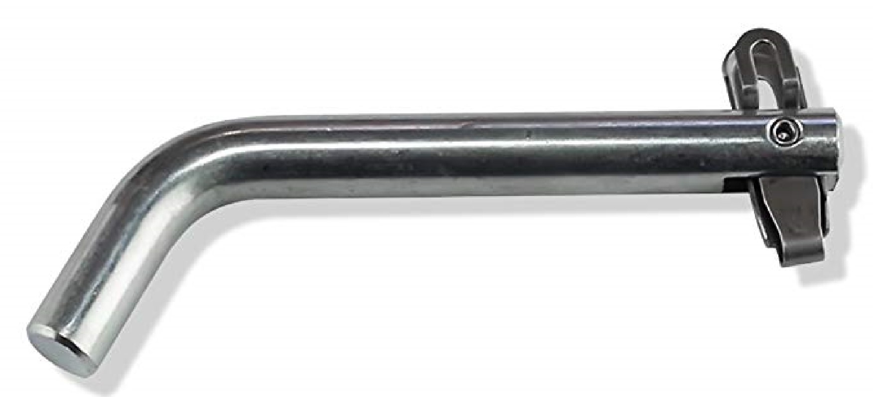

Best thing I see to do with a HF QH is to remove the bolts holding rhe top hook in place and buy removable pins that fit in their place.Al
I had to drill out the holes slightly since the HF bolts are metric but I bought 2 of these 1/2" trailer receiver pins. Paid about $6 each but they work great and it's just a pin, no extra clips.

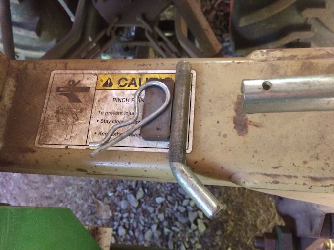

Found a better picture of pins and clips.
There's also a barely-visible plastic toolbox cobbled on back there for various 3-point accessories. I should weld on a metal ammo can to replace it.
This photo also shows the devices I welded up that keep the trailer ball on the cross-drawbar from swinging down. A piece of flat stock is welded to (removable) cat-1 to cat-2 sleeves at each end. Then bolts instead of clips at the ends. I intended this as temporary but they have stood up to pulling a 2600 lb watering trailer all over this steep orchard for several years now so there's no need to replace them with the store-bought bracket that is made for the purpose. In fact I doubt that bracket could be used with a QH.
