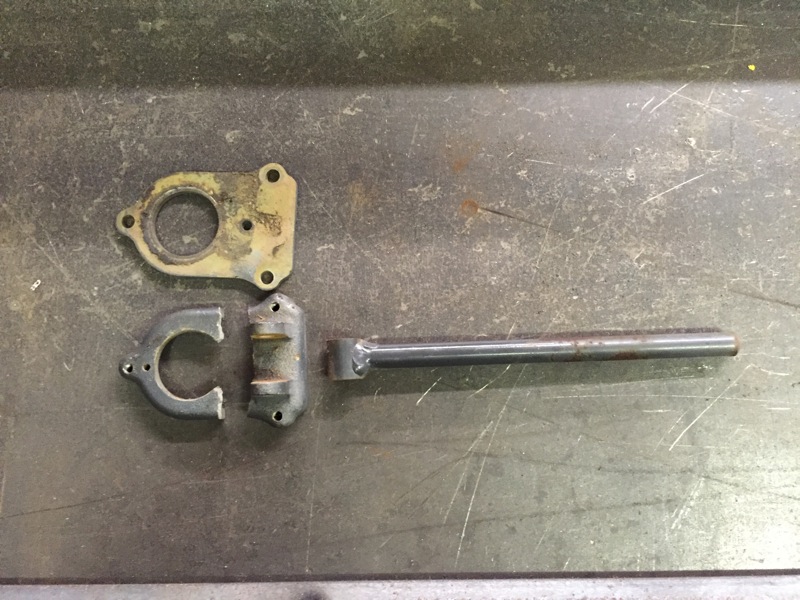

I could certainly see what I could do. If you ain't in a huge hurry. Working around my 12 hr work schedule 4-on 4-off

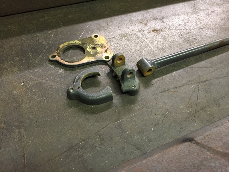

Here's a couple pics of the other side:
I'm not in a tremendous hurry ... the other adjustable side link (which is also broken in the same manner) is still on the tractor and functions (for the most part) ... it's just a PITA to adjust.
But I would like to get it fixed in some kind of reasonable time frame ... preferably before this spring/summer season is completely over ... :D
Yup ... totally understand.
Can do.
Looks like we're going to be heading down to Columbus to visit the kids next weekend ... I could drop it off on the way by.

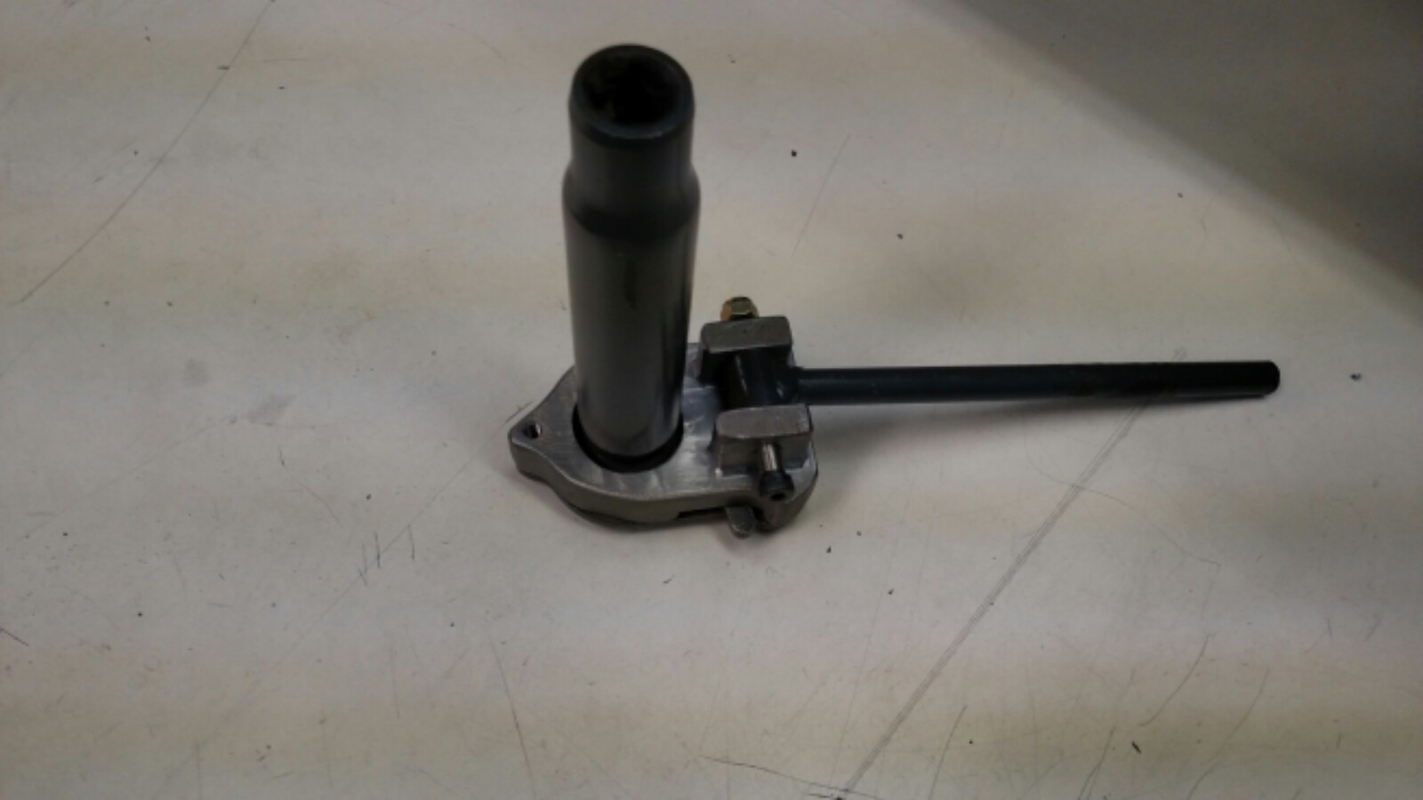

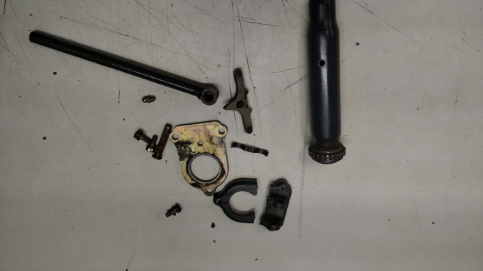

Parts arrived today. (Well yesterday for you dayshift folk).IMG_20160520_023544189-1600x900.jpgIMG_20160520_023624088-1600x900.jpg
   / Need a small amount of machining done #18

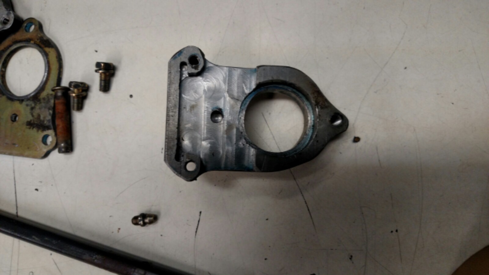

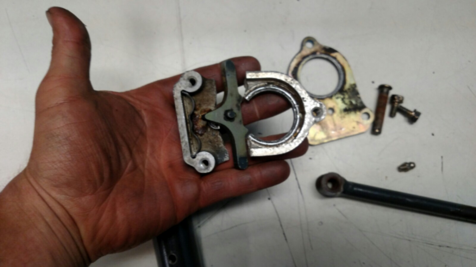

Was a pretty complex peice. And most dimensions, like the thru hole and counter bore for the gear were metric. Thru hole was 34mm. Tad bigger than 1-5/16 and tad smaller than 1-3/8. Hollered it out a little freehand with the mill. Same for the counter bore . CNC would sure be nice, especially for all the work on the inside of the piece as well as shaping the outside. But roughed her in and dressed with an angle grinder. Ain't the prettiest but works.
   / Need a small amount of machining done #19
Put together and tested. She works. Selected lever is a little stiff, but I didn't pack it with grease either. Don't know how easily it operated before either.
I left the ears where the handle mounts a little more robust. The oem pin is too short. I'll send the shoulder bolt and lock nut along with it. And I will leave the grease zerk out of the tube since it needs to be out to assemble.
