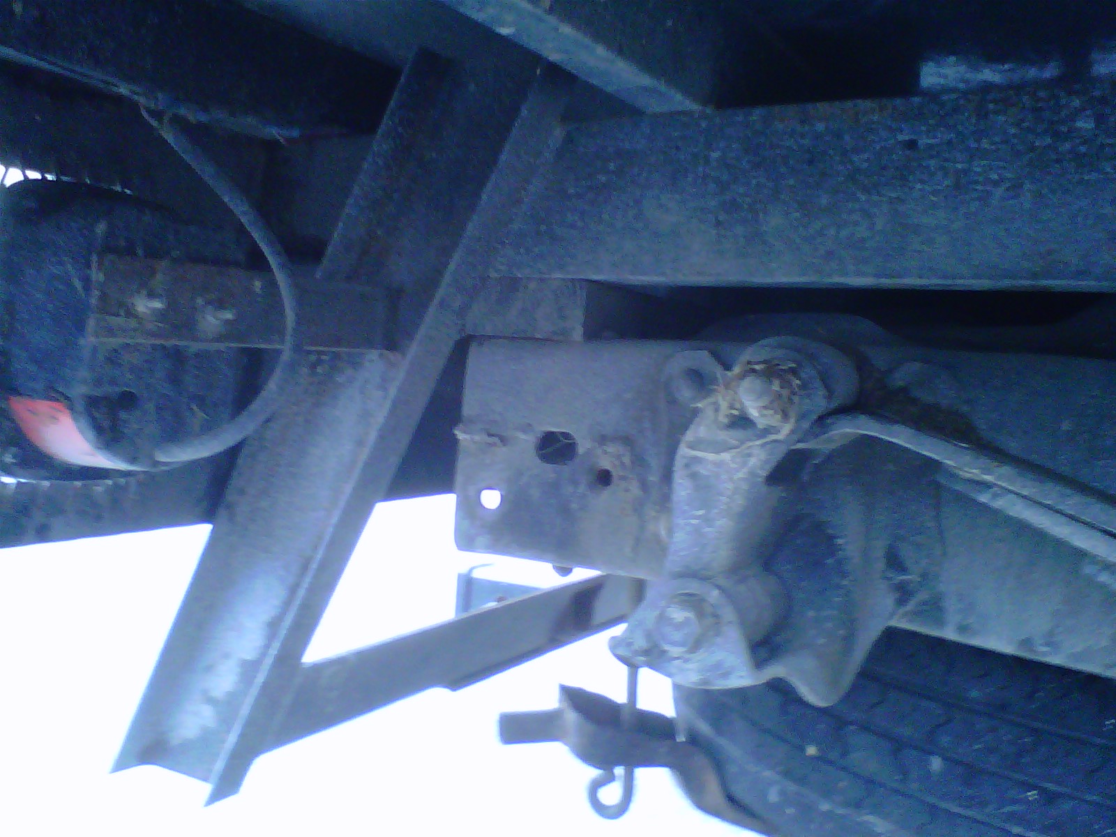

My brother-in-law, who works for the Highway Dept. in KY and is very well versed with equipment and trailers, said that the bumper hitch could use a little beefing up. He wasn't so much concerned with straight downward force of the trailer, but the torque that was created during braking that could cause the whole hitch/step of the bed to cave inwards towards the cab of the truck. He recommended welding a couple of braces on each side to help strengthen it. In the pic below you can see that the single arm on each side is really all that holds the hitch receiver assembly. As constructed, it should be plenty strong for downward force. But the lateral forces might be an issue.

I agree about that hitch. A few braces will make it rock solid.
Chris
