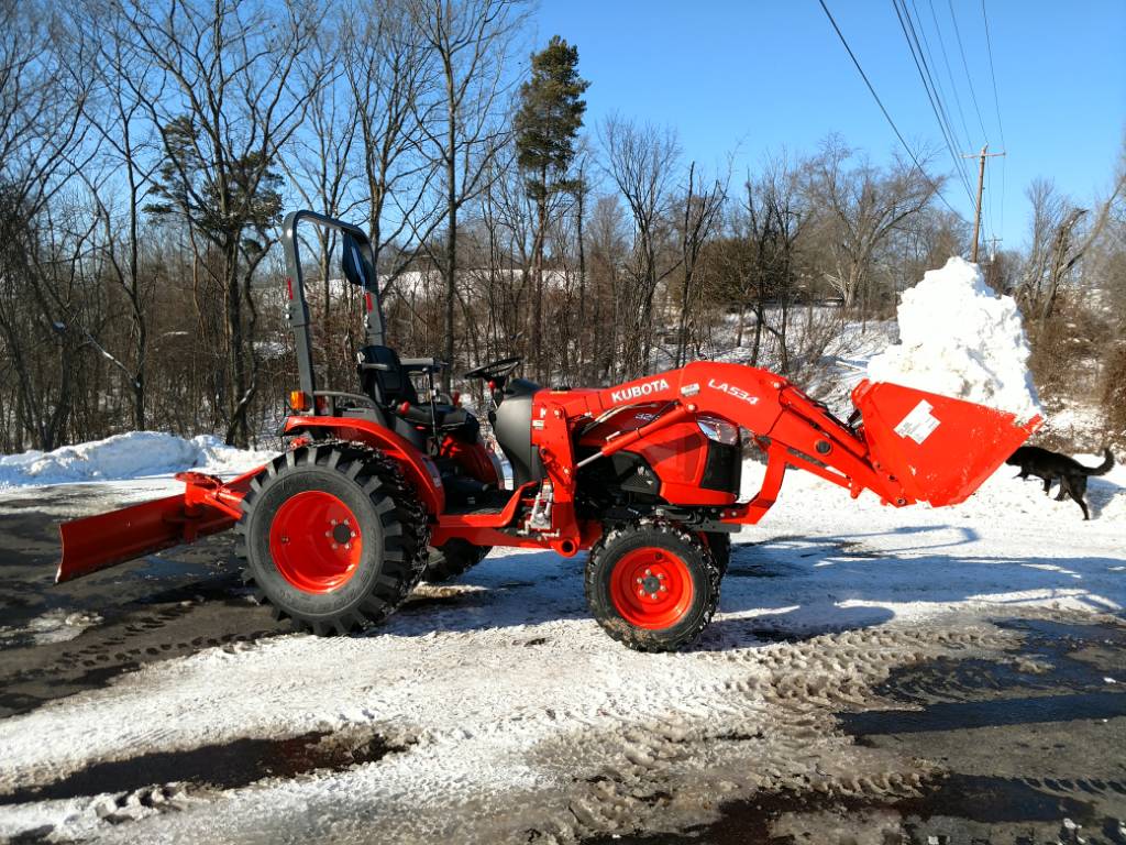

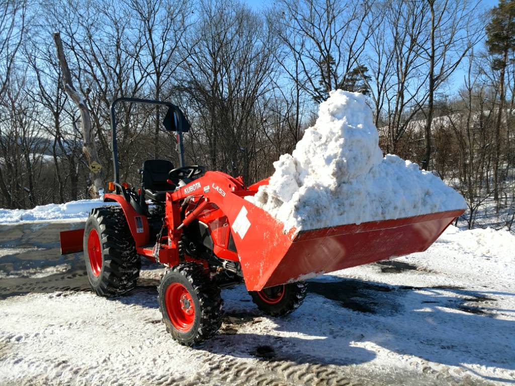

I use a 72" straight rear blade in Western Pennsylvania, we don't acknowledge 1" of snow, that's flurries
Your talking about a foot shorter than mine, and it's a V plow, so your never really pushing/plowing, your more sliding snow out to your sides. That will be cake work for a B2650 with fluid filled tires and around 500-800 lbs of rear ballast. Kubota makes a ballast box for this size tractor that is only about $300. You can also use a PTO drive salt spreader as your rear ballast.
All in all, that plow would be a walk in the park for my B2650 in medium range unless it was literally a 12"+ nasty, wet, heavy snow.
May I strongly suggest doing your build with the wider/heavier ballasted B3350SU R4 tires? I'm plowing paved surfaces with them and traction is never an issue while I see others talking about chains and the such. Unless I needed plow on ice or up honest to goodness steep slopes, chains are totally not needed. Because I'm on blacktop, there is never ice. Even in a 0°F day I can plow it and the sun his the visible cleaned black stripes and it heats it and starts melting. After plowing in the AM, the entire drive will be dry blacktop by the time the sun goes down. I only salt in the areas that are always shaded.View attachment 545903View attachment 545904

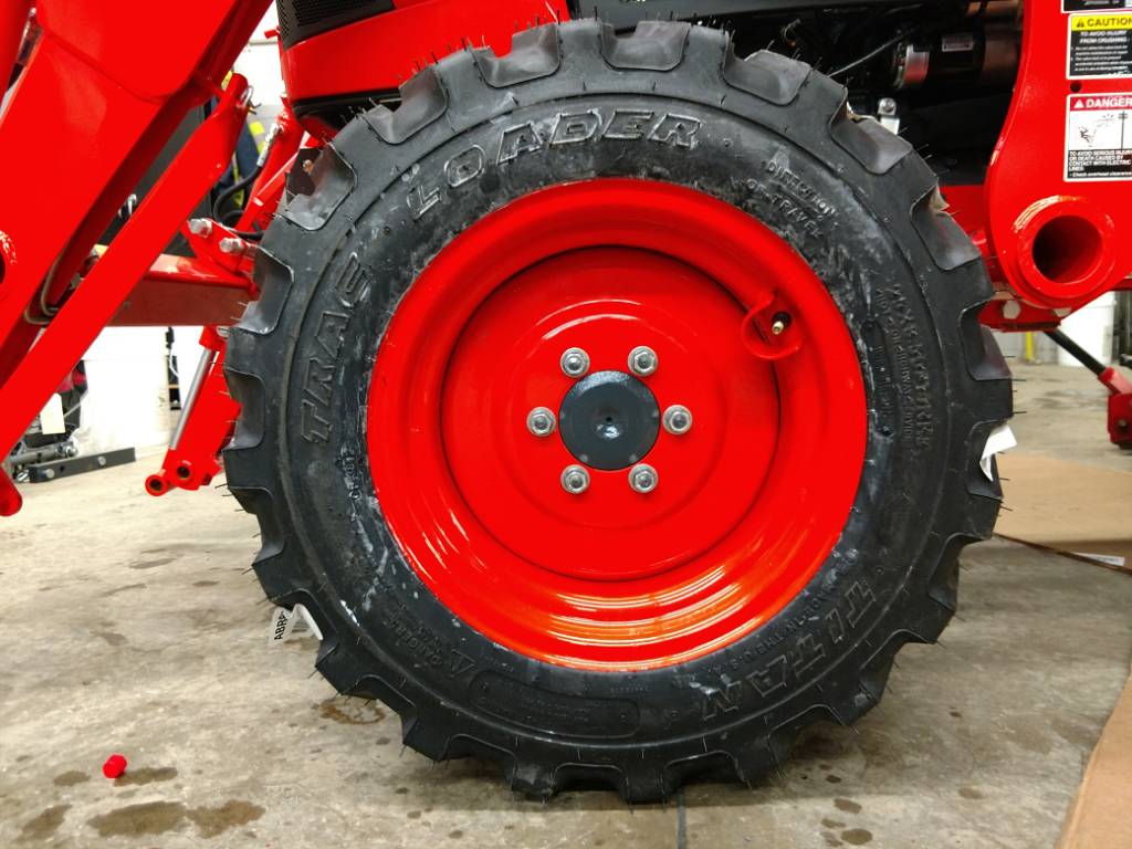

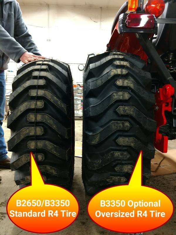

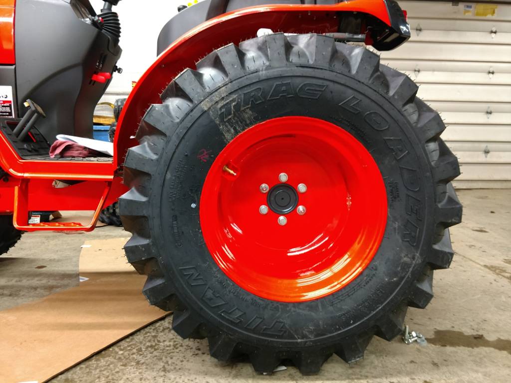

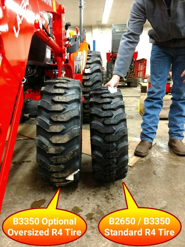

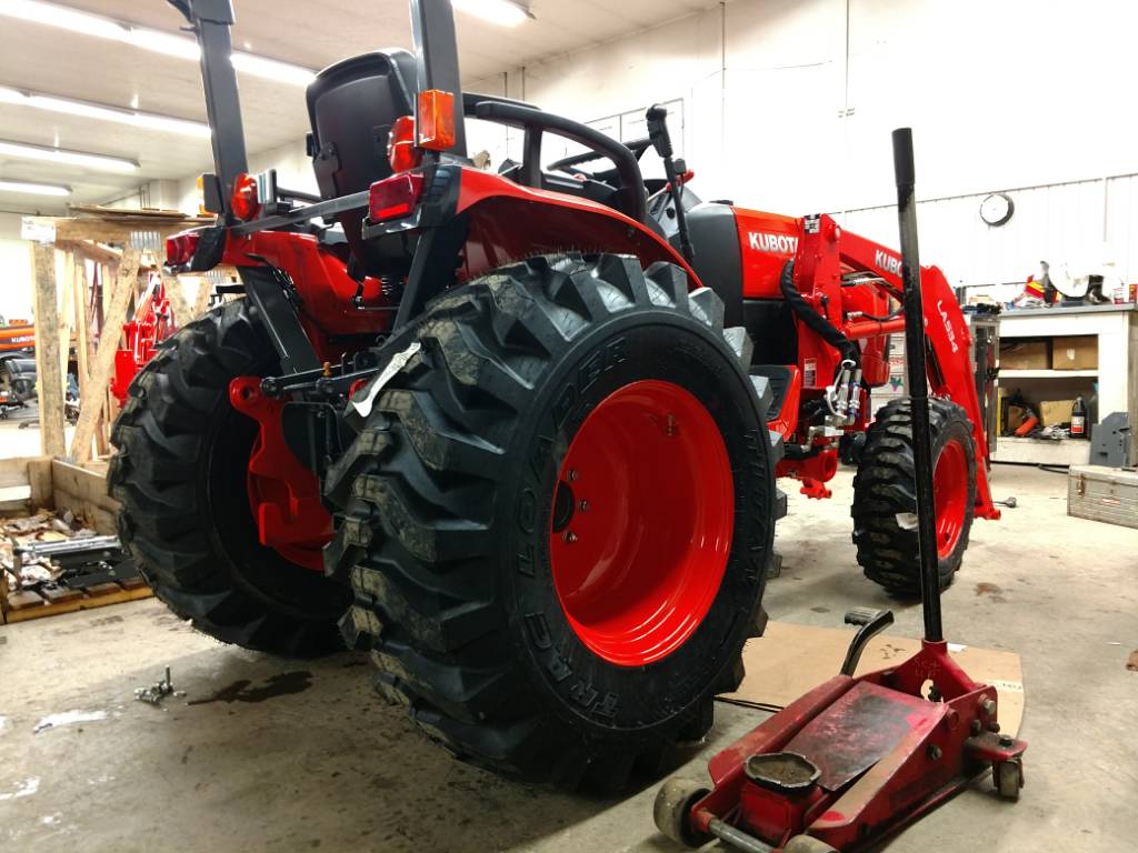

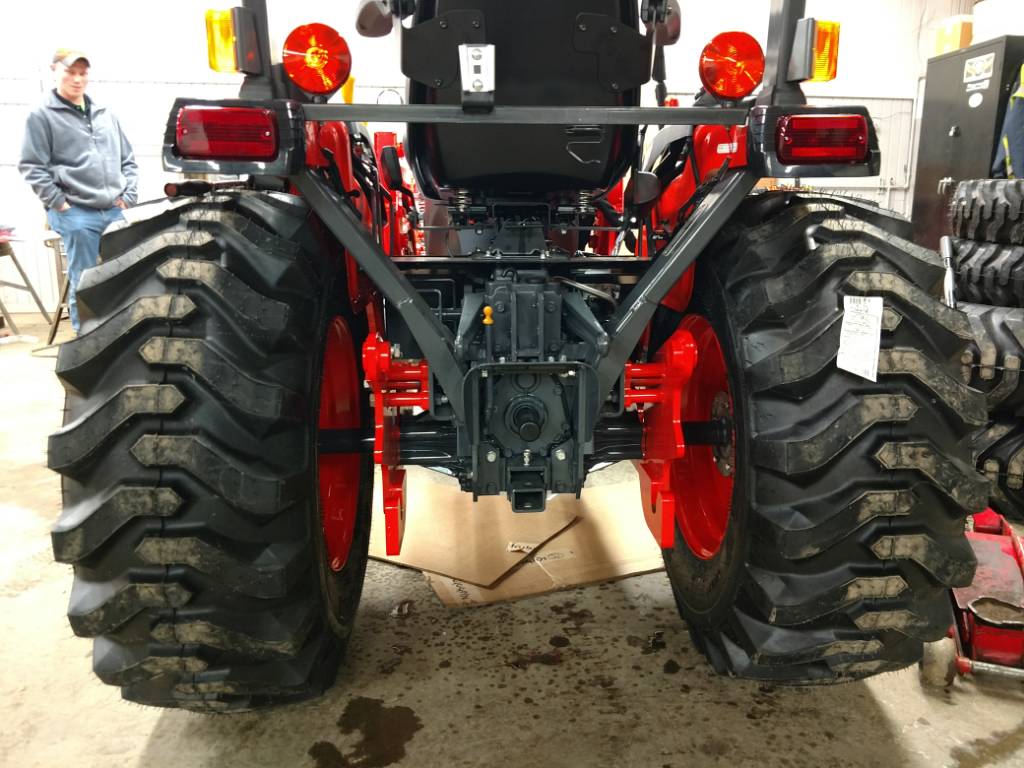

If you requested the heavy duty tire, your getting the standard B2650 12" wide and 37" tall 4. I have the 40"tall and 15" wide B3350SU tire package, it was a very reasonable $450 upgrade for all 4 larger R4 tires.
I've attached photos of the tires your getting beside the tires I ordered. Sean Huegel at M&R power equipment in Butler, Pa took care of putting this package together for me. After looking at the photos.... Would you say that this monster tire version looks like a toy? I doubt it!
I'm also using the Kubota 1.5" rear wheel spacers, so that adds 3"to bring this package to 60" wide. If you skip the spacers, with these tires you'll be at 57"at the outside edges of the tread.

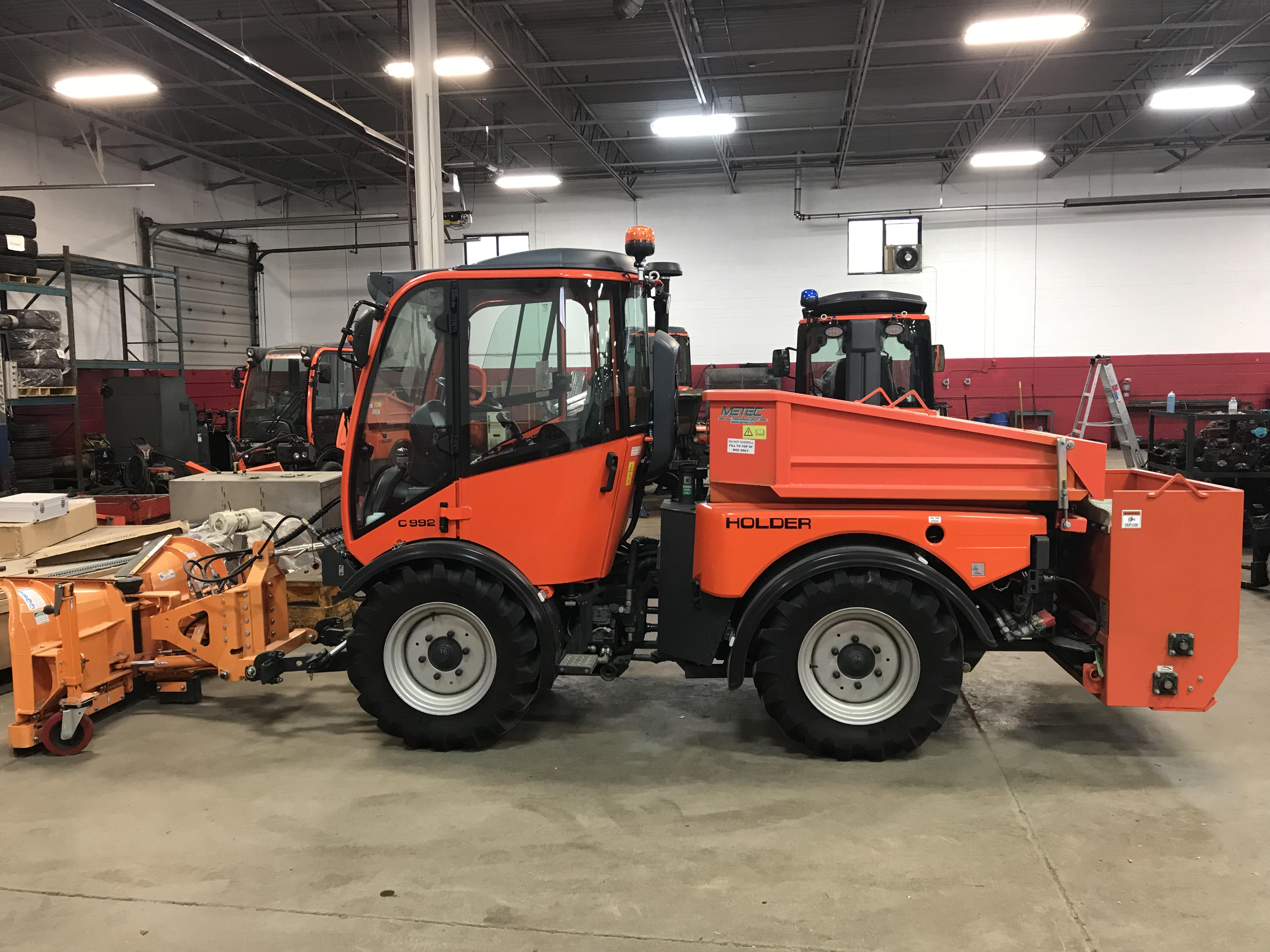

Wow, that is very detailed and extremely useful. I am highly considering this as an option. Since you have experience in this field, I'm going to attach a picture of another piece of equipment that is german made, "Holder C992" i was told that this is the machine of choice for this type of work, but people usually steer clear of it due to it's high purchase price (over 100k canadian). In a competitive market like ours (30+ bidders) I would never win a contract with this machine. Curious to know if you have thoughts about it? I went to see one recently, here is a pic of it. It was really cool and had a lot of features, hopefully you have heard of it. holder.jpg

No sir, I am total unfamiliar with that kind of articulating machine.

hey! i loved it when i saw it too. haha So the reasoning behind the "V plow" is that it builds up less resistance for a less powerful machine, you essentially cut your stress weight by 25%, instead of having a 60" blade build up enough snow to push it to one side, your essentially letting two 30" blades push the same material but quicker, therefor easier. In regards to your other comment, sidewalks in this region typically run "through" peoples driveways, essentially leaving a 8 foot boulevard/remaining driveway between sidewalk and road way. So if i push snow to one side, the home owners have more snow to clear on one side. If i V plow the snow to either side, the home owners will have 2 smaller lines of material to clean. I hope that made sense.
