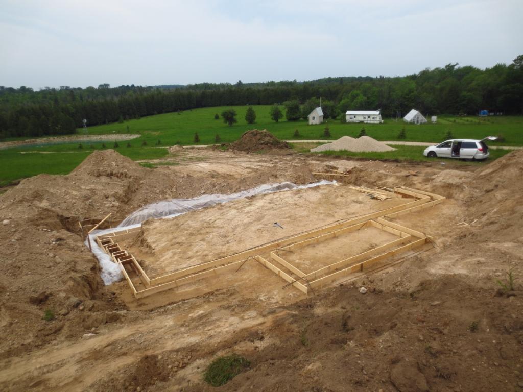

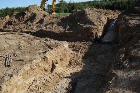

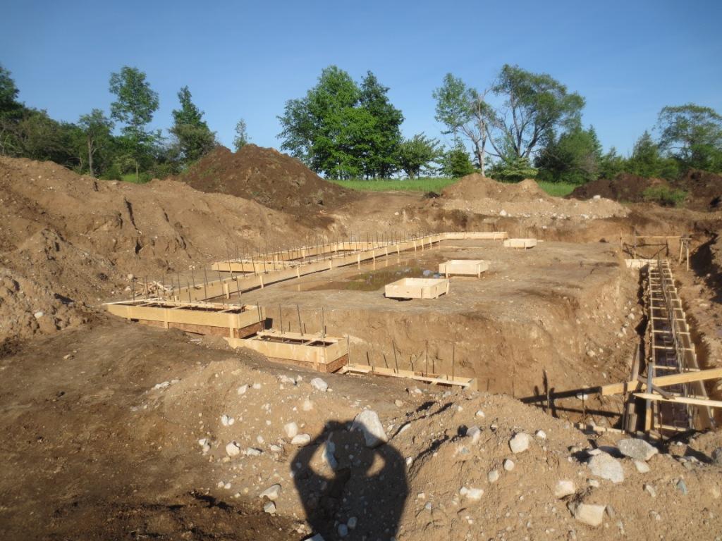

Just a quick update after architect and engineer visit couple days ago. They give me two options:
1. create an engineering pad
2. increase the width to 24" and thickness to 20" plus add 2 rows of 15M rebar. Previously the footing was 18" width, 8" thick and no rebar.
I choose option 2, plus I laydown the rebar on the entire footing and not just in that portion. In addition to this, I added a drain trench down the hill as few of you recommended. In the same trench, I added 2 PVC pipes to run the rain water from the gutters and footing drains down the hill. Here is a panoramic view of the layout and the drain trench is on the right side.
We pass the inspection yesterday and we were ready to pour the concrete today. Unfortunately we got hevy rain all nigth, so we cancel it for a few days just to dray out the trenches.
