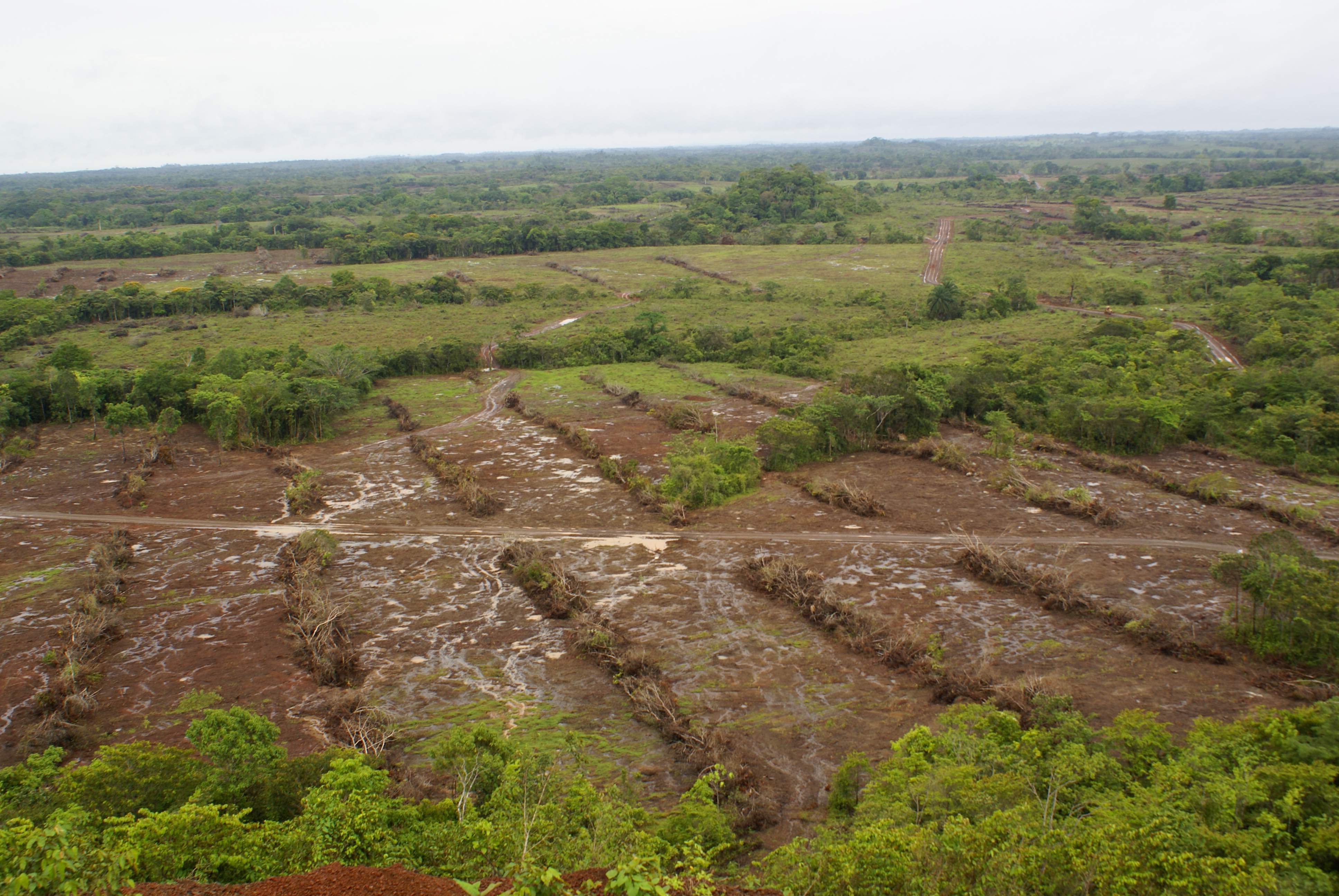

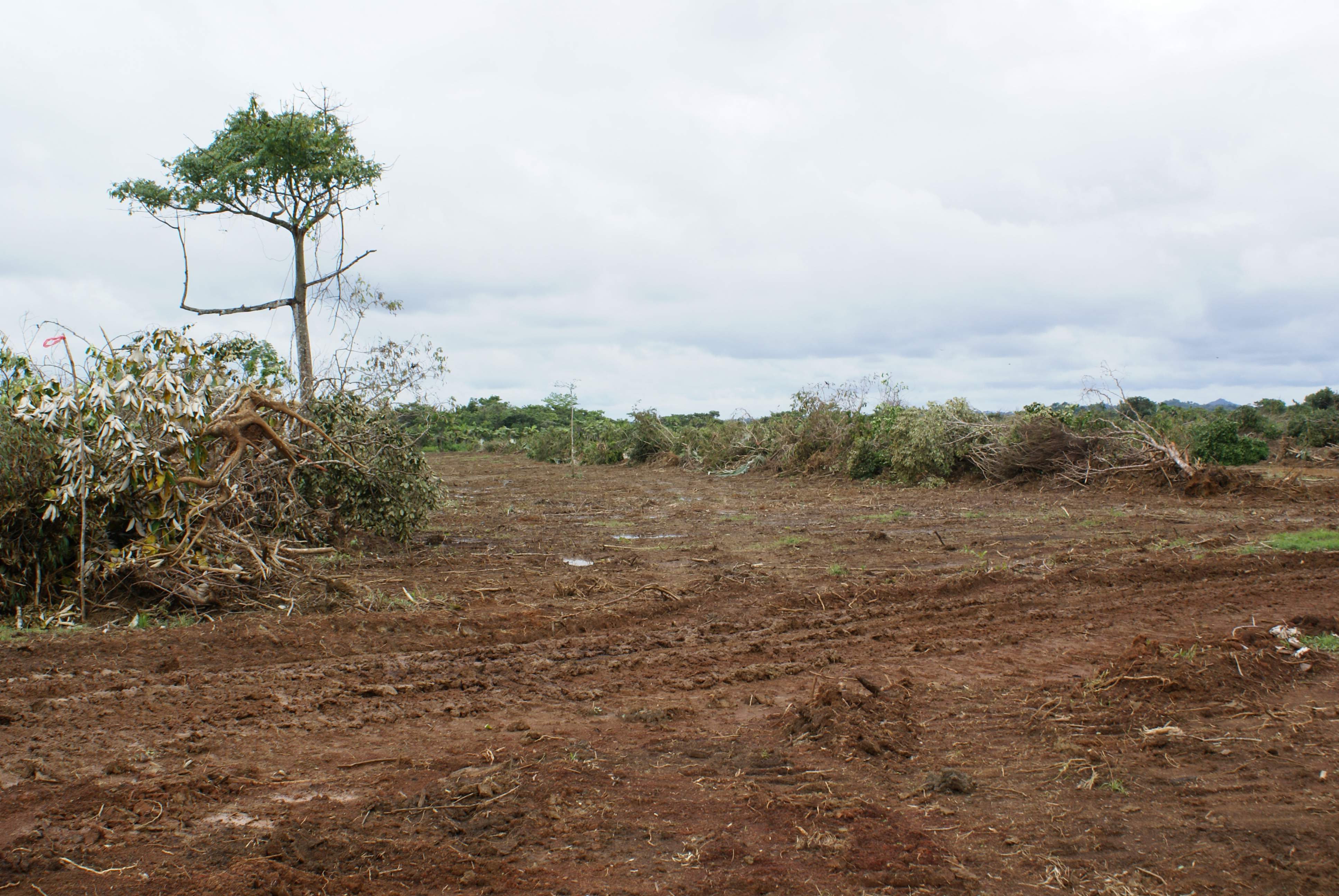

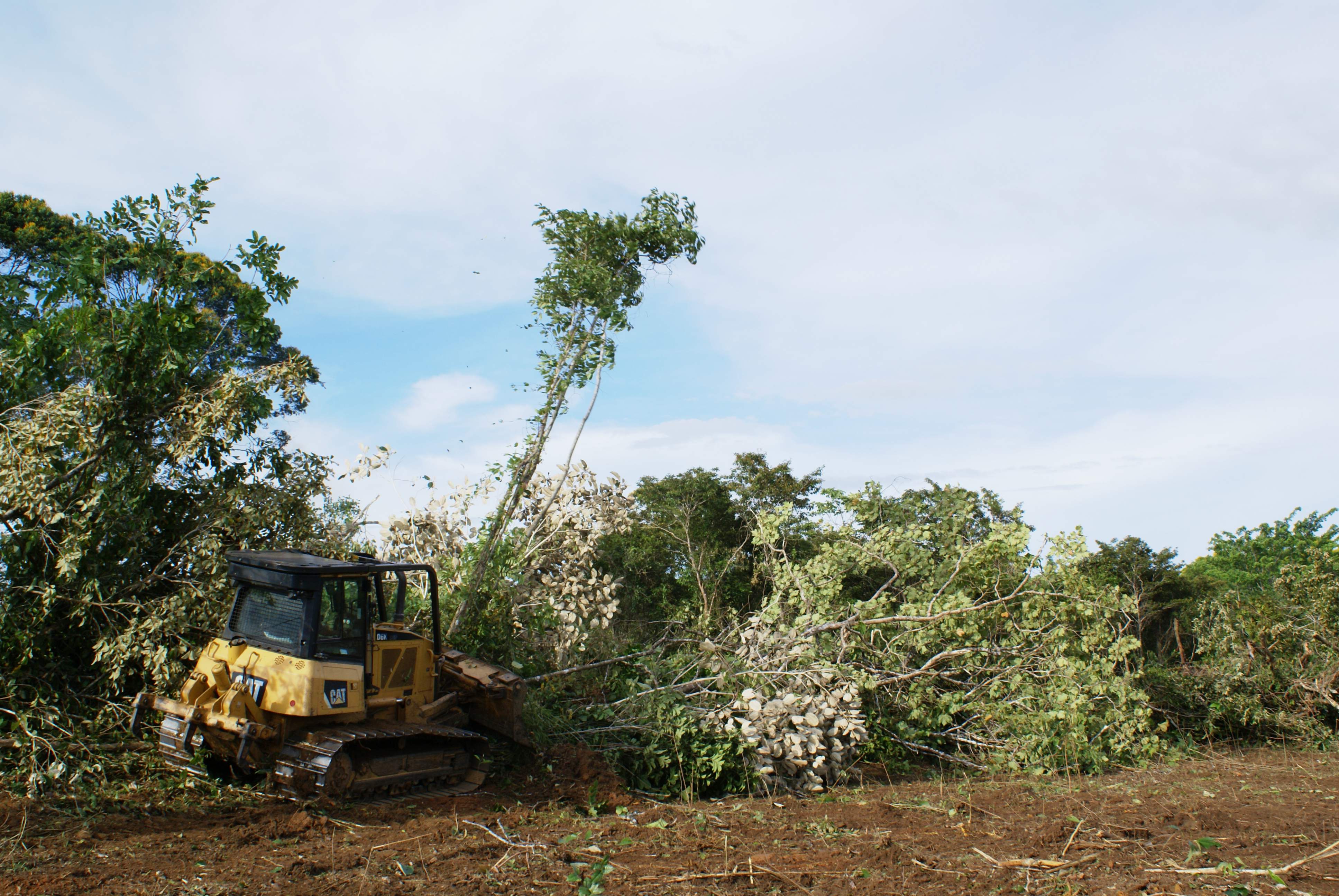

Here are some photos of the piles we are dealing with.
