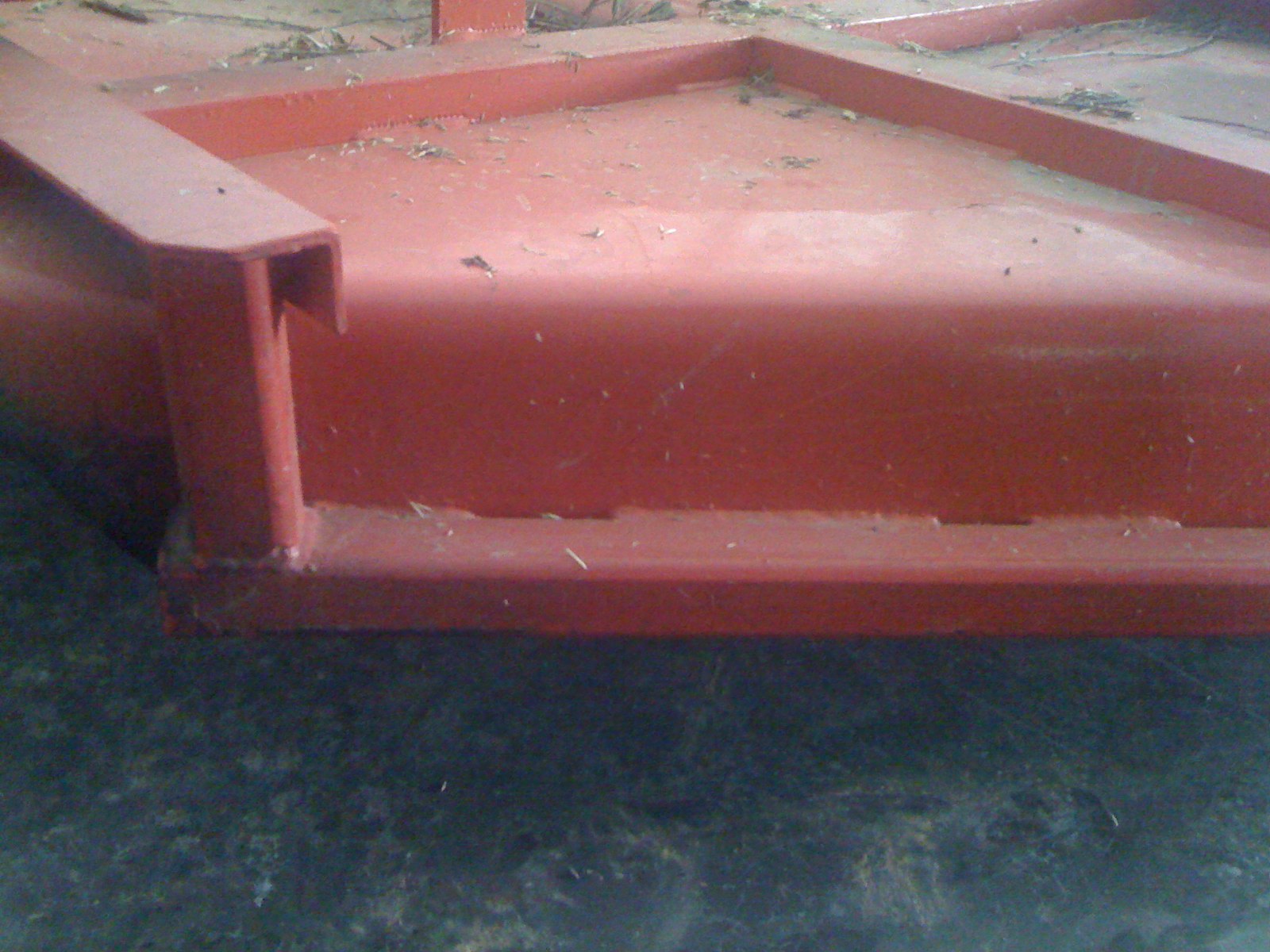

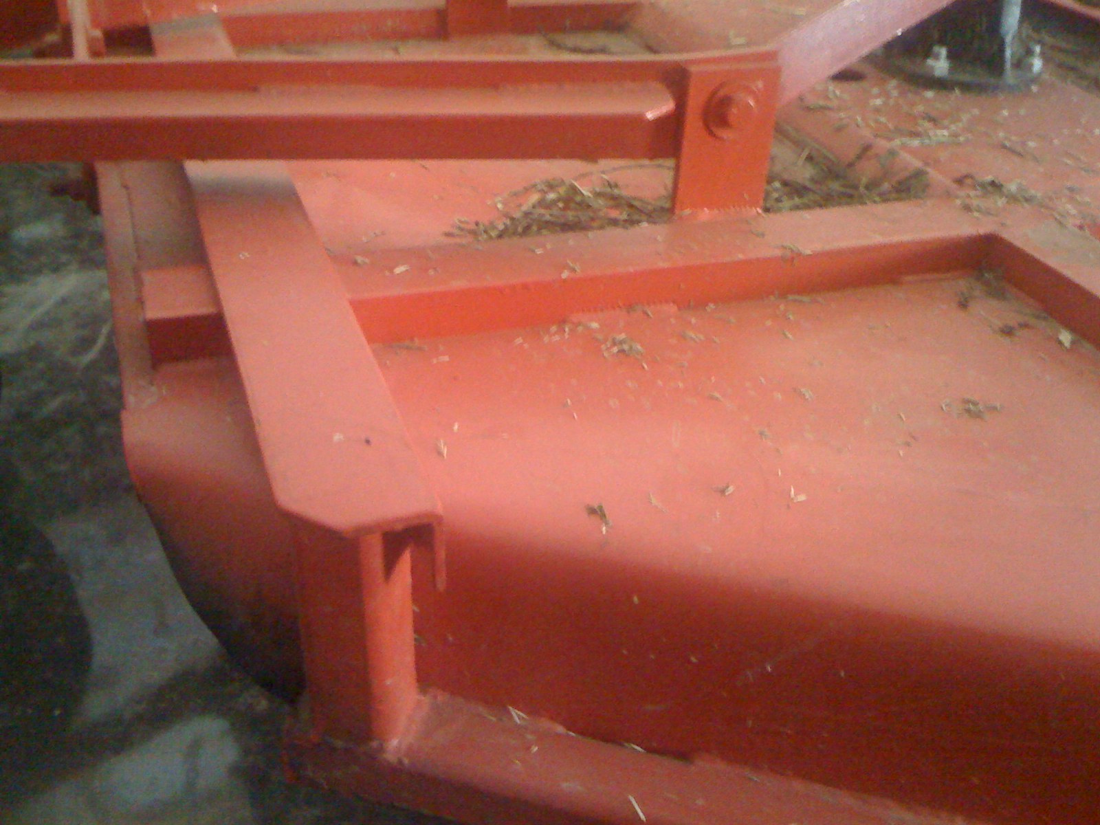

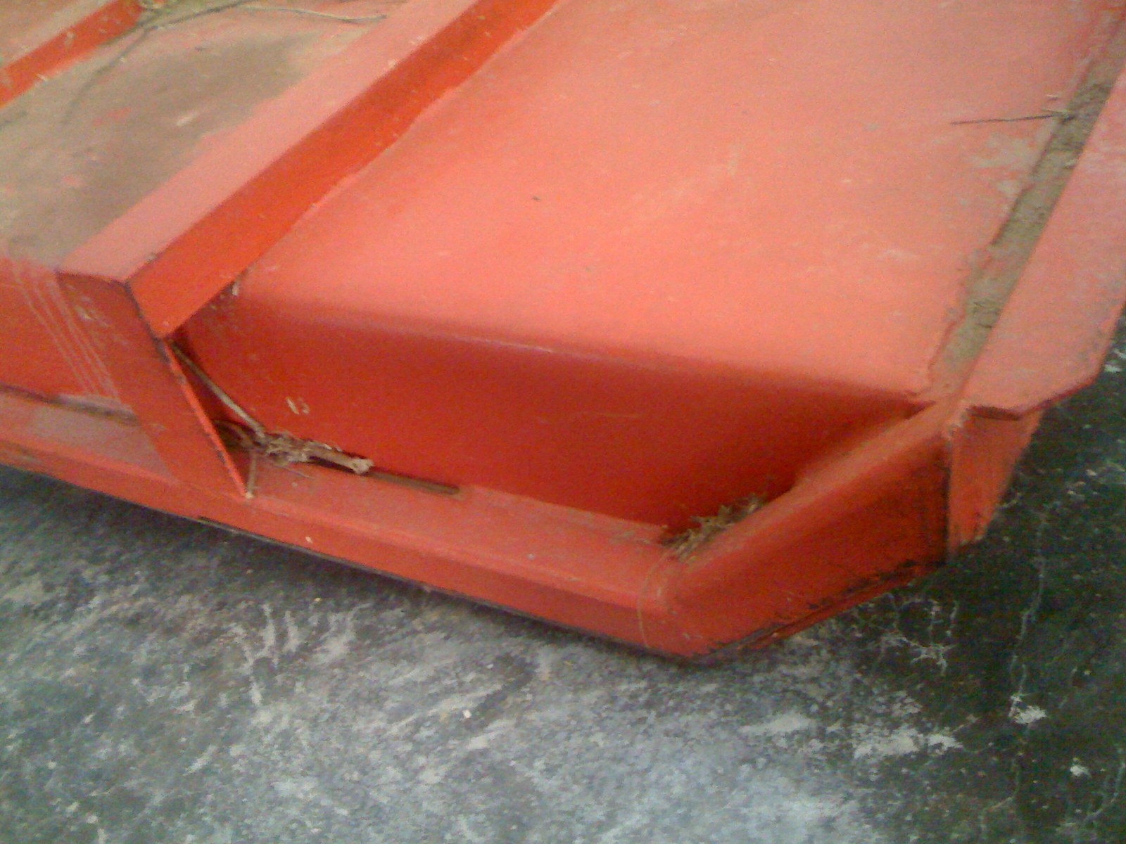

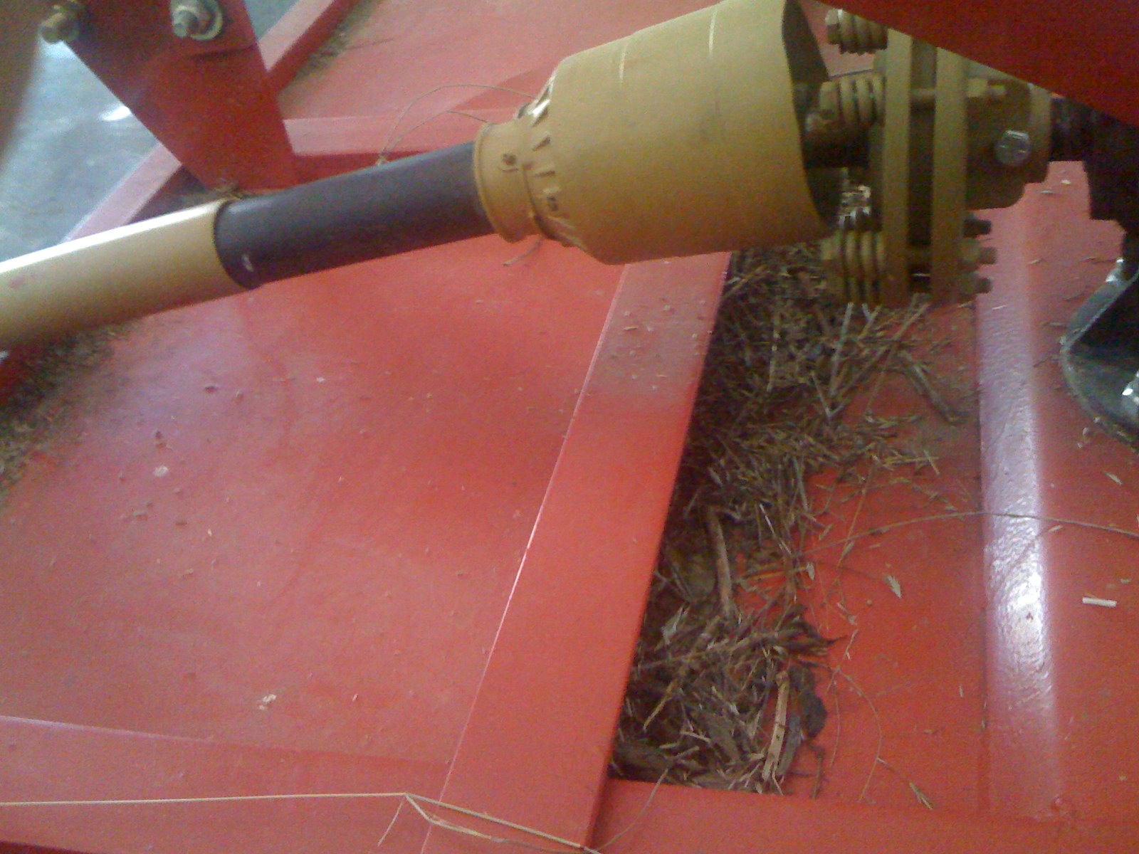

Well, before you told me that my idea of a heavy duty cutter was over-kill. Although I couldn't see spending the money for what I could build, here is what you said of Brown; the strongest commercially made rotary cutter I've personally seen.
Farmwithjunk said:
The Brown mower line is a niche market product. Unless you NEED that super heavy duty mower, the weight is a liability for general use. They're especially popular with land clearing/extreme rough mowing conditions commercial mowing operators, but the average run-of-the-mill end user just doesn't need that sort of mower. On a "per foot width" basis, it takes a LOT more tractor to handle one of these mowers than say a Bush Hog 200 or 300 series. I have a Bush Hog 406, which is their answer to the Brown mowers. At 6', it takes an 8000 lb (+) tractor to handle it (safely) on rough ground. When you consider the cost vs. job requirements, 99.9% of the time, a mower of that duty rating wouldn't be the "right mower for the job".
All depends on what you'll be doing and which tractor you'll be hanging the mower on.
This 7' cutter started life off as a left over unit at either Rural King or TSC (it's been so long I forget) that the store manager sold to me on the cheap because it was going into winter and the paint was faded along with a lot of surface rust. If my old fading memory serves me correctly, I paid something like $575 or $595 for it. I pretty well smoked the gear box on it the first summer using it on the couple hundred acre lot I have that is "un-improved" to put it mildly. Hmm, I shoulda noticed that the gearbox was rated for 40 PTO hp and I was using a tractor with at least 70 PTO hp. I guess the shear bolt didn't shear fast enough. :eek:
Anyway, over the next winter I took most of it apart and though I could build a better mousetrap. I bought a new (well, new to me anyway) 90 hp gearbox on ebay several years ago that was sold without any reserve. I think I paid about $125 for it. I can't read the name, but I can make out that it was made in Italy. I figured as heavy as it was, it had to be worth that. I did have to take it apart and clean it up but it worked fine. I also came across a deal for a PTO slip clutch that mounted to the gearbox on eBay as well. I think I paid almost as much for that as I did the gearbox, but it was new. I had a lot of scrap steel around the shop but needed more 3/16" sheet for the decking and bought it for scrap price from a local steel company. So, besides my time, I now have about a thousand bucks in my 7' cutter.
My cutter has 3/16" decking on it, a frame made of 3/8" wall 2"X2" square tubing (yeah, very, very heavy but I had it laying around) and 3"X4" 1/4" angle. I picked up a set of 1" blades from a small roadside implement shop that was going out of business as well for it, but I don't recall what I gave for them. Anyway, I use it as a battering ram and always chop up anything an 8k to 10k tractor will run over. It ain't pretty and it doesn't have any fancy name to it, but I feel it is right up there with the Brown cutters that would have cost me 6k or more. Here's some pictures of 'Ugly Red". I either beat the paint off it about every year or wear it off so I just use a brush and some MF red implement paint from Rural King to paint it before I put it up for the winters. So, for around a grand, I have a 7' cutter that most people consider over-kill. So, for me, it's definitely the right mower and it cost me around a grand or so total. I've hit all sorts of things with it before and have even broken one of the 1" thick blades. The worst thing I ever hit was a dead deer laying in the tall brush rotting on a 95 degree day. It definitely didn't hurt the mower, but man, was that ever nasty!!
