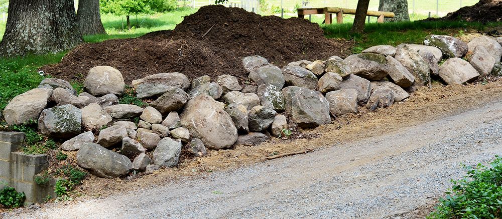

I started dry stacking a "Retaining" wall from field stone... it is about 4' high at the deepest part of the ravine... that was in 2003 and so far not a stone has moved... it curves slightly in and tilts slightly in for stability.
I wish it would be about 3' to the right but no way am I going to move all those rocks again... and I was younger then!

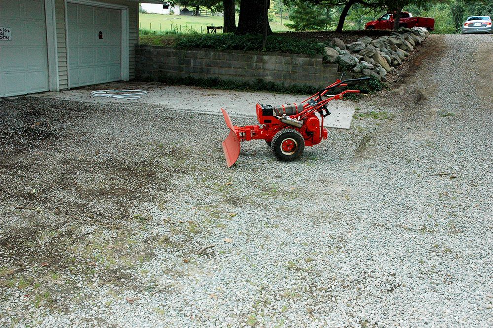

My wife tried to plant shrubs along the driveway,, but, that big tree sucked up all the moisture, and nutrients,,,
After 20 years, she finally agreed, the shrubs were not going to grow,, :confused:
The rocks seem to be doing much better than the shrubs,,, :thumbsup:
I probably have over 100 tons of rocks on my wooded land,, It is just a matter of going and getting them.

The wife and I just finished this dry stacked wall around the top of our driveway. We used a lot of heavy rocks... An old chimney put together with clay for mortar was the source of many of these stones. You can see some of the black on them.photo (8).JPG
