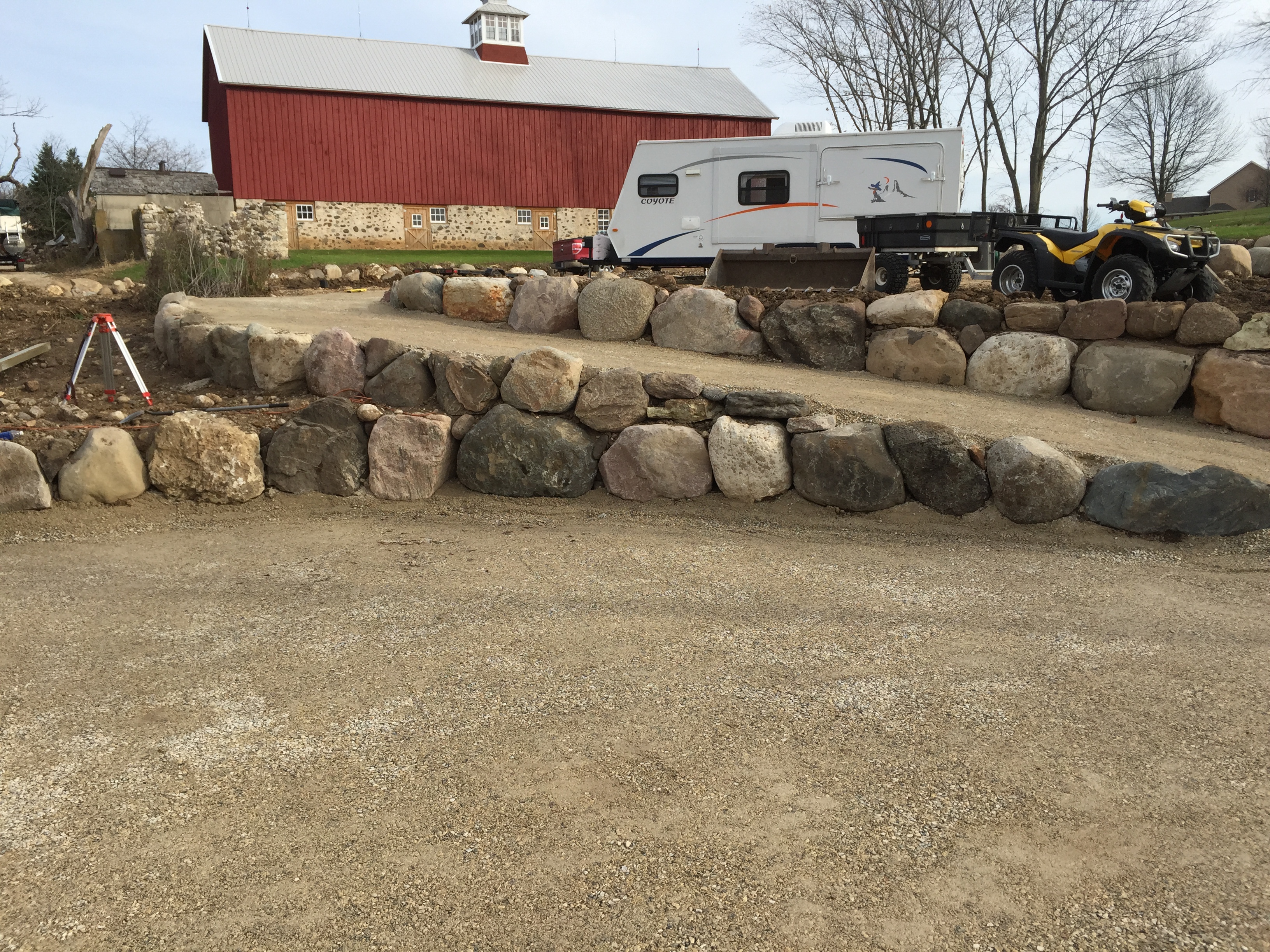

We've built a couple of rock walls at our with pretty good results. I will say that I've learned a few lessons in the process as well. There is definitely a difference between a bunch of rocks piled up and a wall. You need the front face to align with the stone next to it and form the plane of the wall. The rocks also need to be turned so they fit tightly together. Finally, use smaller rocks to establish the top of wall so it follows the grade. Here is a wall the mrs and I built. This one was a bit tricky because I had to build it from above so I couldn't see where the rock was landing.

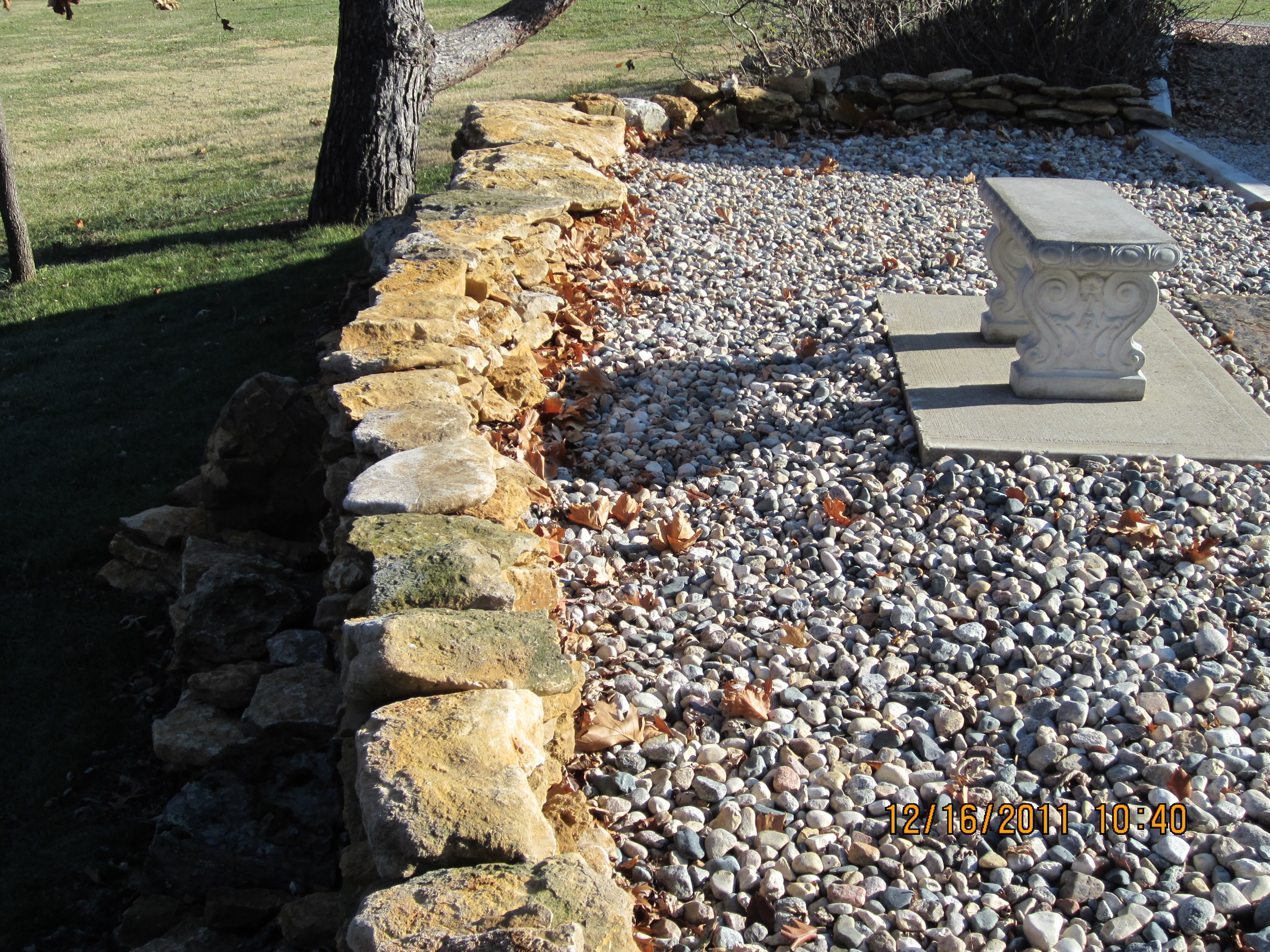

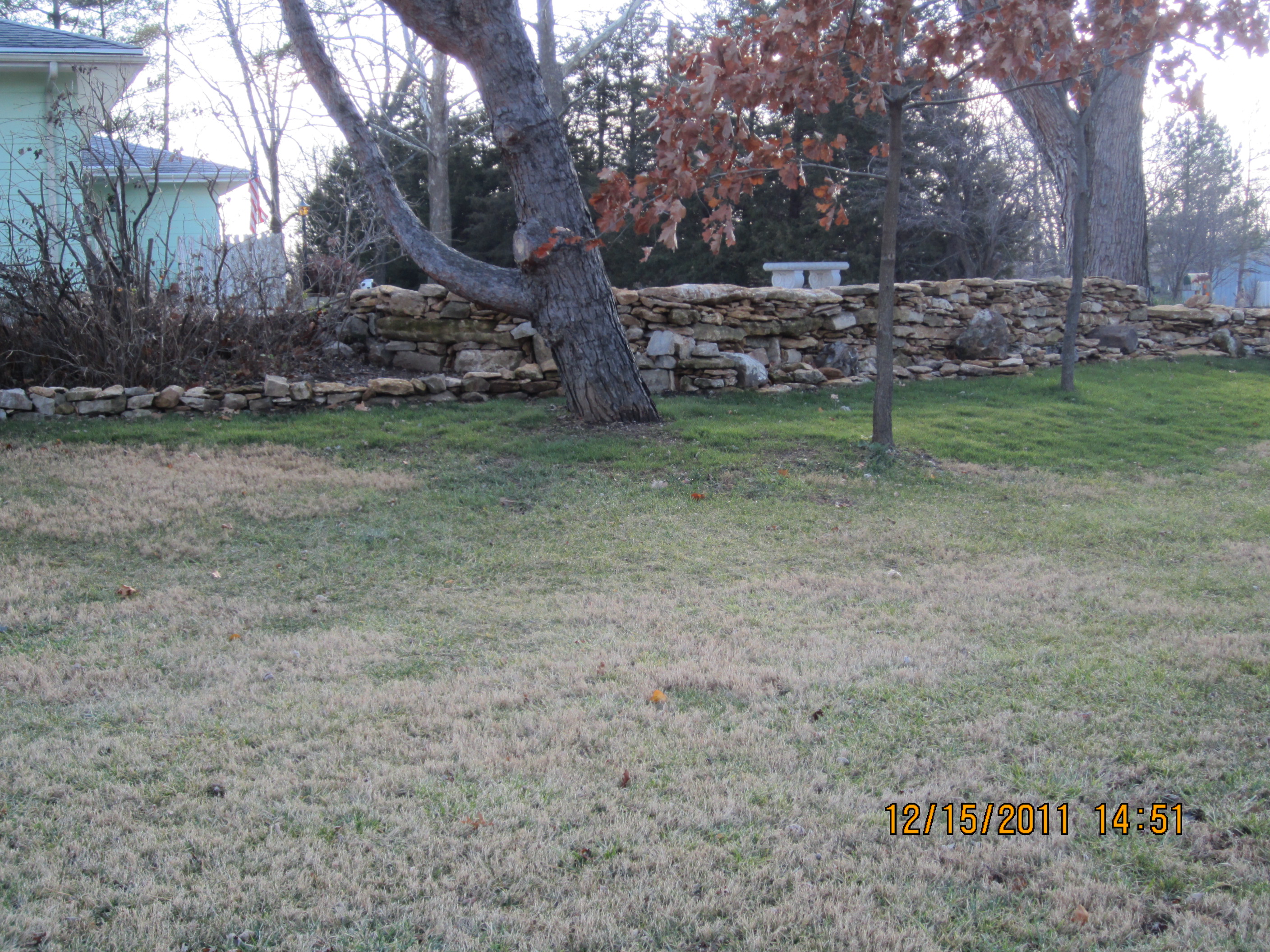

I built a dry wall out of native stone using a BX2660 without a backhoe. Some of the stones were bigger than the FEL bucket. It is tapered with some loose rip rap down low behind it.020.JPG016.JPG
Definitely much like what we're planning to do on ours. I need to stack them staggered above the bottom row since I have to go up at least 3-4'. I will need a thumb though on the BH since the rocks are way too heavy to lift on top of each other. I'm still digging though (only have a day if it's not raining here in CT a weekend), so it's a slow going project.
