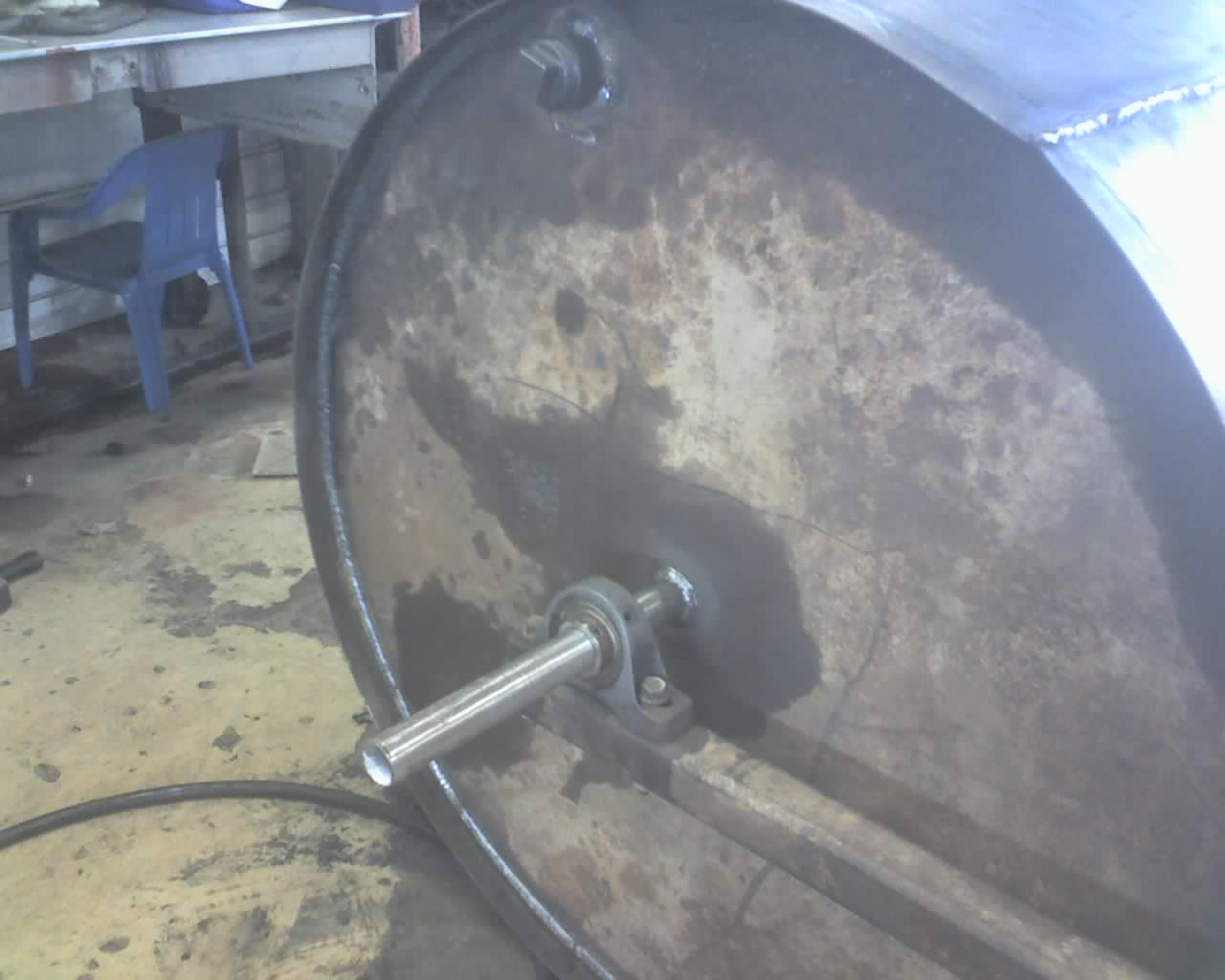

I vote or the solid shaft thru the tank and a pillowblock on each end.
Allthough I'd go up to a 1-1/2" shaft given the weight and application. all you have to do is drill a 1-1/2" hole in the middle of each end cap, and shove the rod through. That would probabally be the hardest part right there.
But the take itself is pleanty thick and strong enough regardless of the nay-sayers. You posted the specs right there. 1/4" wall thickness and 5/16 end-cap thickess.
Then use some 1-1/2" pillowblocks:thumbsup: The bearings shouldnt cost more than $20 each online and visit your local steel supplier for the round rod. BUt I am just guessing, but I dont think it will cost more than $100.

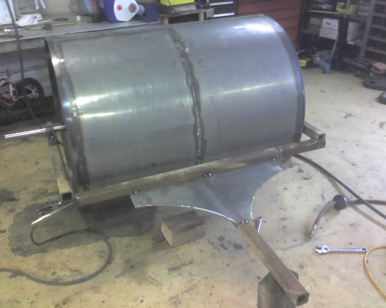

Here is one we did to give you an idea of the hitch set-up and bearings. It holds 225 gallons and weighs ~700lbs empty:thumbsup:
EDIT: we did cut the shafts down to length when done so they dont actually stick out like show in the pics

End of story, done! Looks nice. I borrow my dads every year and it looks like its been through a war due to the rocks, an occasional tack on the seam and its ready for another season. His has a stub on each side going through a 5/16 plate with a hole in it , and his roller has been around forever, hows that for cheap, smear it with some grease and go! Turtles pass me, so how fast you really need to go.
