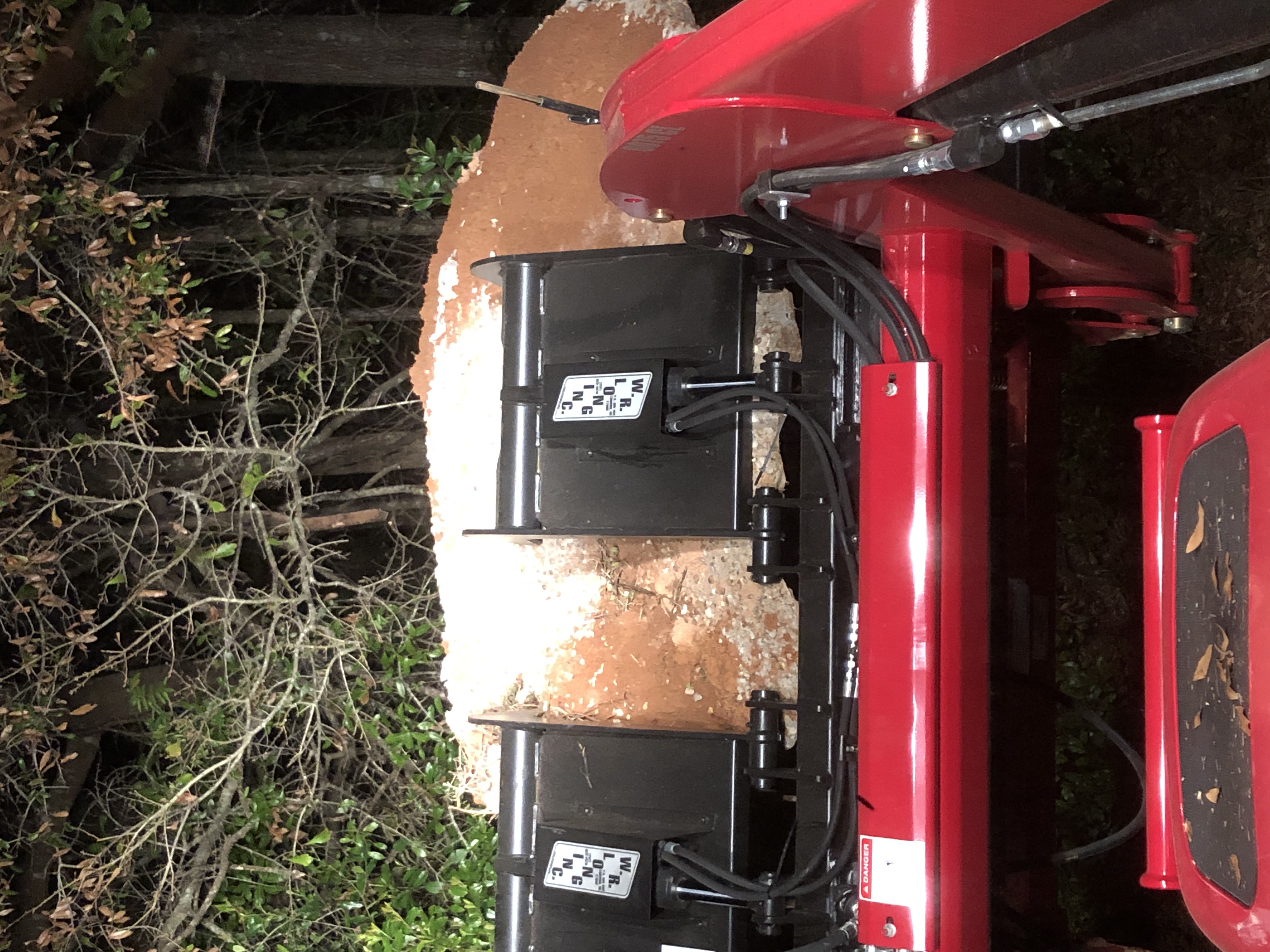

We had a true third function kit installed for use with our plow, I'm not sure on the price but it wasn't $3000.00.

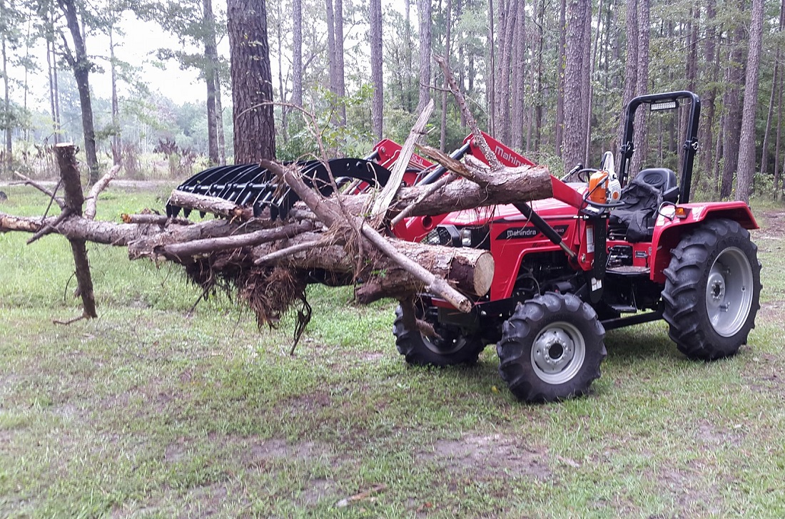

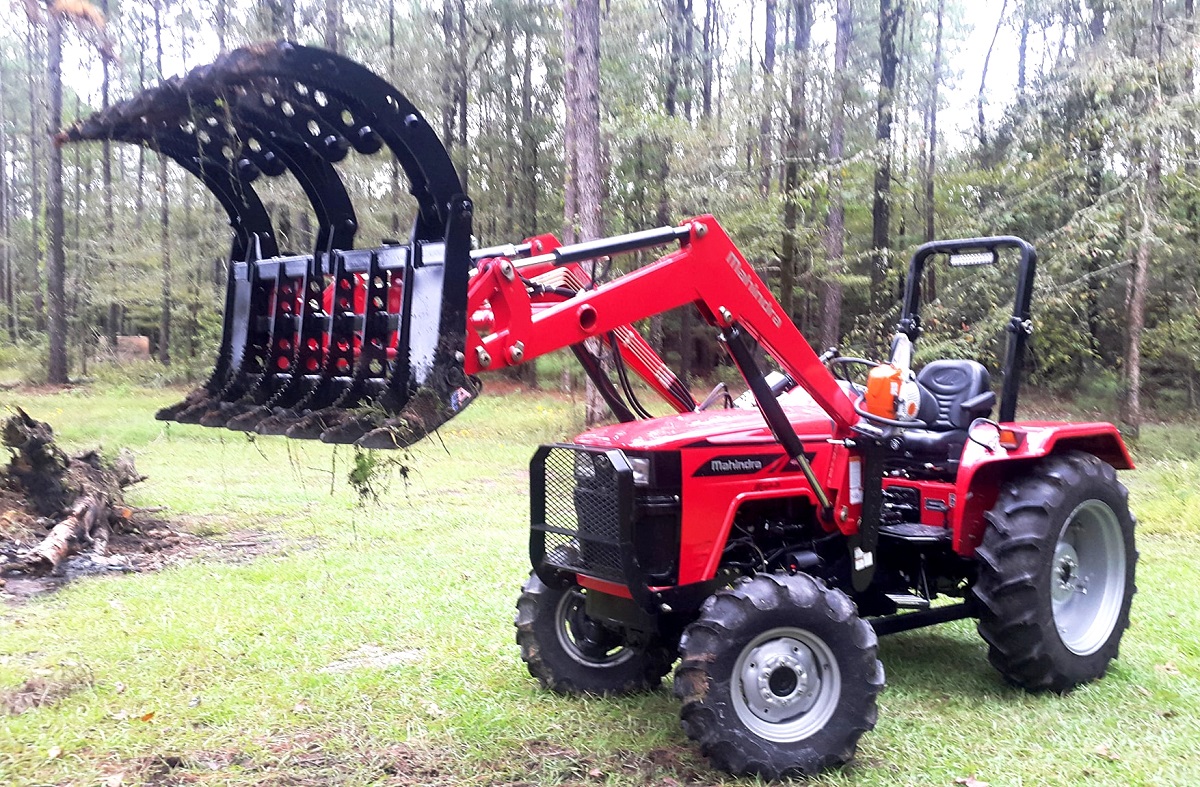

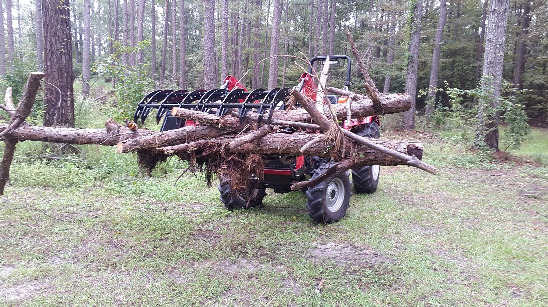

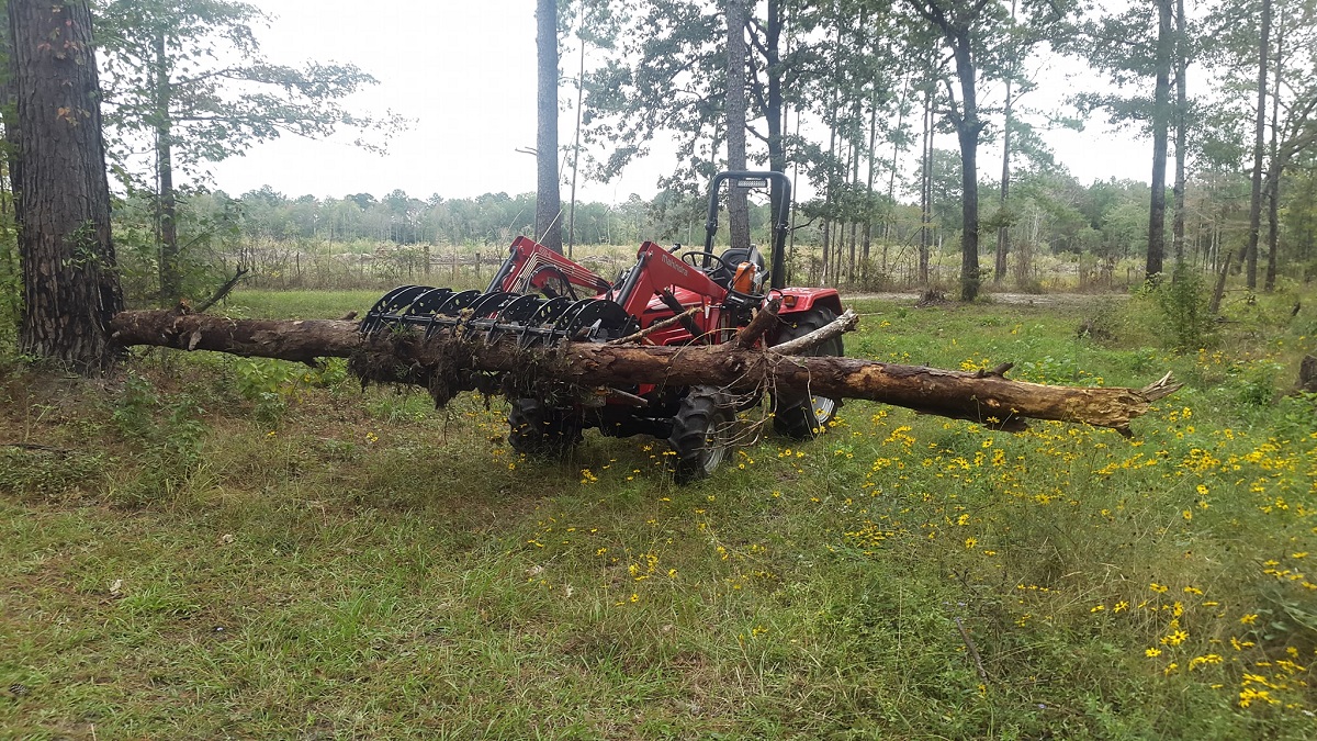

These are from Carol in the EA Channel Group!
Man, this thing is so Wicked NASTY!!!
Travis
Multiple and off balanced objects/logs is no problem and the load stays close. #Ideal
