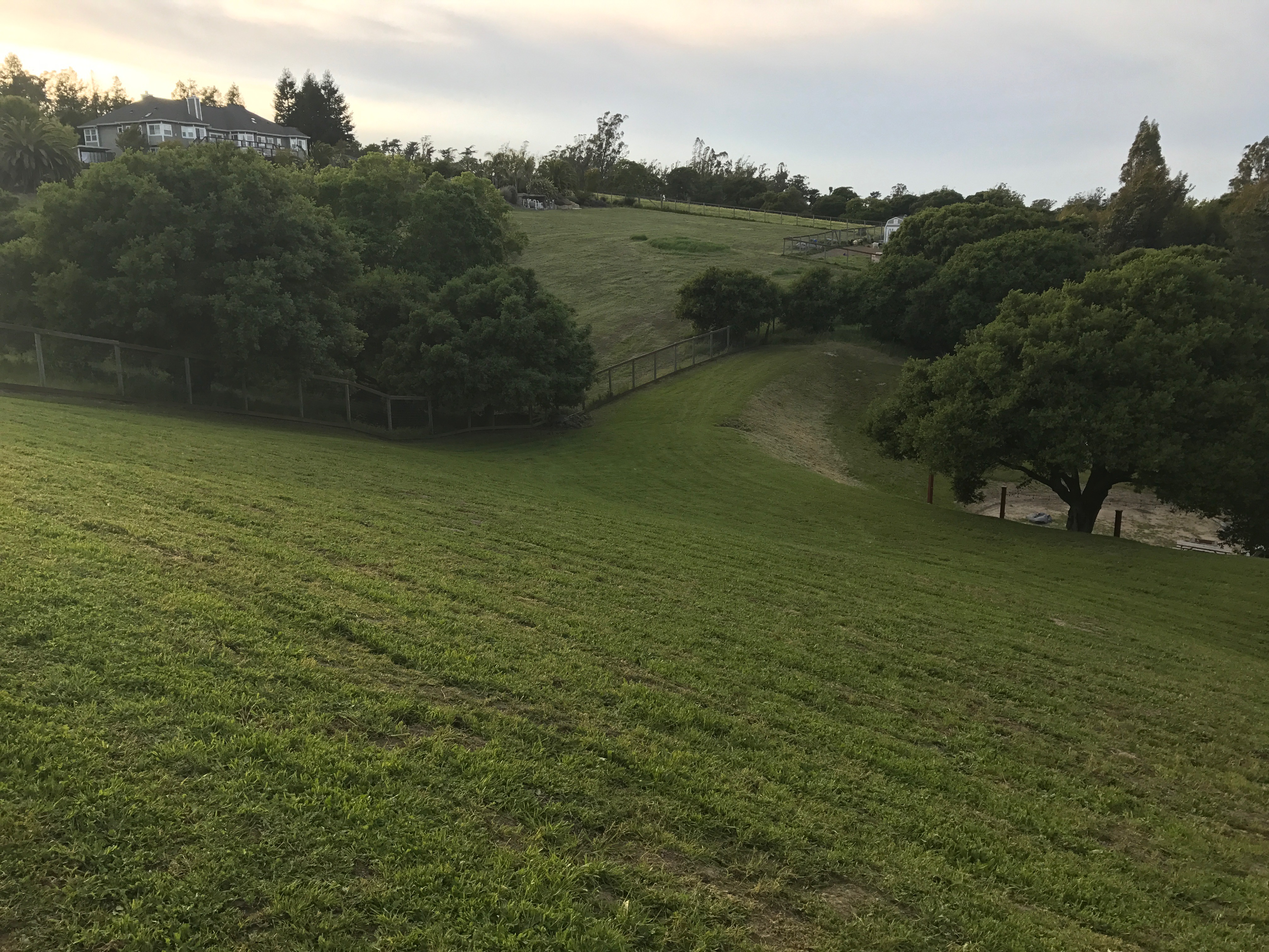

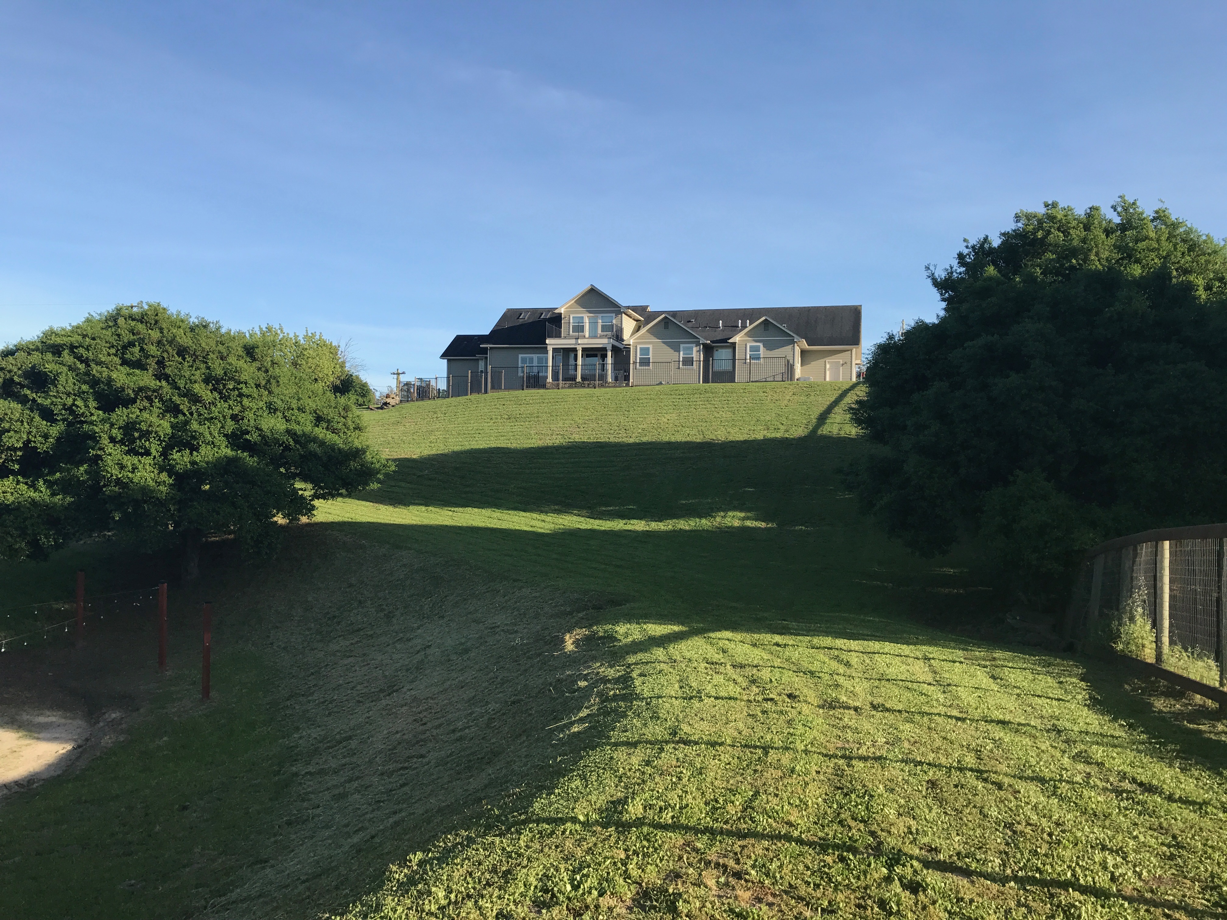

There's a picture below of the biggest part. Not the toughest, but the largest hill I have to mow. It's pretty steep. I have the seat switch jumped so that I can lean when side hilling. In 14 years, I've never even come close to tipping, though, it is always a possibility. What I'd like is some recommendations and/or validation to some of the tractors I'm considering.

I can't recommend a mower but I have to ask what kind of grass that is and if you water it. It's far nicer than my lawn.
It's not even grass. It's just weeds. Looks great in the pic, but if you get up close, not so much. That hillside is my leach field, so it grows year round. I do not and have never watered it. The pics are from spring.
