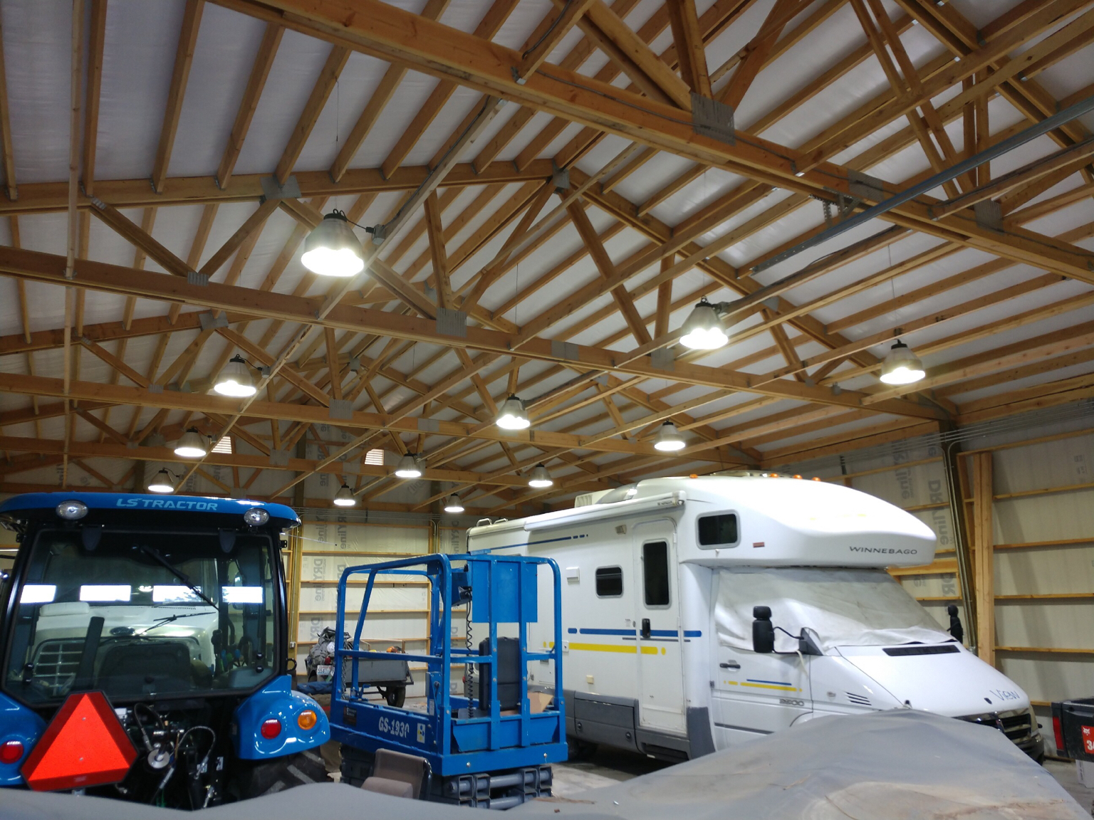

Hi,
Just joined the forum & have been reading the BIY section. I know that this is an old thread, in case someone is searching for info in the future, I thought I'd share my experience. I bought an 8-pack of 8' LED strips similar to the ones linked earlier, but rated at 14,400LM each. Cost in early 2020 was around $170. I replaced 4 175W high bay metal halides with 4 of the LED strips, in a 48' X50' aircraft hangar. The LEDs are quite a bit brighter than the MH were, and the light coverage is much more even (the old MHs tended to 'cone', leaving significant areas relatively dark. When a double 8' high output fluorescent in my work room died, I replaced it with one of these strips, with a significant increase in brightness.
Note that if accurate color rendition is really important to you, you'll probably need to pay a lot more for lights. But for me, these lights are more than adequate for doing any kind of work short of critical finish painting.
I gave one of my spares to my neighbor to replace a fluorescent, and he quickly ordered a full pack to replace the rest of his lights.
FWIW,

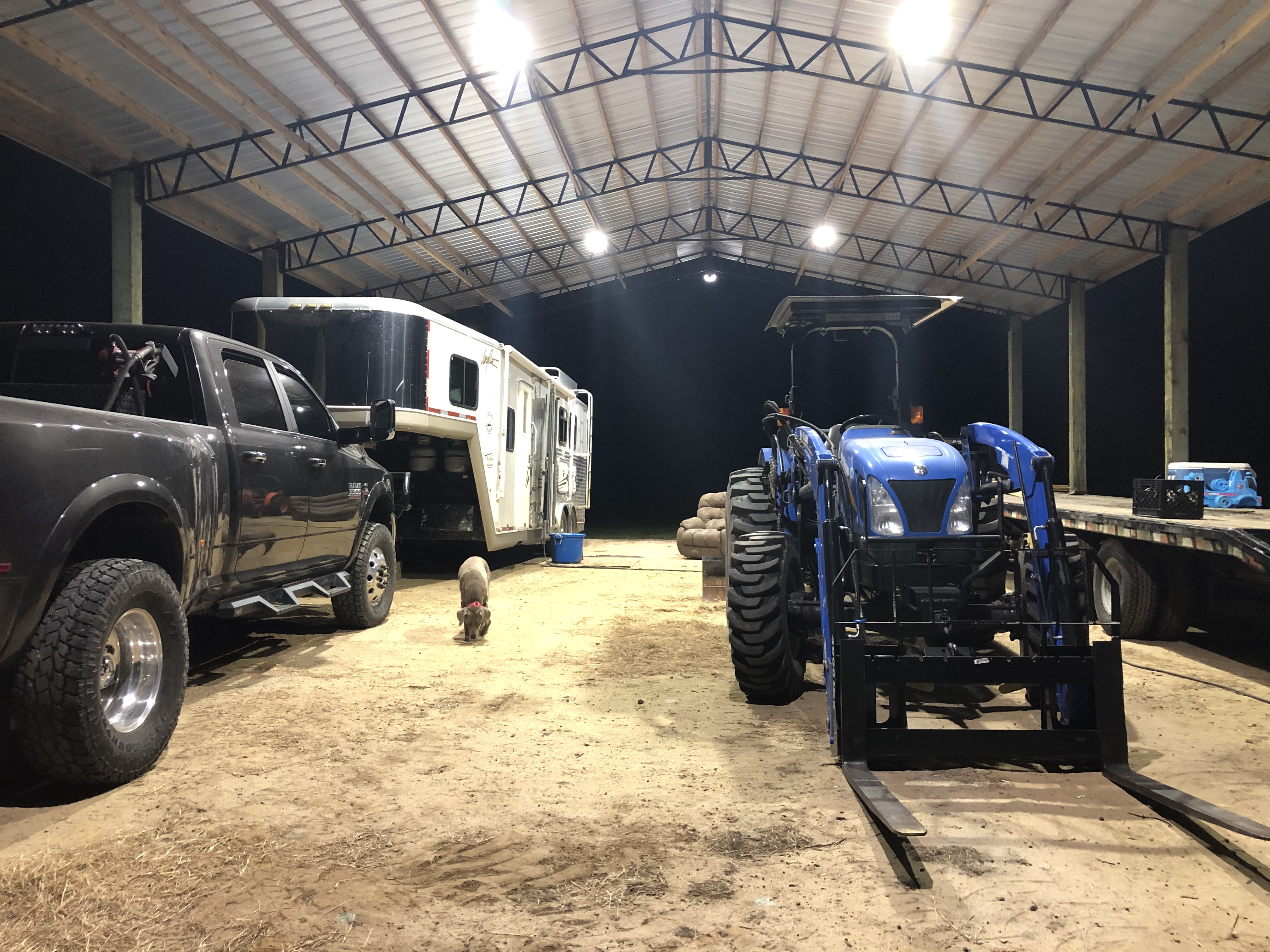

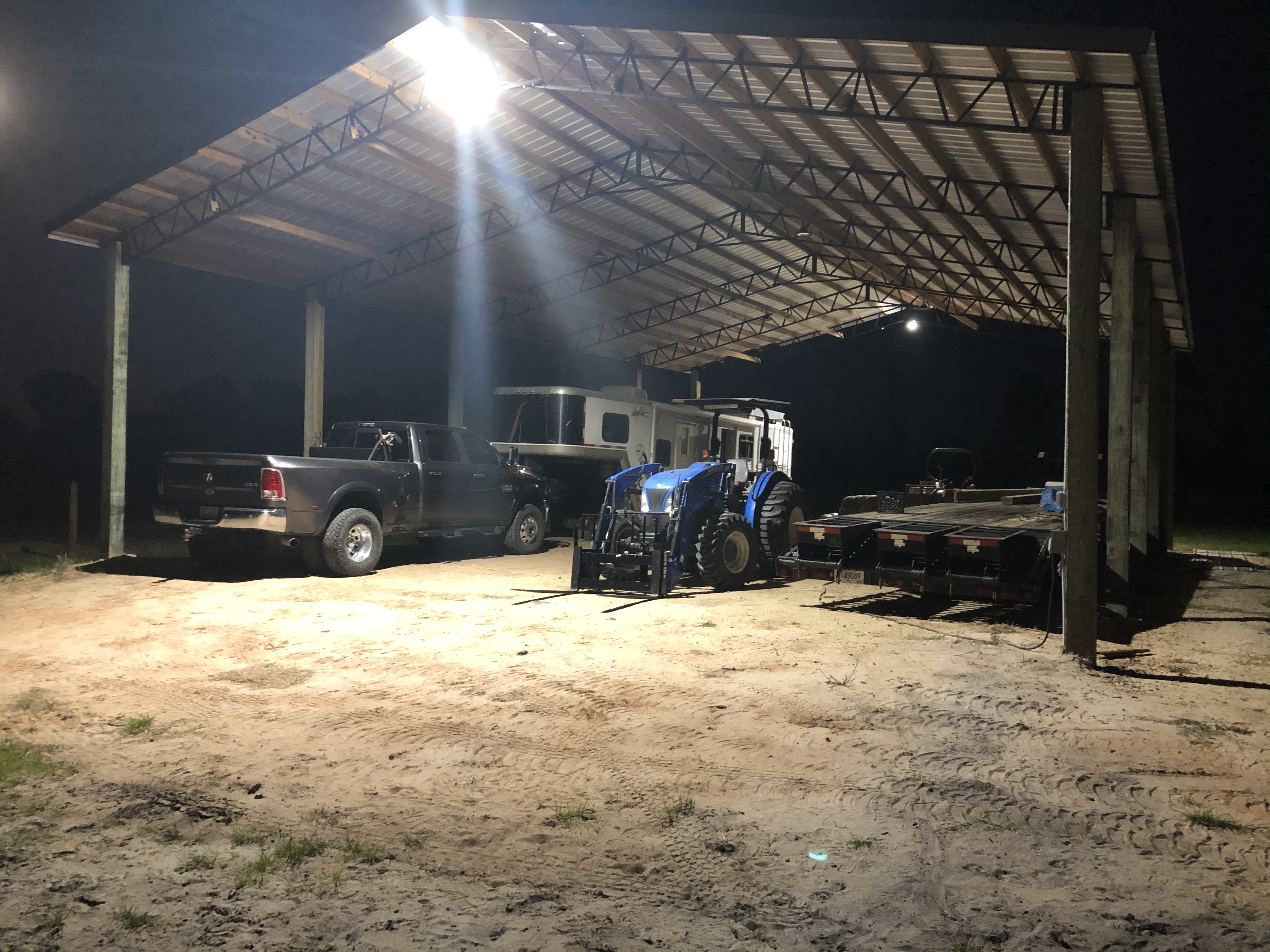

It痴 been awhile but thought I might update this beings I致e had a couples emails since asking what I did. Beings it痴 just a storage barn I chose to not overkill it but wanted enough I didn稚 need more either. We went with 2 100w Dusk/Dawn lights one on each end since we come and go slot at dark with the horse trailer, and 4 100w 15,000 lumen UFO Highbays. Worked out perfect! We have added on with a 22x60 horse barn/lean to on one side so I I ever decided to enclose this some I might would need to add a couple UFO痴 on the outside ends. Beings it痴 still open though the Dusk/Dawn痴 take care of that for now. Added a picture for anyone else reading this. Oh and thank y誕ll for the help!
