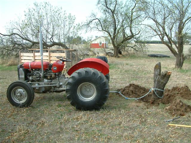

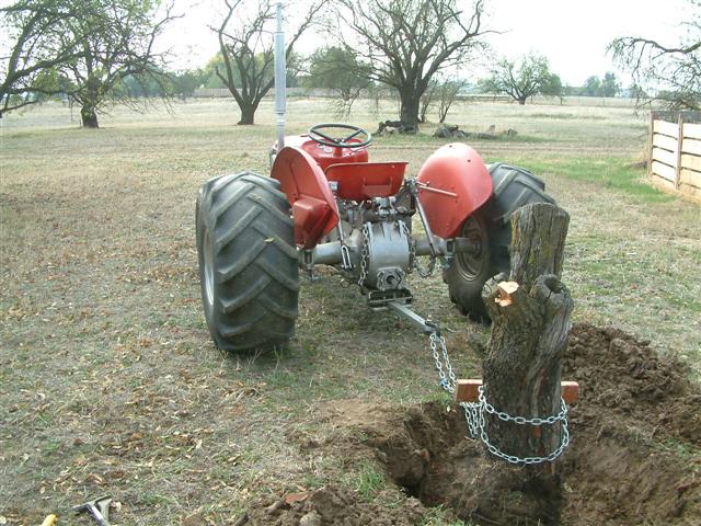

I don't have any slopes on my 10 acres of flat pasture, but if I did, I'd use my 1964 MF135 diesel to mow them
There's no substitute for low center of gravity and wide wheel track when tackling slopes.
Good luck. Just be careful out there.
