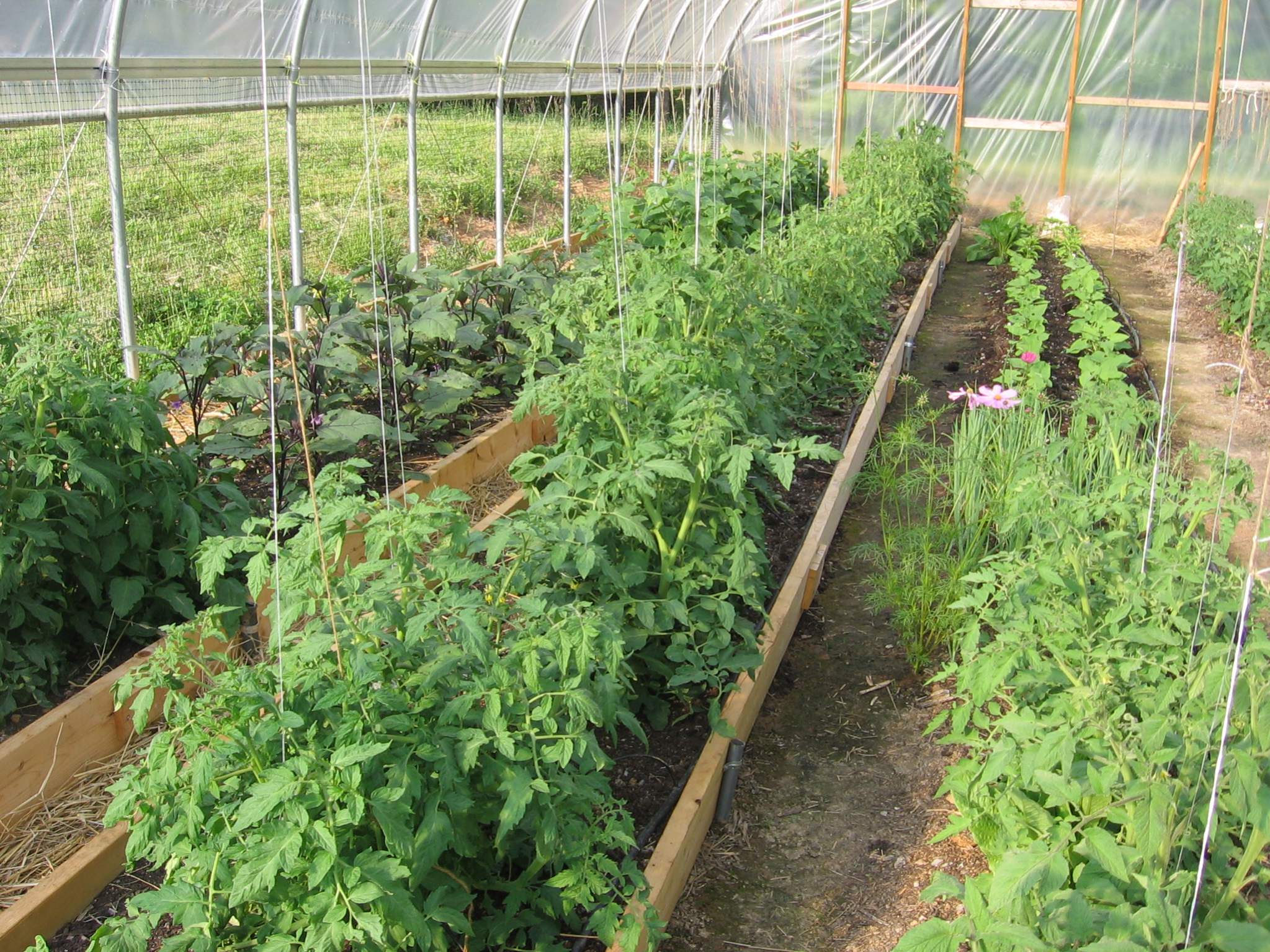

IMG_6474.jpg24" is very deep. i used untreated 2x8's filled with compost.
