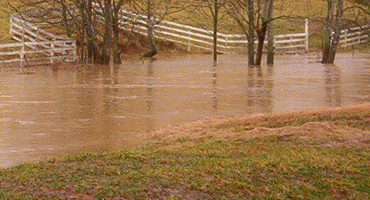

Well, it's been raining the past two days, and now the water is across my driveway AND the neighbor's driveway. I would take a new picture of it, but it's dark out right now.
As Johnny Cash once said, "How high is the water mama?"
During the first two years I owned the property, the water was NEVER more than a 15 foot radius going around the willow tree. Since this past summer, it keeps getting bigger and bigger. It's over 160 feet across right now! At this point last year, I was driving the tractor across there!
5030 Daryl said a couple of hours ago that the snow is headed my way. That's the only thing to my advantage right now-- until it melts, that is... /forums/images/graemlins/frown.gif
Hopefully, I don't get flooded out before I start working on it this spring!

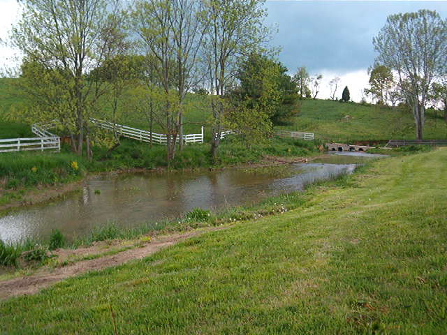

Brother, I have to agree with you; the weather is way out of whack. I have been told we are 25 inches over normal this past year. You can see from some of my posts that water is my biggest trouble with my property. I have done a great deal to remedy some problems and have many more projects to help with other water problems. I know that as soon as I get all this work completed; then we will have a 10 year drought. I still think a pond will help you. As you have stated this is the lowest spot, so you have no where to put the water. Building a pond will give you a deeper place to manage the water and it will look good most of the time. Yes, you may have it come out of the banks after the monsoon rains we have been having; however, it will get soaked up and evaporate back into the banks of the pond. As of now you have an eyesore; with a pond it will look pretty and somewhat natural, at least a majority of the year. With that being the lowest spot in the area then you really have no choices other than buying a big tanker truck, pumping the water in the tank and hauling it off every time it rains. /forums/images/graemlins/shocked.gif

25 inches-- that sounds about right, judging by the depth of the hole!
I've pretty much decided to dig it out a little and use the dirt to build up the sides to help hold things back when it overflows. Maybe I'll have a better idea by then though! /forums/images/graemlins/grin.gif

Can you dig a trench from the pond to the road ditch? Is the road ditch bottom lower than the pond? Someone said the county does not want residents pumping water into a road ditch.. is there a difference between running a trench to it vs. pumping water into it?
   / Need advice on Springtime project (long) #27
Theoretically, if the water is 160 feet across and about 3" deep, then you could fit it all in a pond about 15 feet across and 3 feet deep. The point is by taking measurements as you have you can determine the volume of the pond you need to contain the water so that overflow is not an issue except every 10 years or so. Even then if you design the pond with sloping sides, it will just get bigger in the worst years and not be a problem.

Nope, the lowest point in my road ditch is still higher than the water level. Running a trench to the road was my first idea. /forums/images/graemlins/frown.gif
As Junkman pointed out, the road in front of my property is at the top of a slight crest. It goes slightly downhill in front of each of my neighbors' properties. To keep the water flowing in the ditch, the county has made the ditch in front of my house only about a foot deep. It starts getting deeper the further you go down the road.
To make things more interesting, the ditch on the OTHER side of the road is about 30 inches deep. Too bad I just can't run a pipe under the road! /forums/images/graemlins/shocked.gif /forums/images/graemlins/frown.gif

That's good advice about figuring in the volume of the water that's currently there.
Hopefully, it will never be this wet again. /forums/images/graemlins/crazy.gif Some of my neighbors have said they have never seen it look like that ever before! As an interesting point, the water is probably over two feet deep right now in the center by the tree. That's a lot of water!
