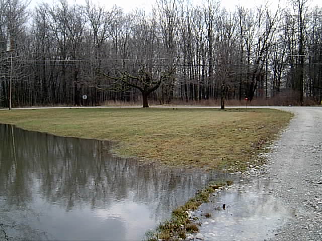

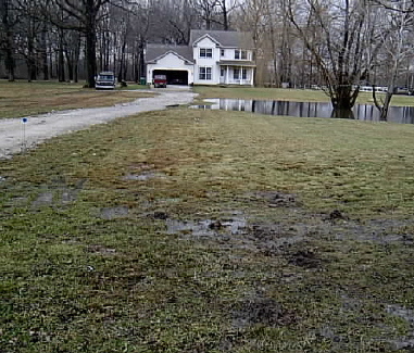

Just to give a little more info--
The driveway on the left side of the photos belongs to my neighbors, and after the rain we had yesterday morning, the water goes right up to their driveway right now. The neighbors commented today that it is the wetest they have ever seen that spot. I said I'm trying to figure out how to fix it.
Also, even though I had the house built a little higher than everything else around, the property slopes back down out back behind the house to a level that its about the same as the level of the road shown in the front of the photos. The spot where the willow tree is the lowest point on the property. The majority of my land is the same as the road level.
Since that is the LOWEST point on the property, I'm pretty sure the rain and snow is ALWAYS going to go to that spot. Even if I fill it in some, it still isn't going to bring it up to the level of the road ditch for it to flow there. So, I need to figure out a good way to make it drain. If the willow tree needs to go, then so be it, but at least it would dry things up. If I can keep the tree, that would be better, but I need to dry up the yard.
Hopefully, that clears things up on what I can do and what I can't do with it. The best case would be to have a small pond around the willow, but if we get a winter and spring with lots of snow and rain, the overflow has to go somewhere, and the driveways will flood WAY before it would get high enough to get to the road ditch.
So either way, I would have to pump water uphill, whether I went to the road ditch with it or made a pond out back farther behind the house. With all of the strikes I've got going against me, what can I easily do? Is there a simpler way to dry things up that I'm missing?
There's several people here within an hour's drive from me. If anyone's ever going to be in the neighborhood, send me a PM and you can check things out in person! /forums/images/graemlins/shocked.gif
One more thing to consider-- My electric and phone lines run underground from the pole at the road to the house, right through the low spot. It wasn't that wet when they put it in!
   / Need advice on Springtime project (long) #17
Andy.... You are getting more than the run off from your land, you are also getting run off from the road in front of your land. I have studied the 3 pictures and come to the belief that the sub soil is of a clay based nature. Given that it doesn't percolate into the ground after a couple of days leaves you with no alternative to move the water to another location. In many jurisdictions, it is not legal to pump water into the drainage ditch alongside of the road. I suggest that you contact the county engineers office and ask them for suggestions. Part of the problem is the roadway drainage is coming onto your property. They may have a solution for the problem, but I don't see one being a pond. At a certain point, it will fill and not be able to hold any more water and then you are back having the same problem.
It may be an optical allusion, but it appears that there is a crown to the road in the middle of your lot and that the right and left sides are lower than the middle. I have dealt with drainage problems in the past and the one thing that I know.... water seeks the lowest point and then it goes into the ground. If it can't percolate, then it just becomes stagnant. This is the problem as I see it. Without knowing the rest of the topography, I can't make any other suggestions.... By the way, if you get rid of the willow tree, the problem will become further exasperated. Willows can absorb up to 400 gallons a water a day under the right conditions....

You are very obvervant. All of my ground is a very heavy clay. Here's a picture taken from the road, showing how the water runs away from the house and away from the road also. The ground level at the house is approximately the same as the level of the road. On the plus side of things, it's good that I do have the water flowing away from the house and keeping things dry, I just wish it had somewhere to go.
As of right now, the water is higher than it's ever been since we've owned the property, however, there is NO spot on the 3.6 acres that is lower than the water level, including the road ditch.
Also, it's 62 degrees and raining, further adding to the problem. Is the weather out of wack or what? /forums/images/graemlins/confused.gif

One last picture. This is an upclose shot showing the contour of the ground from the low spot going toward the road. As you can see in the picture, the ditch at the road is too high to drain the water to without pumping it upward and there is no part of the property lower than the water level.
The water runoff is always going to run to this spot. If I make it a pond, where do I run the overflow to, since there is no spot on the property lower than this water level?
