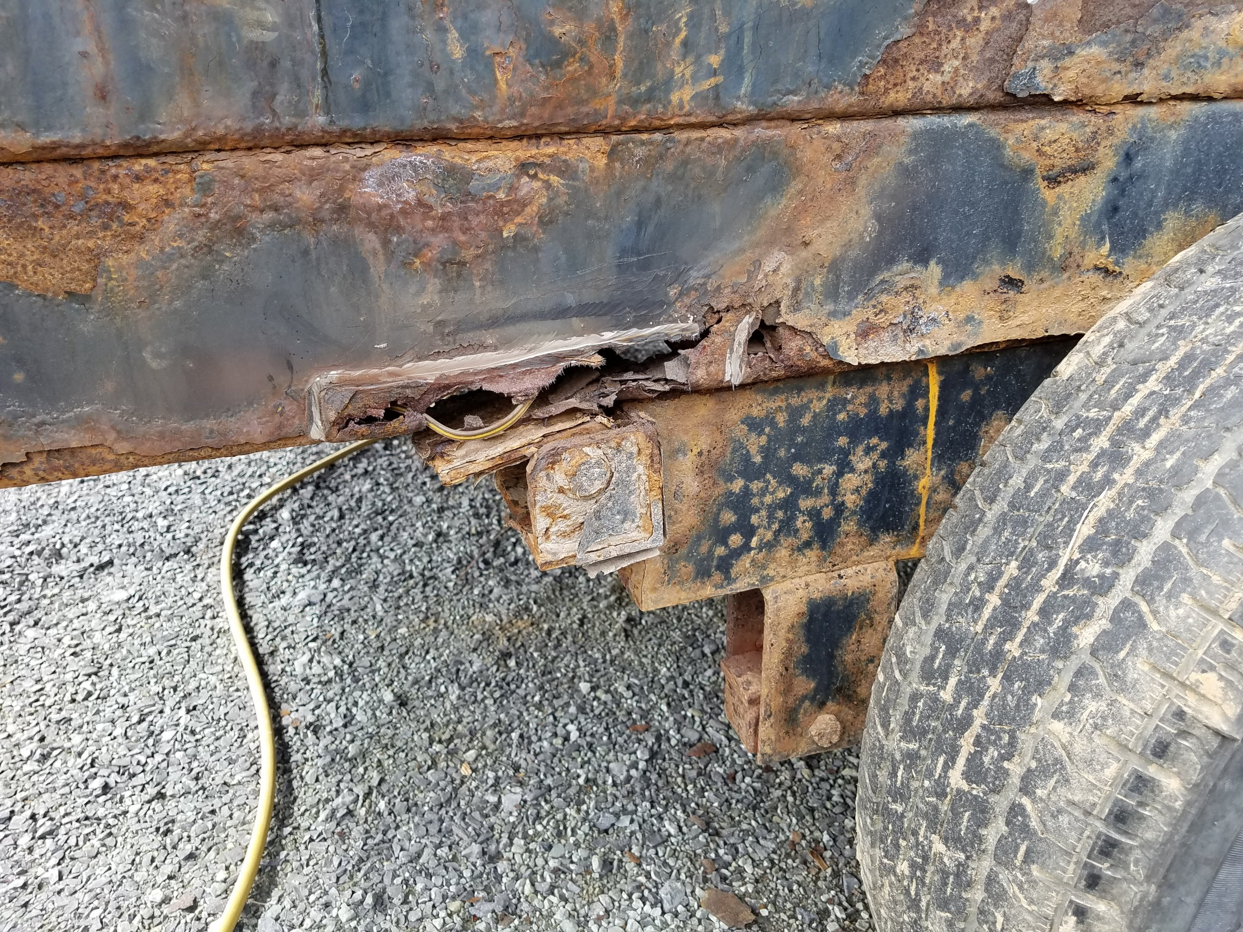

One other thing to consider if you live in Maine. Will you use in in winter. Salt will destroy the powder coat in 2 years. Look up Diamond-C trailers and see how they prep trailers for coatings. Buy one that is prepped like diamond-C. I bought an Alabama built trailer in 06 and most of the powder coat was blown off within 2 years.
Yes,
This all day long. I am currently completely tearing apart a 2012 10K PJ dump trailer because it was powder coated and made from tubular stock. In fact I would avoid both of those things like the plague. That powder coat looks great until you realize that tiny little crack or chip is holding salt water directly against the metal for years with no way to get it out no matter how much power washing you do.
The tube stock also has no provisions to get the inside completely coated or cleaned out, so once that salt water goes in, it rusts the tube out from the inside and good luck trying to power wash inside the tube through the holes for the wiring... which let the salt spray in just fine.
When replacing these tube sections, I will and am gladly paying the weight and slight strength (in twisting force) penalty and going with C channel. This trailer was used for personal use, not that often during the winter, and was washed after winter outings (as you can see what a whole lot of good that did).... Powder coating... never again... not for the northeast.
Edit: To be clear my powder coat did not "blow off" in fact its still on there requiring a needle scaler to finish blowing it off with a nice thick layer of rusted steel still attached to the powder coat.
Eric
Powder coating is absolutely the worst finish for a trailer.
Manufactures use it because it is quick, and looks great...initially.
