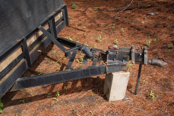

Yes it is surge brakes see photo.
While 8 ply tires may be the preferred tire for 5200 # axle, I do believe it would be the load rating that would decide the loading and not just the plys by them selves. I bow to your rather extensive trailering knowledge, but requiring 8 ply tires for 5200# when some 3500# have 4 ply sounds a bit like overkill for a tire that only needs to support 2600 max load. Granted car tires are not the best for trailers but many of them work just fine with them on.

You guys have convinced me that I should really look at more options on this. After reviewing the photos, I noted that the wrap tongue doesnt go all the way to the fenders like all the trailers I have seen but stops about 2-3 feet from them which looks a little cheapo cost saving to me and weakens the frame considerably. Also with the 6 ply tires it is limited to their capacity regardless of the axle rating. A few other things make me a little nervous in that he couldnt find the title and there is no current license on it (Ark has a permanent plate) so maybe it was never registered or might be some other problem. And then the surge brake issue, just too many issues with it to feel comfortable with. I will just bit the bullet and look for a new one or at least one with all the paperwork and better info on it.

surge brakes are hard on transmissions IMHO. the back and forth, 2 or 3 inches to take up the slack is brutal on the powertrain.
I ruined my f150 trans because of this and it cost me ALOT to fix:mad: I will never own another trailer with surge brakes, electric all the way.. My 20' haulmark had electrics and pulled behind a cummins/ram like she was'nt even there smooth going and smooth stopping:)
/ Need advice quickly one trailer purchase
#17
I never thought about that aspect of it. Really glad I passed on it now. Likely PO'ed the owner but if he hadnt dilly dallied around on delivery I would likely be stuck with it now. Sometimes you get lucky when waiting but I cant say the same for the seller. At least maybe he got the load of trash out of it that was holding him up on the sale.
