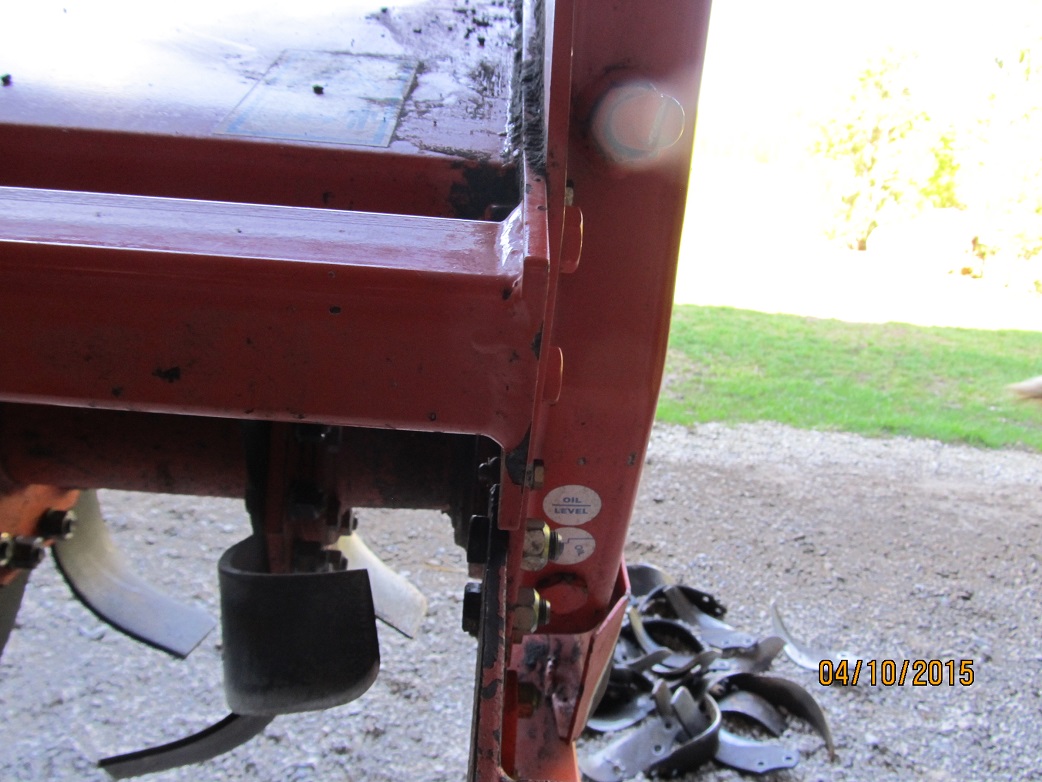

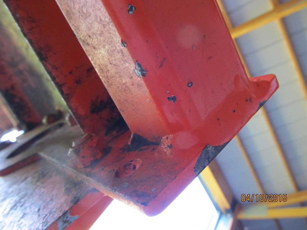

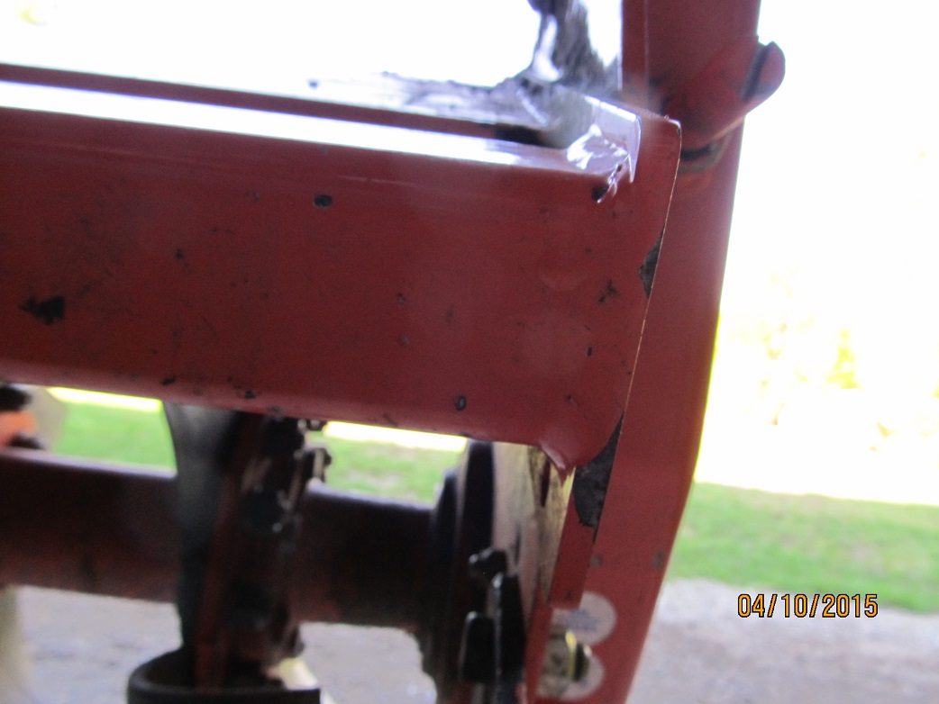

Hey Sixdogs... looks like a great project fixer' upper. Good post.
I'm a novice but my first thoughts, similar as SA's... surprised at the poor quality welds. I also agree with Sodo, it looks seems to be a missed weld... so not only did the guy weld crappy... he didn't even finish. :laughing:
I am not a fan of drain holes if not necessary mainly because somehow they always clog. :D Make it fluid tight unless there is a compelling reason not too. The design/location of the drain hole though should be thought out if you opt for this feature. A seam is not a good design for a drain. 3/8in holes are a minimum in my book... and then you have a little added maintenance regimen. :thumb down: Did I say I didn't like drain holes.

Drain holes from a closed cavity not likely to cause trouble.
   / Need advice welding crack in tiller frame #34
It just always seems they clog... a caterpillar builds a nest neatly in the hole... kid sticks a branch in it...whatever. Maybe it is just my luck?
   / Need advice welding crack in tiller frame #35
As soon as you put a drain hole in a closed cavity, it no longer IS one :rolleyes:... Steve
   / Need advice welding crack in tiller frame #36
If you just weld it solid there is no need for a drain hole. What little moisture and oxygen is in there wont cause much rusting. And being welded solid there is no way for more moisture to enter.

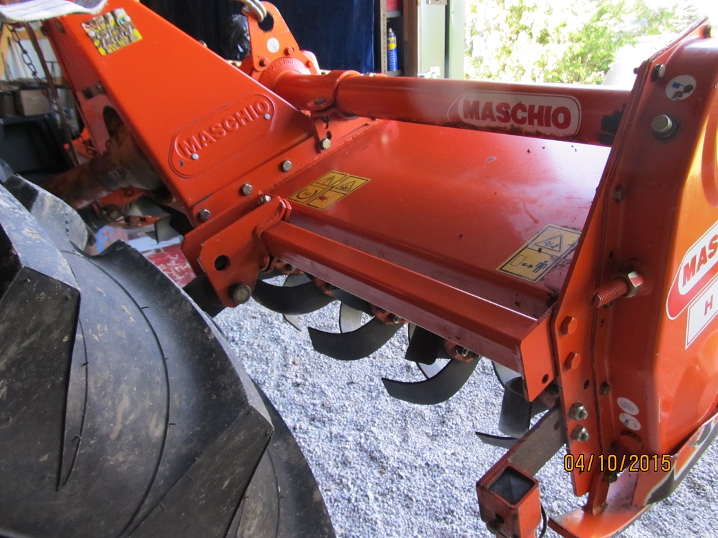

Here are the pictures of the other side as requested. No problems here and weld looks much better than the other side.
   / Need advice welding crack in tiller frame #38
Maschio is one of the best tillers you can buy but I am totally shocked at the poor welding and lack of welding all around. There is no way that tiller should have ever made it past quality control.
