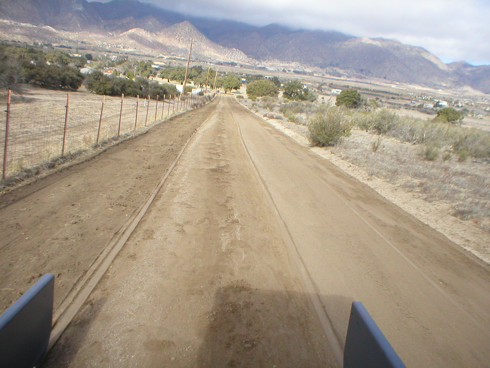

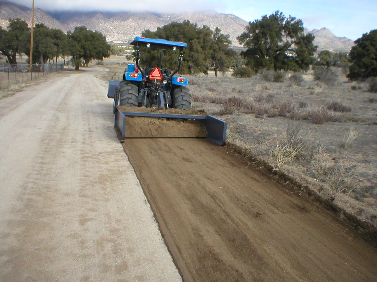

Kieth, all grading is done best with heavy implements as you have stated. the heavier the better as long as the tractor can handle the weight and load that is put on the tractor. There are many implements that work for grading a road, each excels at it's intended purpose as well as having different costs to purchase. I have the 4 most common, a landscape rake, a rear blade, a box blade and a grader blade. I maintain over 2 miles of road, 1/2 mile of it shared with neighbors. I cannot imagine not using my grader blade. By far the single best implement to maintain a road in my opinion. I know that they cost more, but if maintenance is the main purpose, then they are the way to go. ;)
Oh, 72" is a good width for your tractor.
