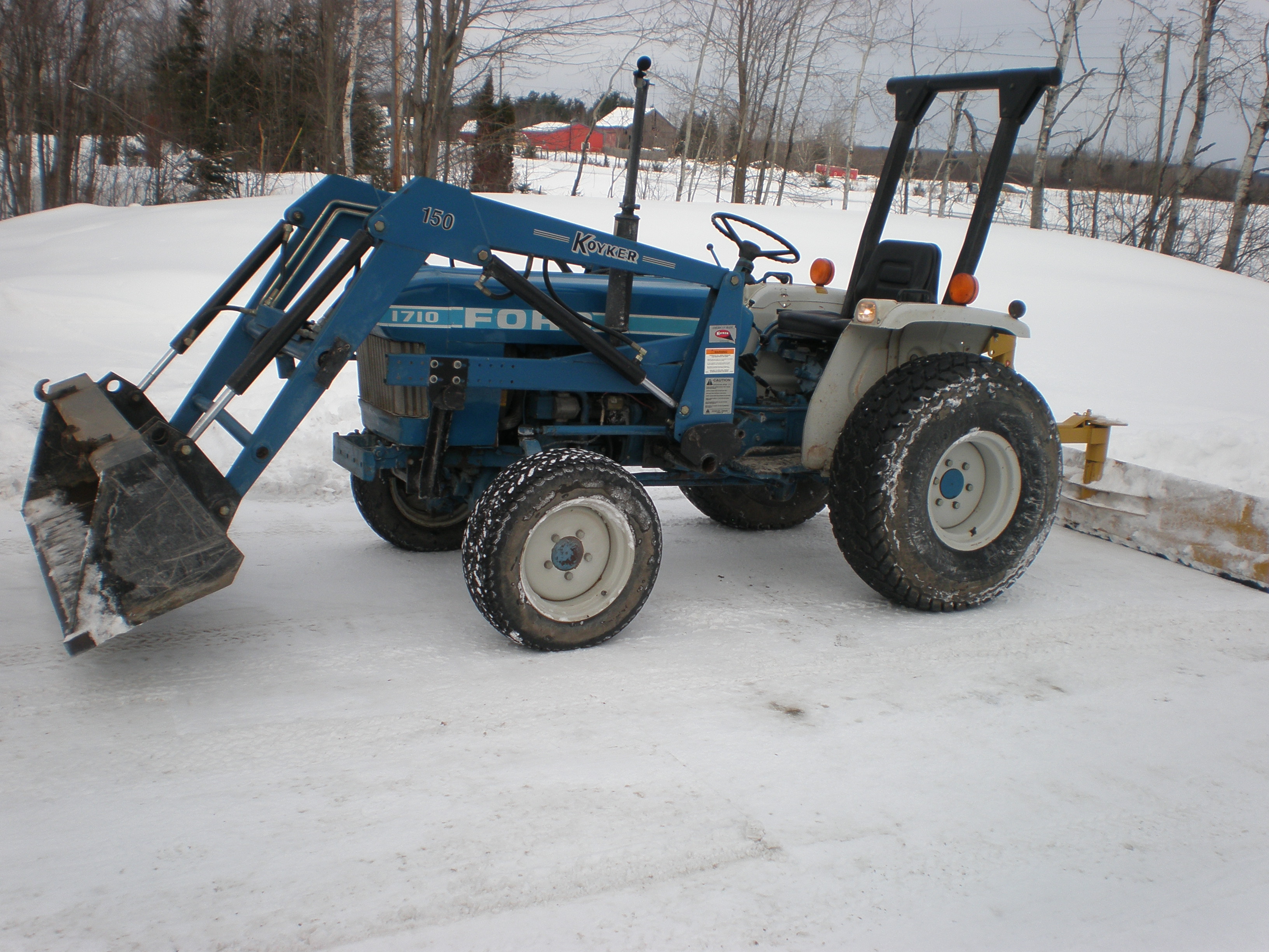

Ford 1710 4x4 FEL-back blade-KK box blade

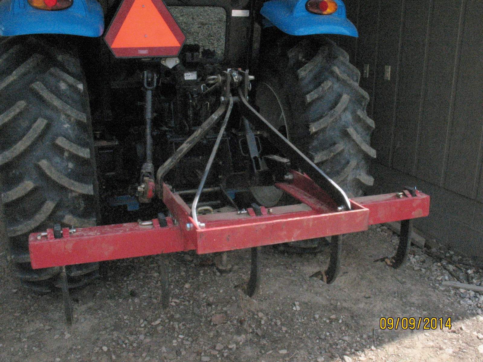

tractor 1.JPGHey All, I think a box blade w/teeth is best option for my summer project, here goes I have some ground I'am clearing and leveling behind garage-very in-level.
1. using a 1710 4x4 FEL-27HP
2.4ft or 5ft box ???
3 will I be stopped by root's if I only use 1 cutting tooth starting out ON ROOT"S ????
4. seem's like a 4ft box would be too light ????
***hoping to hear real user feedback-good-bad, sure I'm missing something, thanks for any input.....

Hey BigDog, I am using a King Kutter 5' Box Blade and it works great.
I would use all the teeth and just go slower. Every time I have hit roots it has busted them up and keeps on going. For larger roots you may have to go over it more than once.
   / need box blade option opinion's #3
Use a 5 ft. to be a little wider than tractor . Use all the rippers or at least 1 in the middle and one on each end . You want shanks mounted in a tube and not angle iron if you are dealing with roots . Better to stop the tractor than tear up the ripper mount .Spend the money and get a heavy built unit .

With only 20.4 drawbar HP, I doubt that you would damage any box blade nor the scarifier teeth. You just don't have the power or weight to put that much strain on it. I bought a Howse (now bankrupt) box blade in a medium weight when I bought my 45 HP Yanmar and never even bent a scarifier. I break one now and then when I use it on my 70HP tractor if I put it in 4 WD but in 2 WD it usually just slips the tires prior to breaking anything. It has the angle iron brace for the teeth and never damaged that piece, the teeth break first.
I think you will have no problem with your box blade. You may end up pulling thru with only one scarifier trying to cut thru roots if they are very big and then dropping the rest down to pull them out of the ground. If you have too many teeth in the ground you will just stall the tractor.
