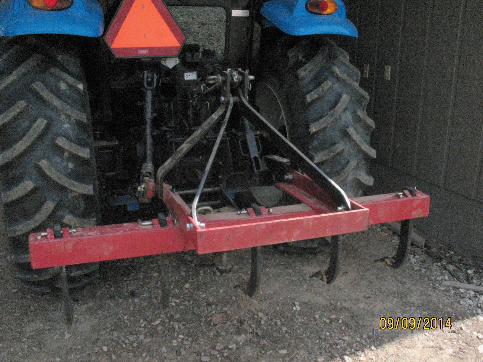

IMG_1643.jpgI have found this attachment to work best for digging out objects from underground. At my place these objects are medium to large clusters of rocks. With all 5 shanks down and pulling with the shank bar dragging the ground, it will stall my LS if I hit a big cluster of rocks. So far the shanks on this thing have held strong but not so lucky with the box blade. I sheared off several of them before I got this piece of equipment.

Gary thank's a bunch, well it's KK on the way, and your right with HP & Turf tires I'll prob start my first trial with middle 3 cutter's down, I don't have your clay issue, but I'm sure I have some good root's to deal with and a huge rock or boulder I'll have to figure out.
