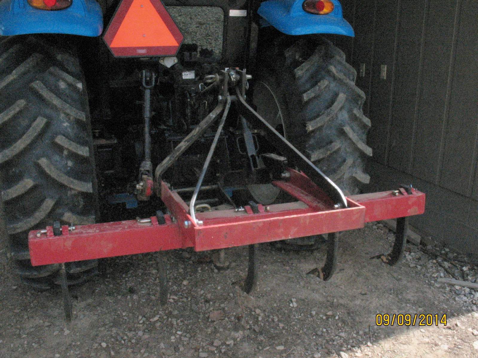

View attachment 500772I have found this attachment to work best for digging out objects from underground. At my place these objects are medium to large clusters of rocks. With all 5 shanks down and pulling with the shank bar dragging the ground, it will stall my LS if I hit a big cluster of rocks. So far the shanks on this thing have held strong but not so lucky with the box blade. I sheared off several of them before I got this piece of equipment.
What is this called?
