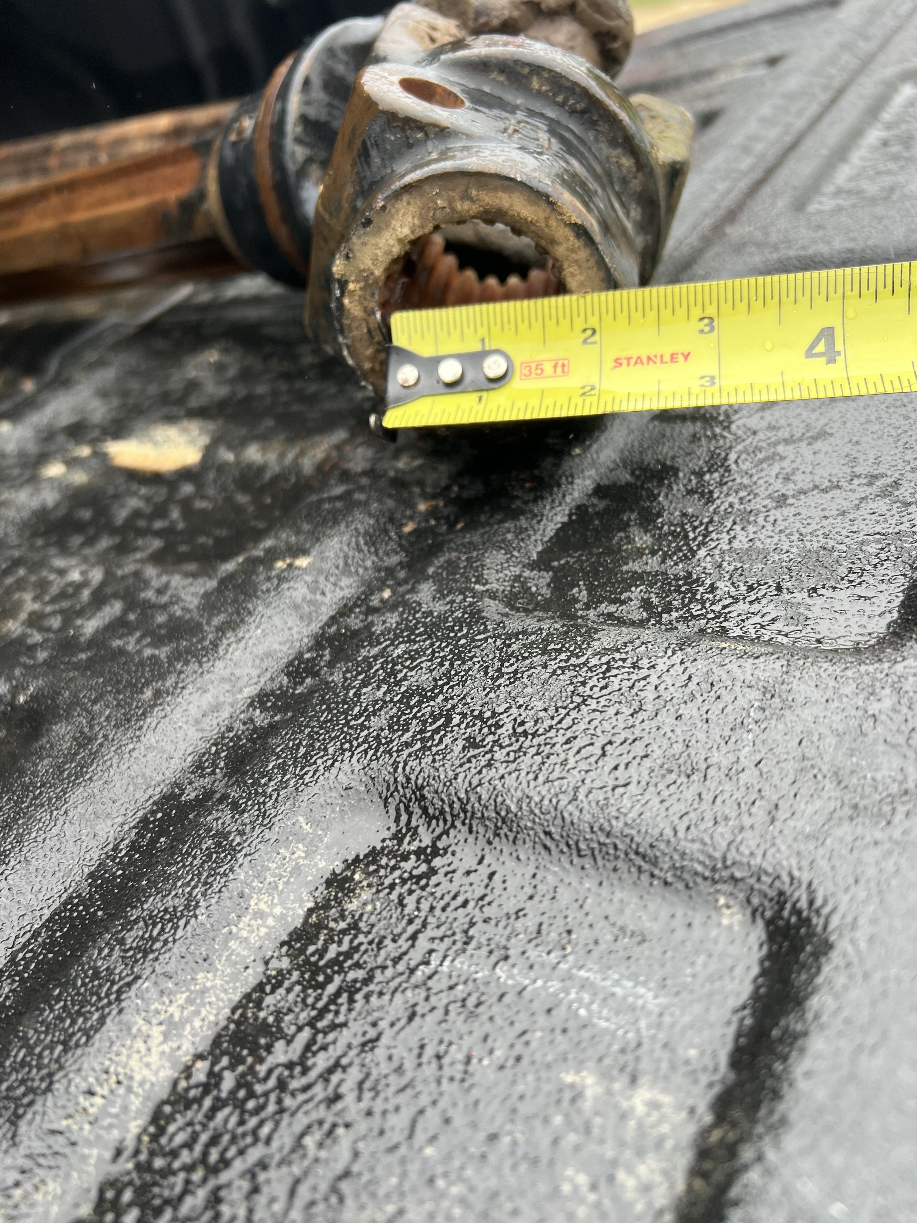

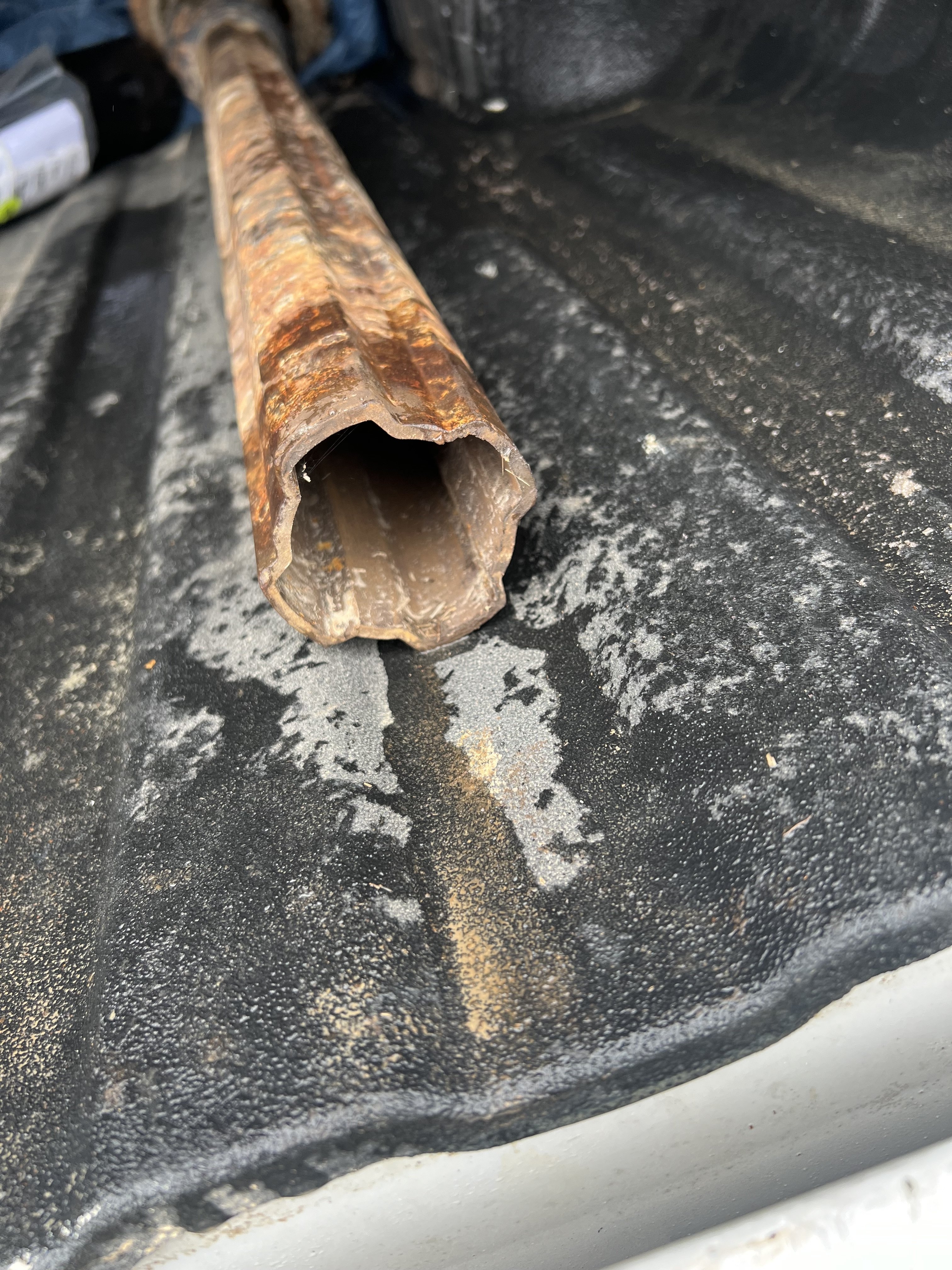

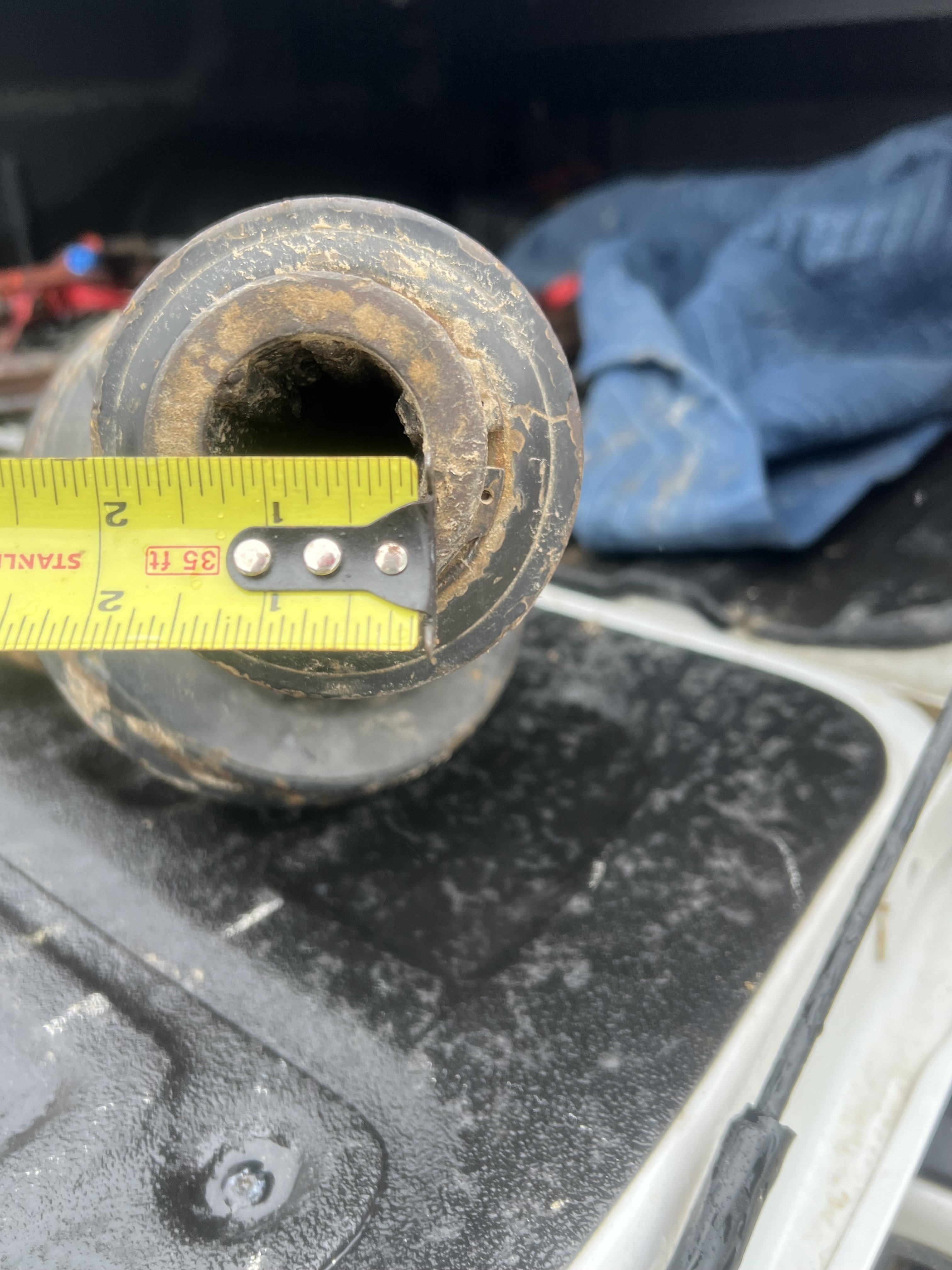

I have a Bush Hog 2515 that has a broken inner yoke and CV and need a replacement driveline for it. I tried ordering a female half shaft (tractor to male portion that connects to gearbox), but my current one is rectangular 4 spline in which everyone is saying they have never seen so it looks like I just need to buy a 6 spline 1-3/8 (tractor end) to 20 spline 1 - 3/4 (Bush Hog end) as a replacement. I see one on messick for $1,600 but it also has a replacement one for around $2,400. AgriSupply has one for $800, but I suspect there is a reason why it is 1/3-1/2 the price. Any feedback on where the best place to purchase is, please let me know. They want $3,200 locally and I am waiting on a machine shop to give me a quote, but can't get back in touch with them.

That is a Bondioli Pavesi SFT series shaft. Not all dealers are competent at identifying PTO shafts. If you see one pull out a tape measure to determine the cross and bearing RUN as they need to be using a caliper.
In the link below it will give you measurements that you can use to ID the series.
Once you know the series then you can use the link below to find the part numbers you need.
I know A&I is one of the largest distributors of Bondioli Pavesi in the USA. Every JD dealer is a A&I dealer so they can help you then. Weasler offers some replacement components as well and they are USA made. If you need more assistance reply with the measurements of the OD of the tube and cross and bearing dimensions (using a caliper to the thousandth) and I will see what I can do.
