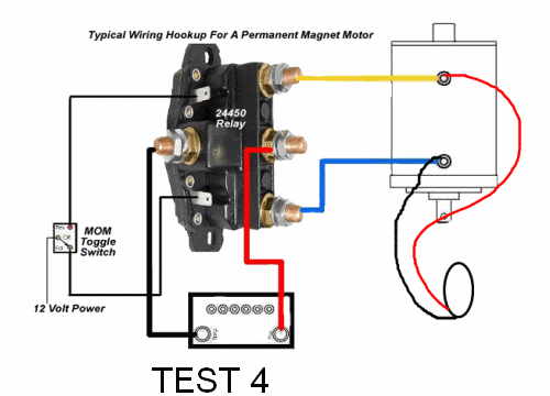

Hey Fellas, I have a 12K scissor lift dump trailer. loaded it up with some gravel, got it home and it wouldn't dump. I hit the rocker switch back and forth and all i heard was clicking. once in about every five times the "Down" position will work but I can not get it to "raise at all. As i said , all I hear is a click..
I think I should mention that I am a graduate of the local Amish electrical trade school, so I know next to nothing about electrical devices. But, since the solenoid is in fact clicking, wouldn't that indicate that it is getting current to the solenoid? Or, since the solenoid will allow the dump box to lower, it isn't the solenoid that is the problem??? any ideas?
Also i attached a pic of the exact solenoid on my trailer.

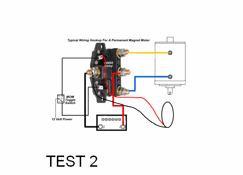

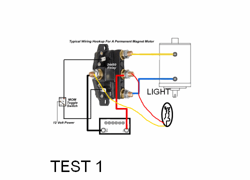

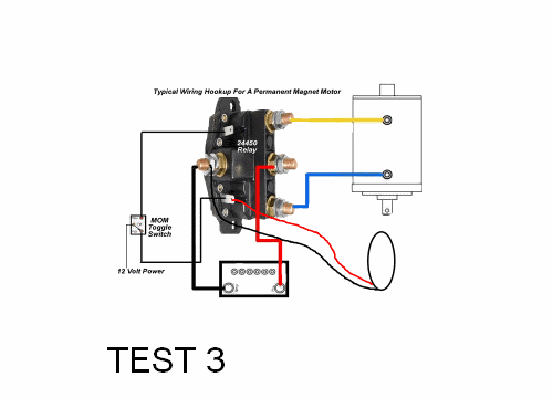

/ Need Dump Trailer electrical help. #9
Do you have a 12v test light?
Put it across the battery in terminals on the solenoid and it should light. TEST 1
Connect one end to the negative relay terminal (black)
Connect the other end on the a switch input terminal on the relay move switch both ways dose it light in only one position? TEST 2
Connect it to the other switch input terminal on the relay move switch both ways dose it light in only one position? TEST 3
Put it across the motor leads (note not to chassis ground) TEST 4
Toggle switch both ways and see if it lights up.
Yes then the motor is most likely the problem.

Thanks for all the advice fellas,
I tested it today and this is what I came up with. Using my original pic as a guide, I tested the posts that lead to the motor (yellow and blue in the pic) The down button read fine on the meter and the motor was working fine. When i tested to up button I got the usual clicking sound, no motor sound and the meter was reading a big fat zero..
So, I am assuming The solenoid it bad?? is this correct??

Yep, the motor runs in the down. Then when the UP button is pushed it just clicks and the click is in the solenoid. yep, the hydro fluid level is correct.
I tested the posts that the wire from the motor runs to. One had power and one didn't.
