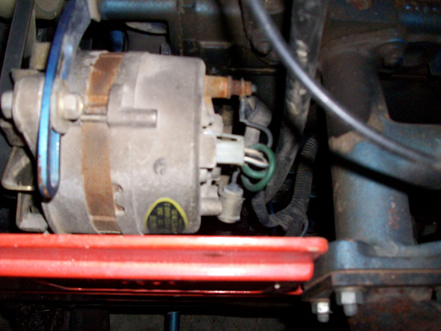

OK folks I finally got some (blurry) photos of the alternator and wires. The serial number is:
826500612. There is a white plug which is visible in the photos, it had two connectors in it, one in the upper right spot and the other in the lower left. The wire colors are; 1 black, 1 blue, 1 red, 1 white, and 1 black with a yellow stripe.
I've got a '98 LK3054. After reading your post I went and took a pic of my alternator. Yours look pretty much the same as mine. See the attached pic. It's not a real good pic, but if interested, I can point out colors and take better pictures.

Hillbilly,
It looks like your alternator only has two wires going to the connector, are there some unseen wires? Mine seems to have had five.

Looking at HB61's pic; seems there are at least two wires in the white plastic connector,and two more wires going to the battery post on the alternator. That leaves just one unaccounted for, and it very well may be hidden in the pic
