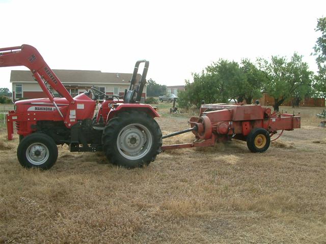

What is this pole coming from the thrower for? Our old 336 had hydraulic controls, I assume this is some sort of manual crank?
   / Need fleet of equipment for new operation #29
The pole adjusts the flow going to the kicker cylinder. More flow equals a longer harder kick. The controls you may remember are for the tilt of the pan, newer machines used electric motors to adjust distance and tilt.
#30
I see.....the setup we used to have had a set of controls clamped to the right fender with all the controls for that stuff and the the liquid application on the bales.
