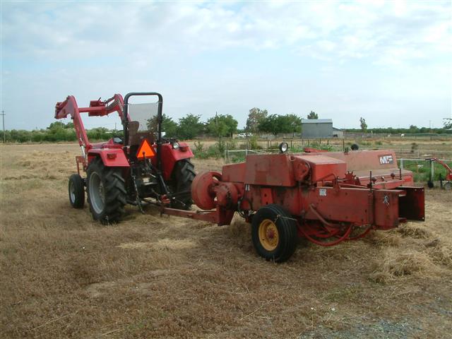

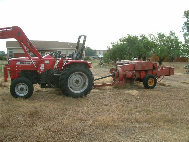

This Welger AP61 baler looks a lot like
Bell Tractors | New, used and reconditioned Massey Ferguson tractors, new and used Fendt tractors, used Ford, John Deere, Case and other tractors. Massey Ferguson spare parts and repair facilities. AP61
my MF-124. The packer arms are different, but otherwise the similarities are there.
